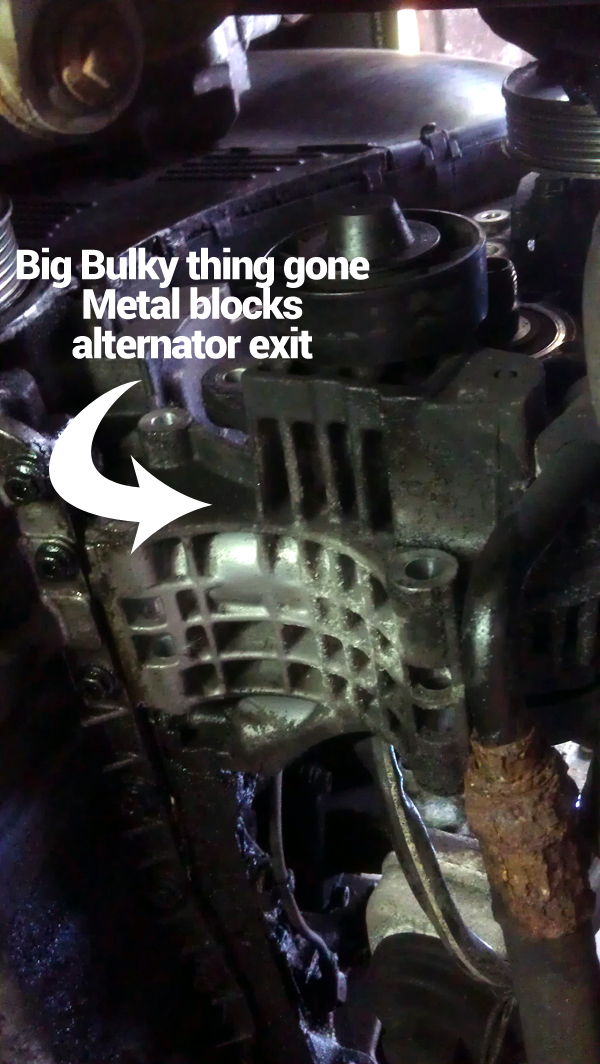

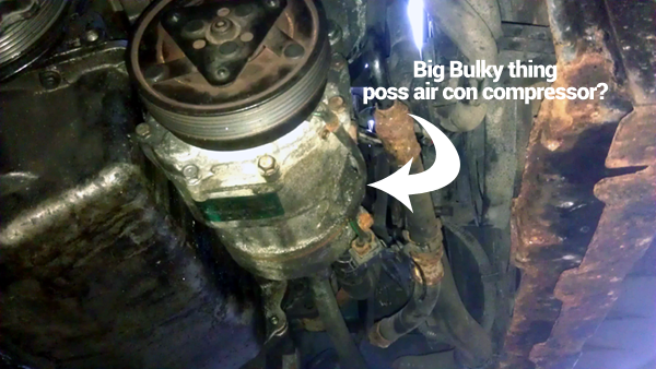

Anyway when I started to fit the new auxillary belt (thanks to Mr Haynes) I realised the alternator clutch pulley had gone and began trying to get the alternator out as I knew I would need to get it out to have a new clutch pully installed - or buy a new alternator.
So far I have managed to free the alternator from the mountings but have no idea how to get it out and sadly although I have been using Haynes I got a bit stumped at the bit where it says air con compressor.
I took off the bulky bit at the bottom that's connected to the air con but when I removed that there is a piece of metal between it and the alternator ... so I put that bulky bit back and started to look at a way through the top.  There is a wheel at the top which is part of the auxillary belt system and it seems if I took that off then I could riggle the alternator out.  However I don't know how to get that off either.
I have took some photos to point out what I mean by big bulky thing and wheel at the top.

The engine is an AGR with a/c and an assembly bracket that puts the power steering pump at the top.
You will need to remove the PAS pump, aux belt tensioner and IIRC, the RH fan to replace the alternator.
To remove the PAS pump, you will need to remove the PAS pump pulley. You should be able to counterhold the pulley with a 9mm hex.
If you didn't mark the direction of travel for the aux belt, you will need to replace it. Some of the bolts, may be difficult to remove, so get a can of PlusGas (dismantling fluid).
Water dripping from the crank pulley is bad news, as it almost certainly means that the waterpump is leaking over the cambelt :(

You are right I have had a look and found it is an AGR engine, which means the power steering pump is at the top and the Air Con Compressor at the bottom.
I will give everything you suggested a go I got to thinking after much looking that the power steering pump pulley has to come off.
