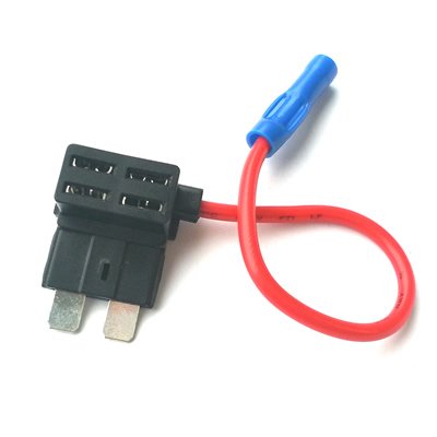

I guess you are thinking...
Camera - mini USB to USB:
USB to 12V in-car cigarette lighter plug:
Then 12V in-car plug into a 12V in-car socket:
!B654JTw!2k~$(KGrHqJ,!jYEzKPIsUkZBMypu(g
Then into the piggy back fuse holder, positive to 5A fuse box and negative to dash securing point:

This fuse location you've used, is it a blank or did this position already hold a fuse / serve a purpose?
I plan to use the same location and was just curious.
Is that a 25A (brown) and 5A (orange) fuse? Which one is the original and which one is piggy backed?
Checking the manual it appears to be position #43?
Superb%20Fuse%20Configuration_zpsfjtfpyd
Which looks to be 'Control unit for trailer detection'...
Edited by silver1011
I think from memory and looking at the photos i took on my phone when i was originally looking into the camera that i was going to use fuse 42.... The camera itself needs a 5a fuse and in my car anyway fuse 42 also has a 5a fuse in there already so the piggy back fuse will have 2x5a fuses in it in my install..... If i stick with that plan.
The problem with going for an empty position is that there may not be any connection to the battery at that position.... I can't remember whether i found any spare working positions in mine or not.... Although i think there would not have been with me deciding to use an existing used position etc....
Am I missing a fundamental point here in that why would you want a camera in your car? Perhaps firstly, to capture footage of an accident, secondly to capture the fizzog of some disillusioned idiot attempting to steal? Unless you live in the darkest depths of Birmingham or of that ilk I can't see the point... By all means enlighten
Dave got it in one: fuse 42, which is a 5A fuse. I chose it because it was the same rating I was going to use for the mobius circuit (and I couldn't figure out which of the slots in the piggy-back fuse related to which circuit), and because it was one of the non-safety component circuits - interior lights, rather than airbags and control units.
