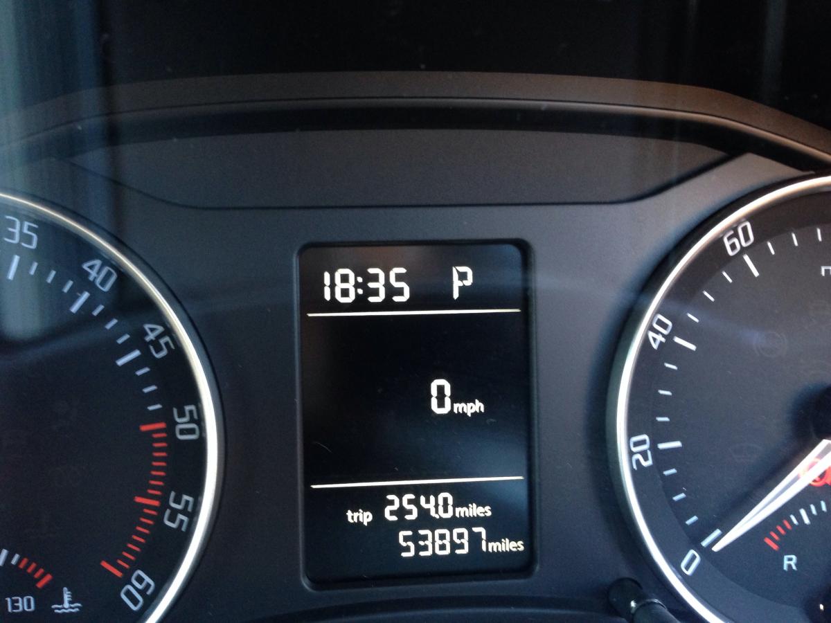

Met up with  M0bov (another Briskoda member) over the weekend who had the VCDS computer and he helped me re set the cars computer so that it gave me a digital MPH display.
It was a bit of a struggle at first as we couldn't initially get the MPH readout to appear on screen, perhaps because I don't have the multifunction steering wheel and neither of us could work out if my car actually has maxidot... we both seem to think it might not, and in the end I figured it out by complete accident.
The way I did it, I twisted the button on the digital trip computer to the right a number of times until the small km/h read out on the bottom flashes and when it flashes push it in and the total mileage of the car should appear. Then, push the button on the side of the right lever (the one which controls the wipers) a number of times and bingo, MPH will eventually appear.
It's very handy as the normal speedo is the one of the octavia's downfalls in the way they measure 5mph increments and only put a clear marking on 20, 40, 60mph, etc is beyond me.

Does it show you exactly which door is open when you open a door?
If yes you have Maxidot.
I have just tried this on my 2011 Octavia which does NOT have maxi-dot.
I can confirm changing the region to Australia then allows you to have the current speed displayed in the middle of the screen!
I didn't even know this was possible without maxi-dot! Thanks andy2286! :D

You simply change it back using the reset button on the cluster.
So can this be done without using VCDS, or does it need to be set to Australia on VCDS first and then changed the settings?
You need to set the region to Australia using VCDS first, else it doesn't give you the kph option on the service menu accessed by twisting the reset button.

I've found a possible issue with this modification, while changing the region to Australia allows a current MPH to be displayed digitally it messes up the MPG figures.
I have found a thread about this issue here with no clear resolution:
http://www.briskoda.net/forums/topic/295203-is-it-me-australia-change/
It would seem there is no way to correct the units as this is normally done via maxidot which I do not have.
To give an example my car was displaying 36 MPG for the current journey on the dash, clearly something was wrong as my car is a 1.6 TDI. Changing the region back to United Kingdom causes this to instantly change to 44 MPG.
I've had a look through VCDS trying to find a way of changing the units back after moving to Australia but haven't managed to find an option for it. :(
Confirmed on my MY12 VRS TDI. The change in MPG is concerning, no fix found yet.

Well after driving around for a couple of weeks, and actually thinking for once, there is no difference whatsoever in MPG.
I can't explain your differences that you were experiencing. Has it been resolved?
Sent from my iPad using Tapatalk HD
There is a difference as it instantly changes on the dash display when changed to Australia in front of your eyes.
There doesn't appear to be a fix for it either.
That's weird. There has been no difference for me, just as it should be.

any chance you would know (or anyone else) if it's possible to change the odometer from miles to km? I do have genuine vcds and done quite a few tweaks with it, but when trying to change to Europe/ Germany i do get message accepted, but nothing changes.
I do have FL octavia vrs tdi ,2012, without maxidot.

Any fix for the wrong mpg display yet?
FL 2011 octy non maxi dot, now showing digital Mph, but mpg is way Way wrong.
