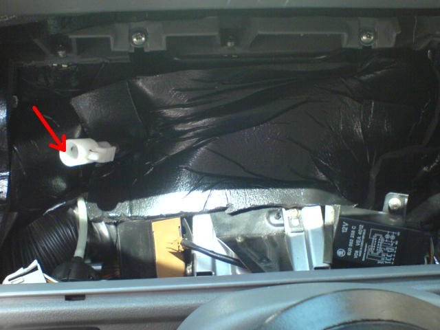

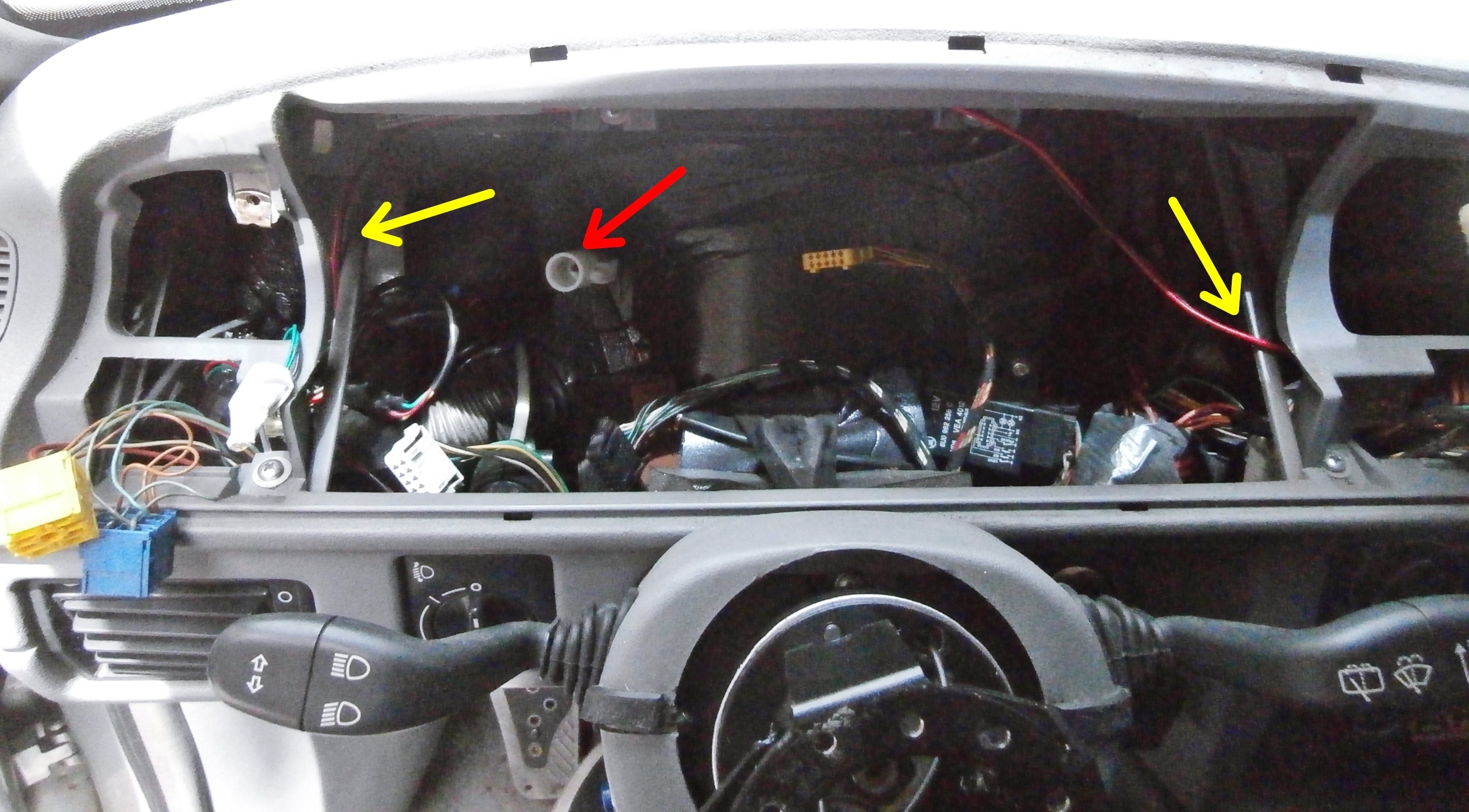

You have to remove the front panel of the dashboard but keep in mind to remove gently the white clip of the tachometer,let it fall back no need to worry
Put insulation inside if you can,pay attention so clips-connectors-cables etc don't touch any hard plastics because vibration + contact = noise.
Watch the yellow arrows,those cables (from the second alarm indicator) were touching the rods so every time i had vibrations from the road they were ''jumping up and down'' causing annoying noise
Took me long time to figure this out,every time i was in the national road i was slandering heavily from that noise.
Watch the red arrows, in the end or the wire put a tiny and thin layer piece of adhesive tape,when your front panel is ready to co back push that ''square end'' of the wire to fit tight on the hole of your speedometer,this will restrict the ''jumping up and down'' while is on the nest,he will just rotate without slackness.
Grab the white clip and fit it properly
Gently push back the whole panel (so the wire and the clip will stay in place) and start screwing.

I suggest first measuring the play in the Bowden cable-speedometer square socket ensemble. Use caliper, detail photos.
