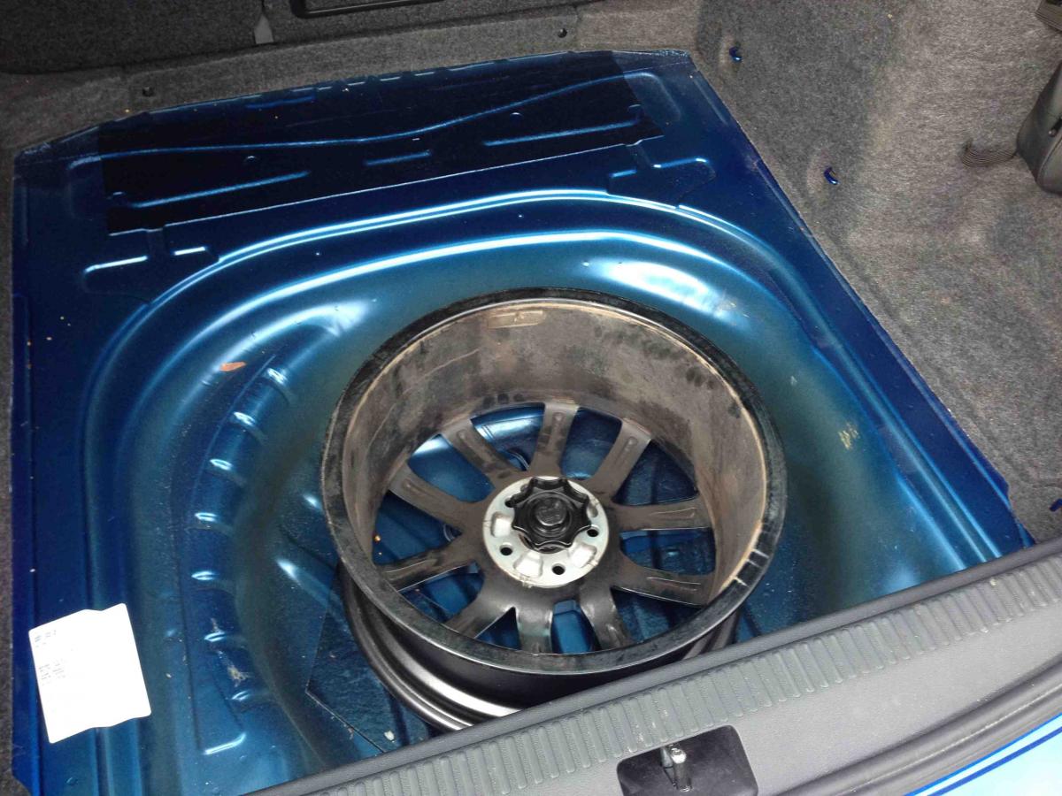

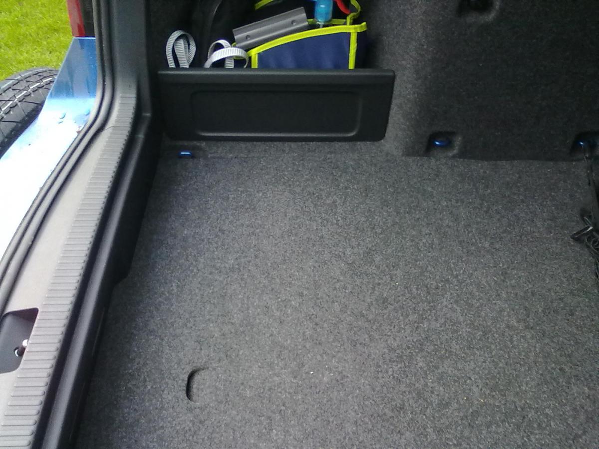

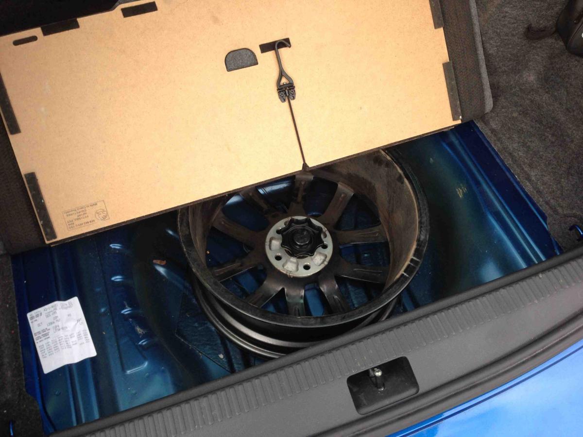

I pulled my spacesaver out of the wheel well in my vRS and fitted my spare gemini alloy in (bare wheel as it's left over from the lorry versus vRS incident).
It doesn't actually fit, there's plenty of space on the width which makes sense as the space saver is 125/75/r18 BUT there's just not enough depth.  I'd say it was about 5mm too shallow although you could add a couple of wooden or rubber strips to lift the wooden floor off the alloy.
Pics below
Alloy in well
Alloy in well with carpet
Carpet over alloy

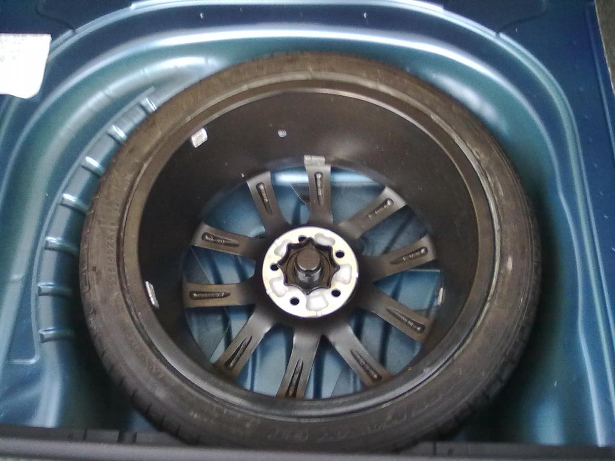

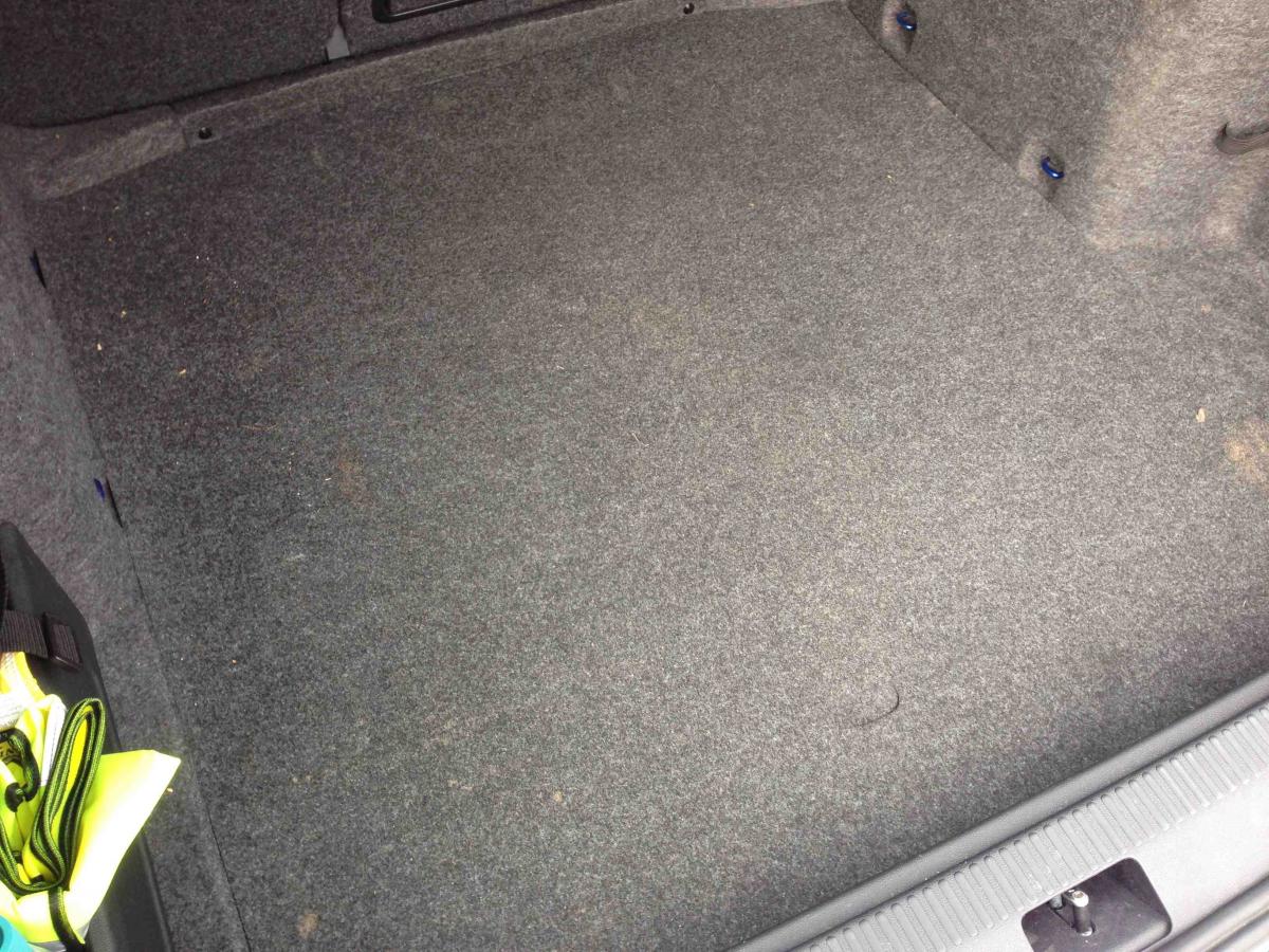

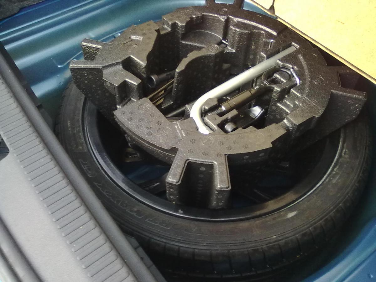

Hmm See http://www.briskoda.net/forums/topic/298692-vrs-space-saver-spare/page-2m and my two posts from months ago (39 & 42). No doubt in my mind the Gemini wheel AND tyre fits into the wheel well with floor fitting back down snugly all round. Only problem is to find a jack and rest of the kit to fit inside that wheel without forcing up the floor. As I said before, it would look like a kit in its hard foam container for a smaller wheel would do that job, or be capable of being cut down a bit to fit. Depth of wheel is all there; it's the diameter that needs reducing.from the vRS foam container you see in my pics.
"Spent a happy few minutes today taking one of my OE Gemini 18" alloy wheels with the usual 225/40 tyre and trying it in the vRS estate wheel well. The good news, as posted before, is that it fits fine and boot floor flap closes, though the flap does rest directly on the tyre sidewall with no margin. The slightly bad news is that the jack kit in its hard foam packaging won't drop down into the well of this wheel but sits on top of the rim (just as it does on the space saver). So if the well contained a full sized wheel I would have to put the jack kit into the boot . For anyone contemplating a permanent full size spare, it should be possible to trim down the foam and make it fit inside the wheel rather than sit on the rim. Pics show the Gemini in place, the boot floor then fully closed, and the way the jack kit sits on top of the wheel rim.
