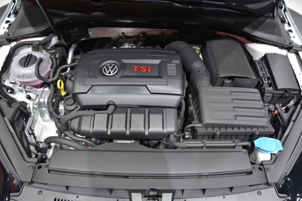

Can someone tell me where the oil filter is on the engine?

Appreciate the pic is of a Mk7 Golf but it was a decent photo! So Is it the plastic hex nut to the bottom right of the dipstick?
That's the filter housing from the looks of it
The filter would be internal to that housing. The housing obviously doesn't get changed. :)
The filter is a cartridge type similar to a cylindrical air filter so from the outside you won't be able to tell if it's been change or not.
OK, thanks for the info. I have put a mark on the top of the plastic housing lining up with another part of the engine using a razor blade! They still line up and as you can imagine its a very thin line, so to have taken it off and put it back on in the sane position would be very unlikely. Even knowing where the line is I can only just see it.

A good idea marking the housing. You could always spin it off and see if the filter is new ie light brown paper element instead of dark although it could make a bit of a mess and I've no idea how dirty an old filter would be on a car this new.
Another thing would be check the but that's formed into the cap for tool marks. I'd imagine the socket or tool used to remove it would leave some kind of mark?

I'd imagine the factory fit the cap to torque spec stamped on it but have never seen a mechanic use a torque wrench when re-tightening them (neither have I myself).
You could always unscrew it and let the oil drain away, pull it off with a rubber glove and look at the date stamp on it.

If I understand correctly how you've marked the housing then I don't think you can positively say they haven't unscrewed it.
I would say it is very likely that when tightened up it would stop in the same place as far as you can judge by eye.
The lines are the width of a razor blade, even with a torque wrench it would be virtually impossible to get them exact! There are no marks on the plastic nut and there is no evidence of there being any oil spilt at all. The bits of dust are still around the housing.

If they take it off and put it back on it will arrive in the same spot.  It's a single start thread so you will always finish in the same position.
I've had so many arguments with numpty customers over the years that have marked the housing of their cartridge type filter system or the drain plug and expect it to tighten-up to a different spot.
I will also admit that back in the old days when i was a bit cheeky, if I noticed the customer had made a mark on a  spin on filter, I would try and replicate the mark on the new filter, just to wind them up a bit.  Lets face it, basically they are assuming you are dishonest & a cheat.  Nobody likes being called a cheat.
The oil won't spill on the TSI, theyve built a drain-back into the system.  You unscrew the filter about 1-2 turns & wait 2 minutes for it to drain, lift the filter straight up & hold a rag under it.  The block will be clean.  Retighten to 22Nm.
