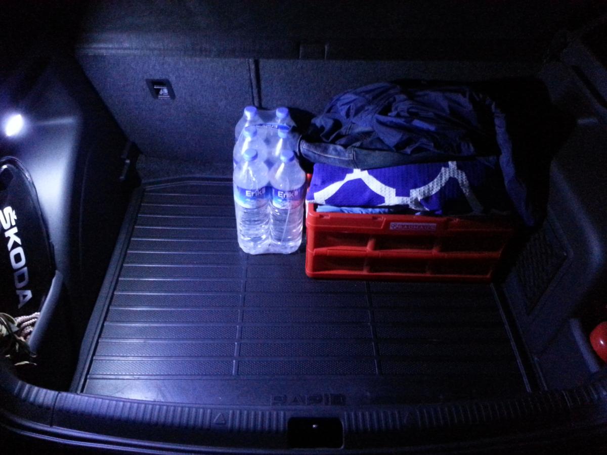

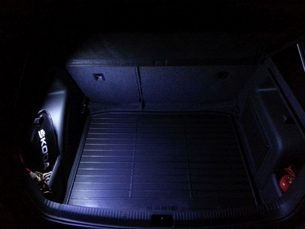

But the luggage light was very low lighted. So I bought a led light for the luggage and put it on the orriginal light.
Now it is much better.post-120754-0-36905900-1409948055_thumb.

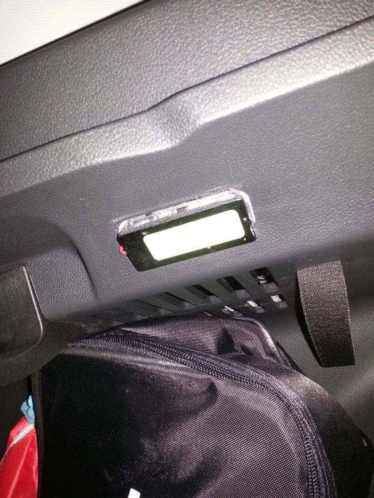

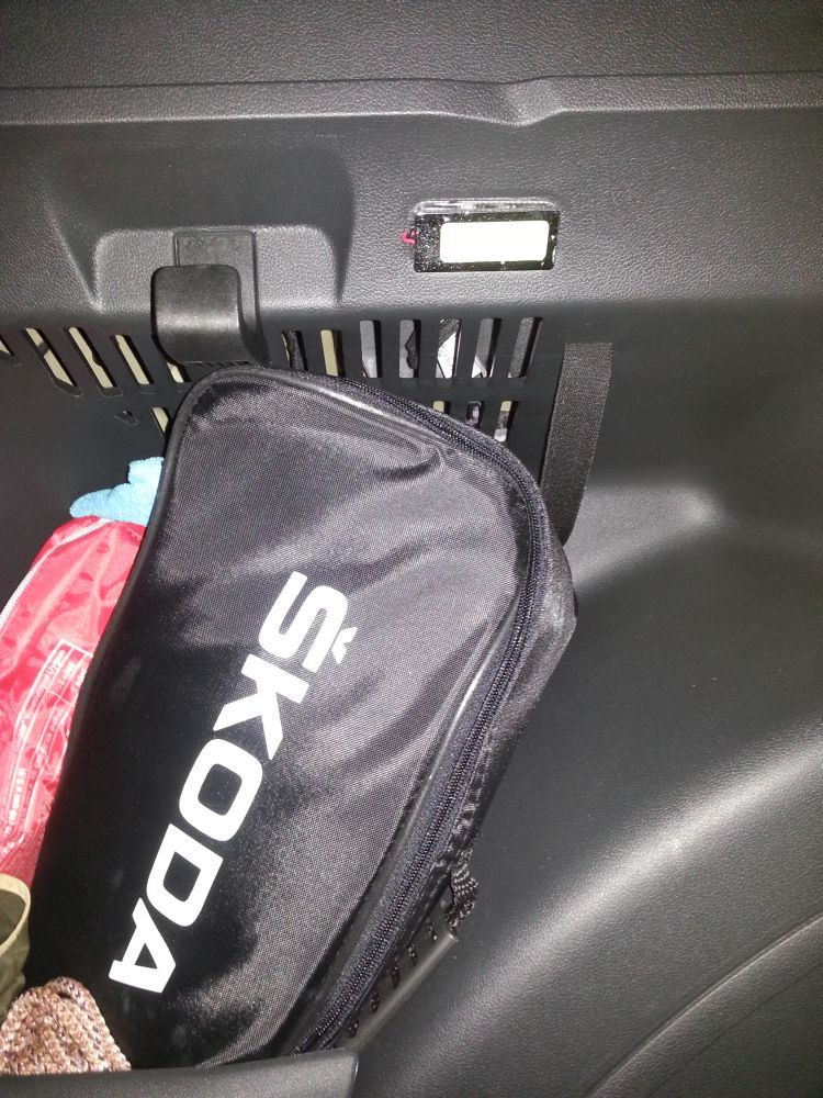

It´s a led panel light. As big as the orriginal boot light of my spaceback.
You have to take the orriginal light bulb out, and put the led bulb in place of the orriginal.
After that you can stick the led on it and put the box back in its place.
It´s actually much brighter than it looks like on the pictures.
