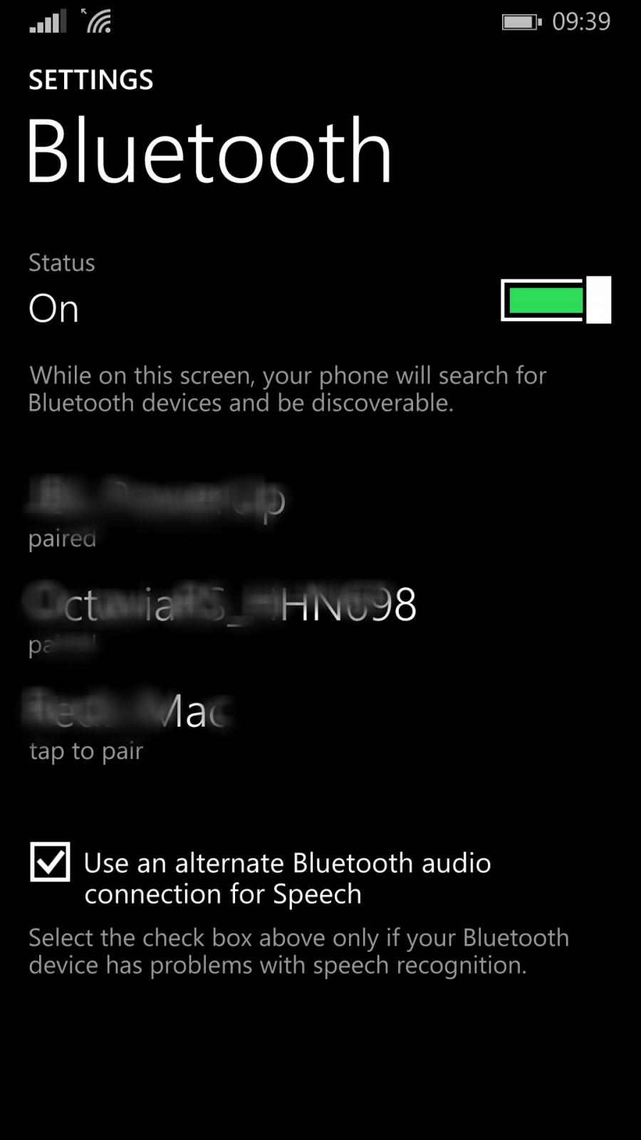

On your windows phone, go to settings, Bluetooth settings, click advanced and then tick the box for "Use an alternate Blluetooth audio connection for Speech"
You're a star, now works perfectly. I can put the Garmin back in the draw.
I can actually listen to the radio and it will automatically silence the broadcast whilst the satnav directions are playing.
