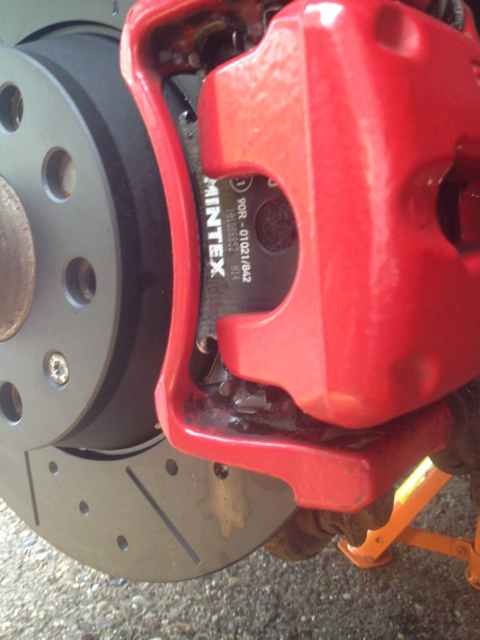

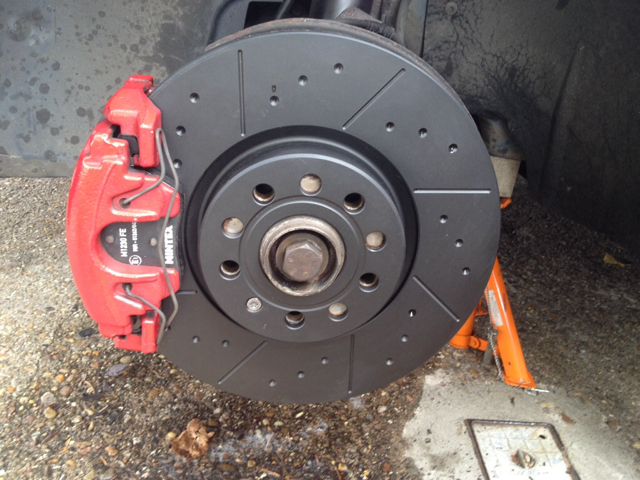

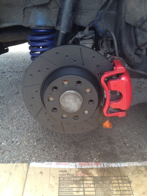

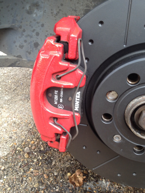

Done some research and ordered some new discs and pads... £205 all in. Will update once fitted!
Been out for a drive today to skim the finish off the discs. Can hear like a whooshing noise when applying brakes... Guess that's the grooves. Feel good already and no where near bedded in! Will pop some more pics up soon.
Yes, its the grooves (and the reason I stay away from them. Drilled disks can also be prone to cracking). What pads did you go for - cant make them out on the phone but guessing Mintex 1144's from what I can see? :)
Will the discs stay black is It like anodising or will the silver and rust come through?
Yeah Mintex 1144's. The discs are dimpled not drilled. Decided drilled sounded like too much hassle.
The noise is really minimal. Can only hear at low speeds with window down.
The disc surface that comes into contact with the pads has worn off leaving the standard silvery finish. The finish protects the disc from rust.
Good all round pads imo. Yup, I can see the dimples - I just don't touch either grooved or drilled - the grooved ones generally get louder the faster you are going ie they are rotating quicker. If I was going to spend a lot of time on track id consider making the compromise... possibly. Hope they perform as expected when bedded in fully. :)
The dimples are just cosmetic to give the appearance of drilled discs without the practical channeling of heat into the Vent Gap. they will just get filled up with deposits after a bit they just reduce the surface area incontact with the pad so in effect useless imo. The grooves will help with temps but as already identified will cause unwanted noise.
