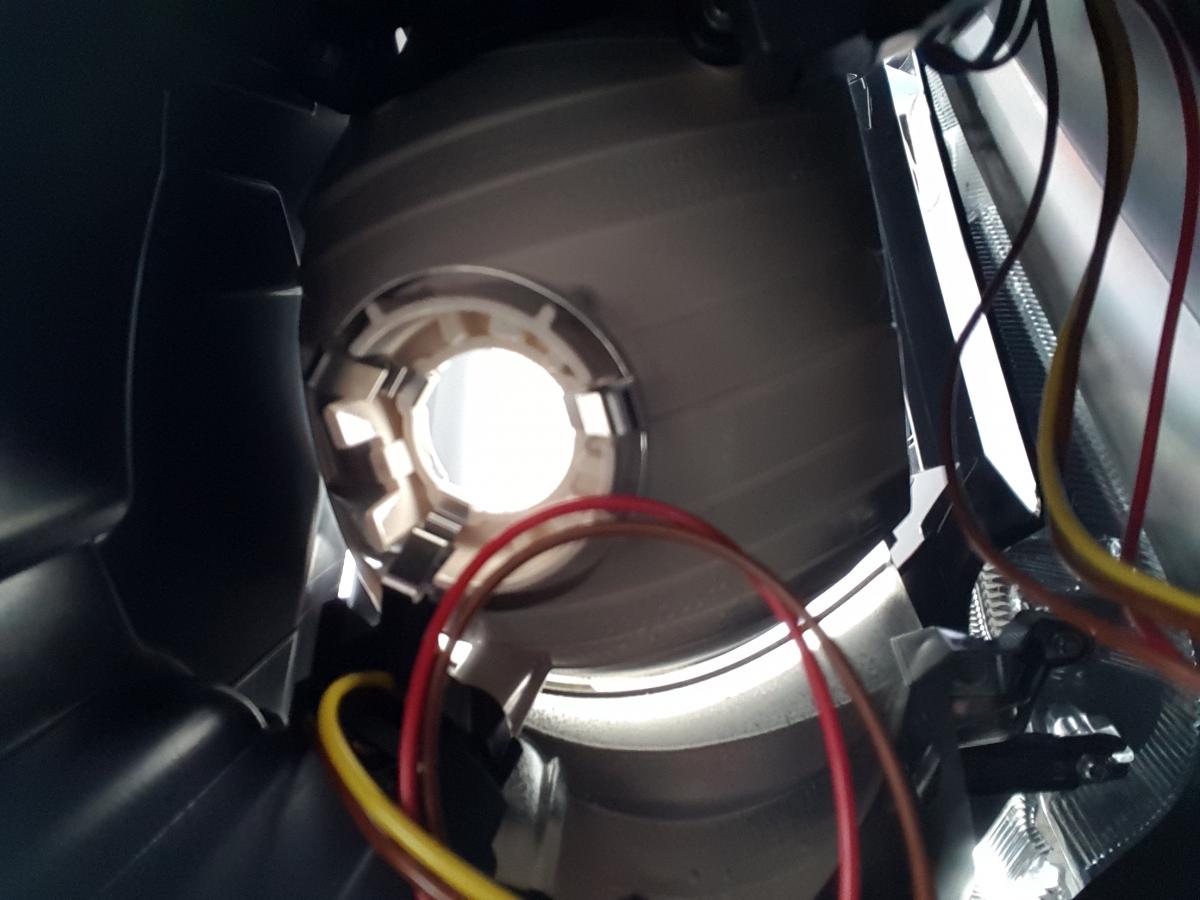

Had look at the headlight units this morning so I knew what was involved in swapping bulbs, my car is a MY2015. The manual is different to the link shown in Ash7's post above but gives the same information. If your standing in front of the car and working on the left light unit and want to access the H15 Main and DRL bulb it goes something like this:
Remove the inner large circular plastic cover by twisting the top of the vertically moulded ridge to the right about 25mm and the cover comes away. The next bit is the part that confused me looking at the manual. Using a mirror and torch I could see the connector sitting on top of the rear of the bulb housing, the manual seemed to give the impression to remove the connector, in my manual the arrow pointed down but I found I needed to slightly lift the connector up, do not try to lift it out the way upwards, it won't go! After lifting the connector slightly  the bulb holder (the orange coloured moulding) can be rotated again to the right and pulled backward leaving the connector attached to the headlight housing and the bulb and moulding in your fingers.
The dipped bulb is much easier.
So was the dipped headlight like it said in the manual?
The way I understood it to be was: You pull down on the light+connector to release then pull out. remove and then pull off the connector. Connect to the new light and then is it just a case of pushing the new light in (flat, tab side up). There aren't any clips or tabs to close?
The part I don't understand from the manual is the second to last instruction: Remove the hook in the direction of arrow 3.
Its the same but my manual shows the fig 225 not 244. I didn't understand the reference to the hook either, if you look into the housing (A small mirror is useful) you will just about see a square black moulding sitting on top of the 3 contacts, this is the part you need to carefully lift up on one side, this moulding traps said contacts in place, once it is lifted up it releases the contacts enough to allow the bulb holder (The moulding with the orange part) to be rotated to the right thereby allowing the holder and bulb to be withdrawn from its bayonet fitting in the rear of the headlight itself.
The above standing in front of the car looking to the rear, the only tricky bit is lifting the moulding, its high up in the headlight and not much room for fingers, I used a flat ended screwdriver to gently lever the right side of the clip up about 4mm which was enough to allow the contacts on the connector to be rotated. Hope this makes sense!!! THe moulding is NOT removed from the headlight, you just need to put the bulb & Holder back in place, rotate to the left and push the moulding back down to lock it all in place.

Think there's probably been a bit of confusion, but I want to change the H7 dipped beam (image 244) and not the main beam H15 bulb which has the three prongs. I've changed the bulbs and seemed fine, but I'm worried about the light pattern. Difficult to see in attached photo but doesn't look right.

I had a similar problem when I changed mine, its best to check against a wall then its really clear if the alignment is wrong as the beam pattern is all blurred. its only that you haven't got the bulbs seated quite right so id suggest starting again sorry. they are quite awkward to get right but once you have them in correctly its painfully obvious from the beam patterns and how the main and dip line up
