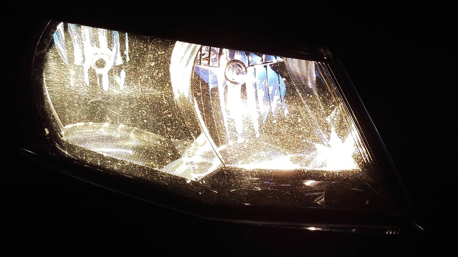

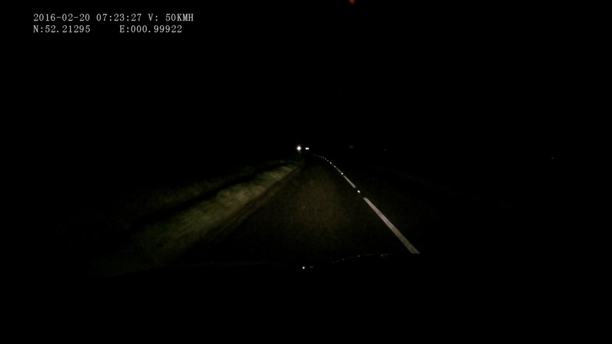

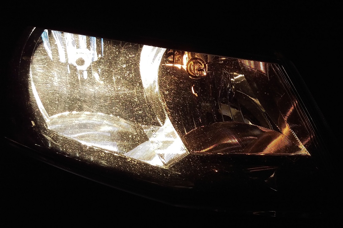

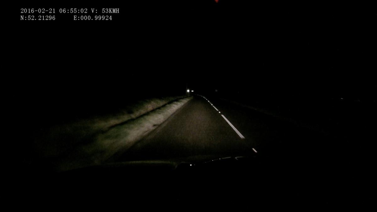

After a long while of thinking about it. I've got round to putting H7 Osram night breakers and H15 Osram cool blue intense in.
I've attached some grabs from my dashcam with full beam on, and took a couple of shots of the headlights on the same piece of road, showing how much better they light up the road, and the next set of signs
I've also taken photos of the bulbs. The sidelight is still very yellow, and there is a very obvious blue tint when the full beam is on.

You can get rid of the yellowing on the sidelights by adjusting their bight Ness but, you need a VCDS to make this alteration, mine run at about 55% which is just right for the MTEC MT-489a 's I have in mine slightly, over the limits at 4,350k but, WTF
Regards
T
