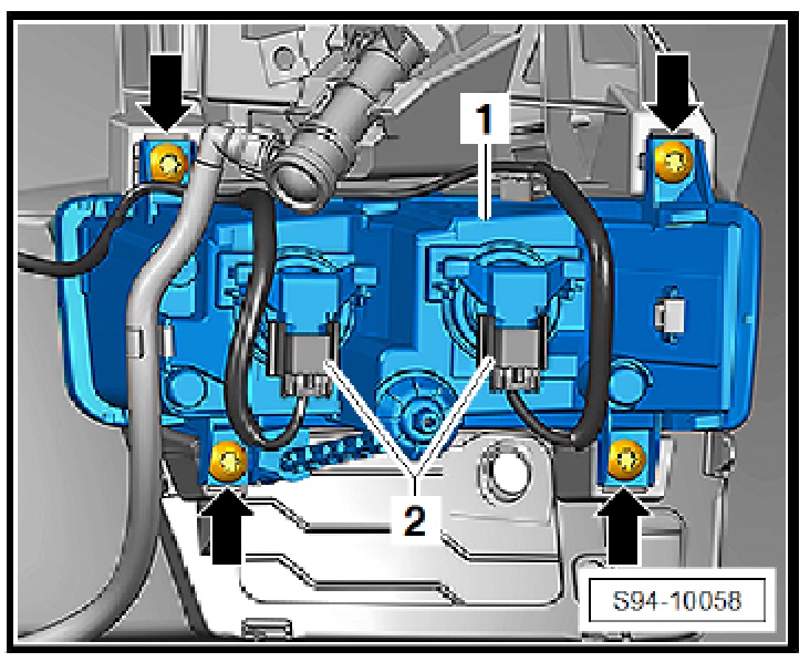

5.2 Removing and installing fog light
Remove (except for Octavia RS)
– For example, insert a hook into the opening in the grid
top arrow- in order to remove the wheel trim cap (tool kit) and
unclip the grid
-1-
from the catches in sequence and take out.
– Unscrew screws -1- (1.5 Nm).
Caution
When using the lever tool, mask points where the lever tool is
applied using commercially available adhesive tape.

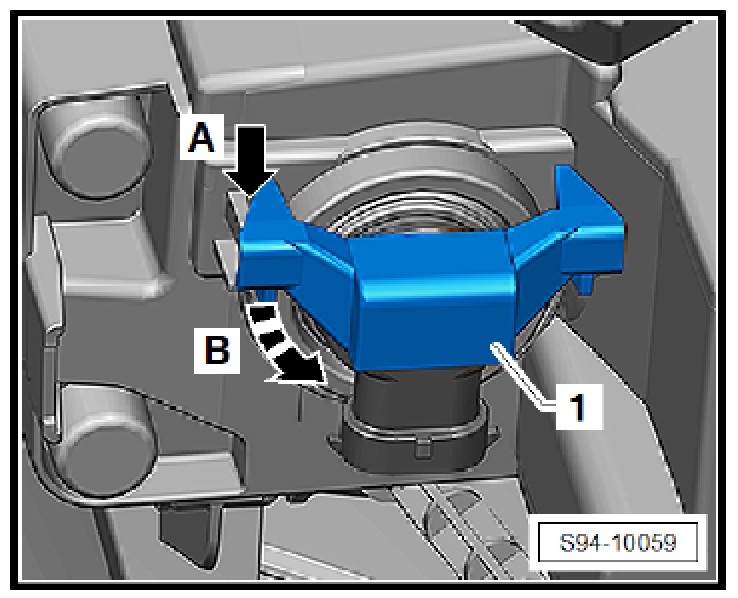

Loosen the catch
arrow A- with a screwdriver and remove the
headlight -arrow B-.
– Disconnect plug.
Remove - Octavia RS
Remove headlight left - front bumper ⇒ Body Work; Rep. gr.
63 .
Remove headlight right - vehicles with auxiliary heating - front
bumper ⇒ Body Work; Rep. gr. 63 , without auxiliary heating
- remove front right wheelhouse liner ⇒ Body Work; Rep. gr.
66 .
– Release screws -arrows-.
– Disconnect connectors -2- and remove headlamp -1-.
Install
Installation is carried out in the reverse order.

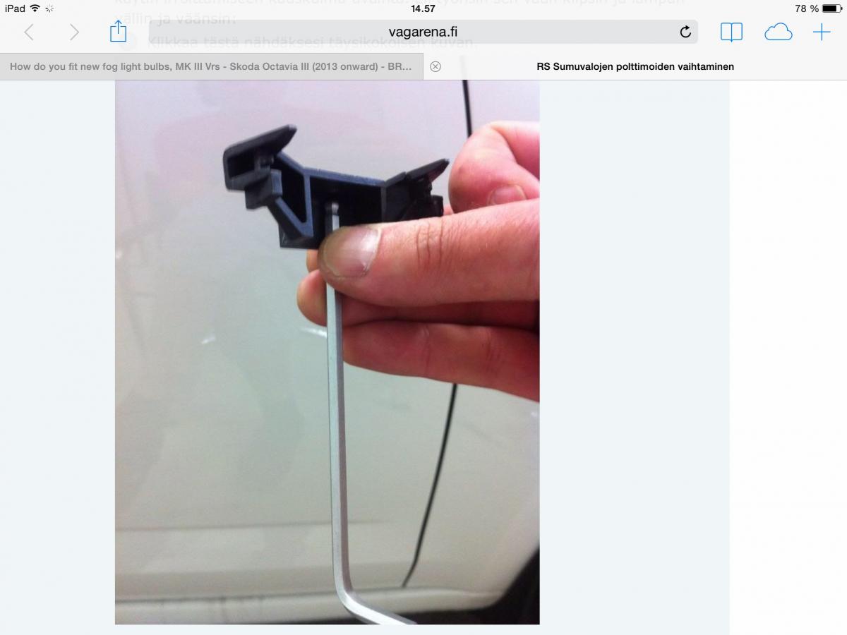

An alternative method to change the fog light bulbs on a vRS.
cheers I will watch that one.

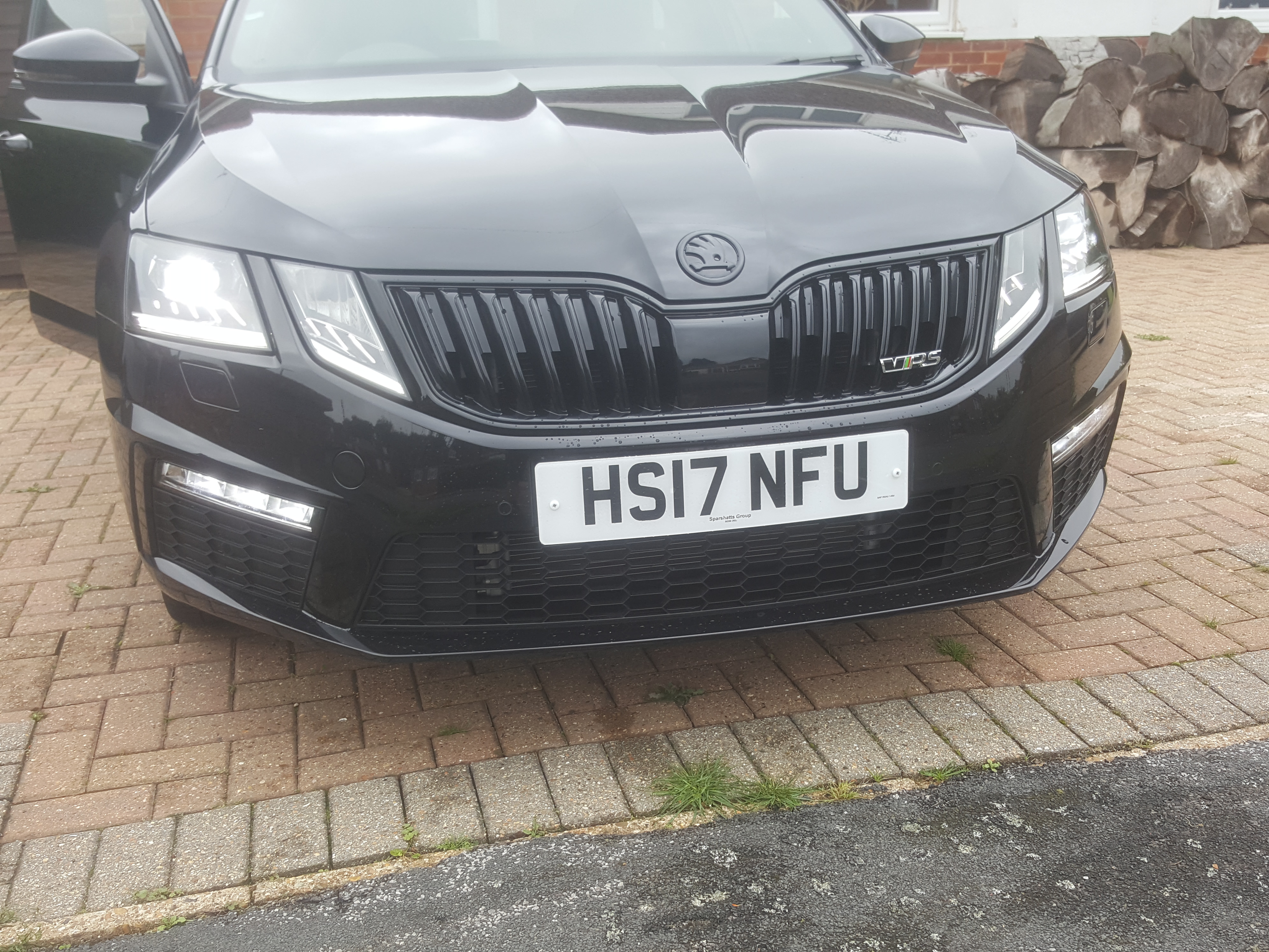

I feel short changed, my fogs don't seem to have bulbs !!!!!20170925_114543.thumb.jpg.8d08a6111b0693bebcba0076f5f98028.jpg
They look awesome! First pic I've seen of the new LED fogs! :cool:
Yeah I like them, we had some mist a few mornings back & they seem to work well too
