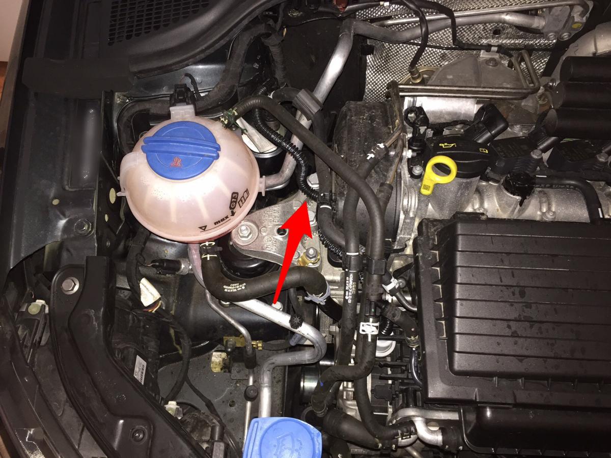

Hey guys,
I got the charcoal canister hose replaced the other day and the beeping / high pitched noise is now finally gone (i.e. OP's problem no. 1 above)! The original hose was ribbed (and plastic, I believe), while the new one smooth and made of rubber. The mechanic took the old hose into his hand and blew through it -- and you could hear it produce a loud noise, while blowing through the new hose does not produce any sound (only a slight hush of the air).
Many thanks to the users @kristianRS and @kimmu for the heads-up on this.
A picture of this canister hose will be very useful, cause is hard to convince the dealers about a thing that can passe unobserved. Thnaks.
Here it is:
Ok...Thanks. I have it too.
This sort of pipe it is really the type that whistle when you blow in it. This xplains the sound. But at the end of it, on the engine side, it looks like it ends with a sensor... What should be on it, fuel or air?
Sorry, all I know they replaced the hose and that's it. :-/
