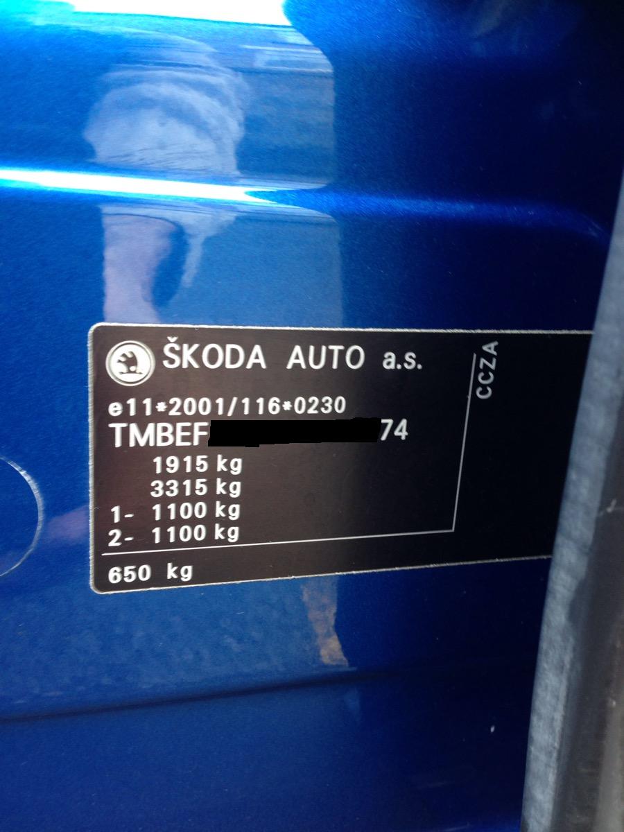

How do you tell what build week your car is?
the build plate on the b-pillar.......
No build date on mine
Nor mine..
