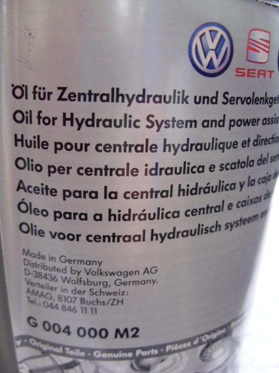

Battery was new last year and was a good one with 5 years warranty. I will check the power steering hydraulic fluid level later. BTW, what fluid is used in the pump? Is it the same as brake fluid?
As above: attached photo what I bought at dealers..
