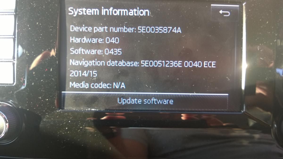

This is my current firmware version for my Amundsen.post-123487-0-90105700-1415725710_thumb.jpg
It can't download logos OTA for FM stations, there isn't a suitable data carrier?
So, the logos are somehow pre loaded and then matched to the stations by name and or frequency or some other unique identifier
