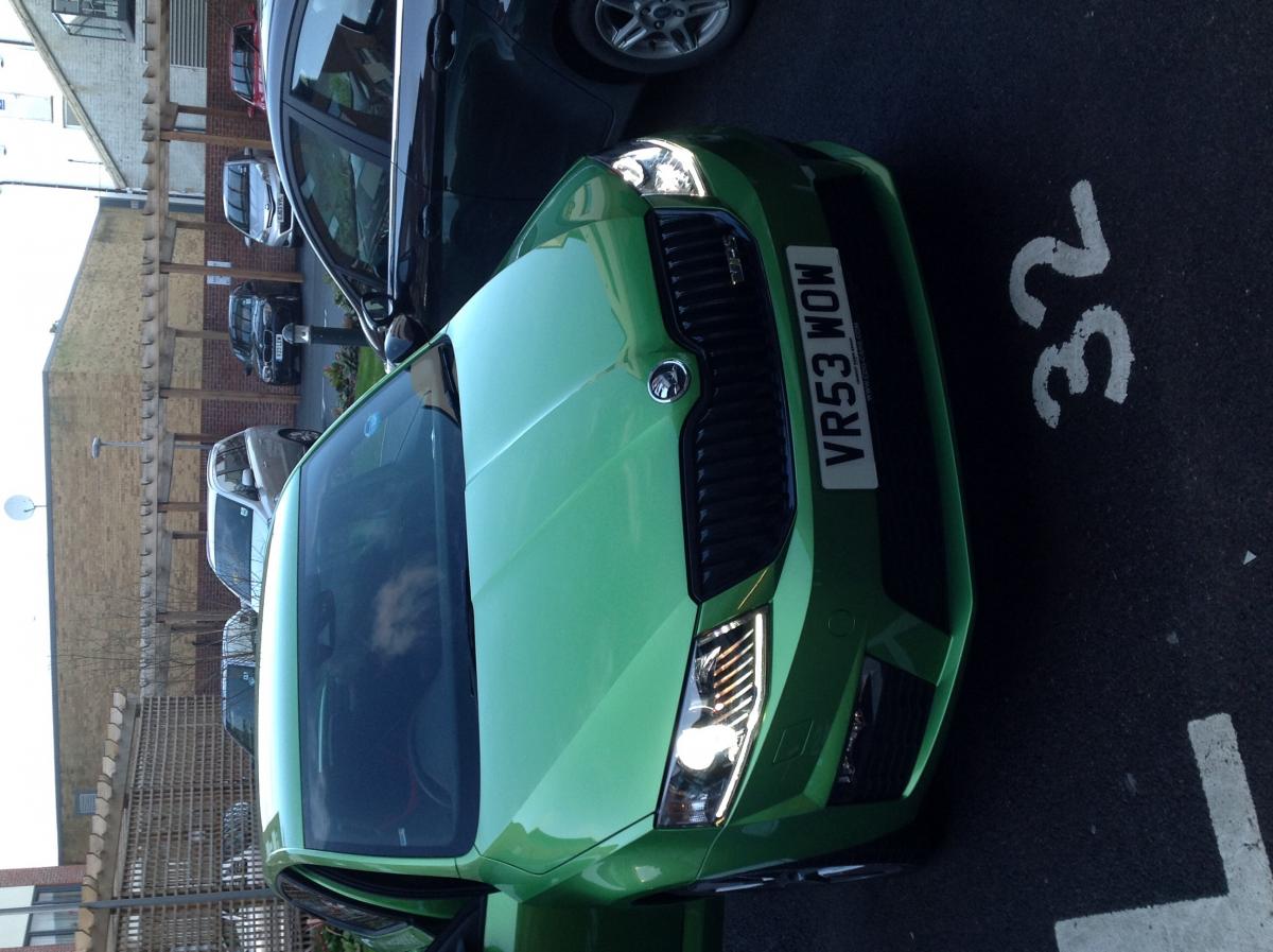

Judging by the picture all the acid has drained from the battery   :notme:
sorry couldn't resist, hope you get it sorted and love the plate
