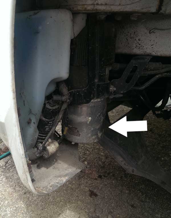

Can anyone tell me what the unit to the right of the reservoir is please? The silver lower part on mine (2001 1.4) was encased with foam and plastic - the plastic had perished and broken and the foam was sodden so I've removed the claggy mess. Pic attached. I am searching for the mysterious rear washer water - it seems to be going somewhere....just not to the rear window.

Power steering pump. It's better off without that foam, so don't feel the need to replace it with anything.
