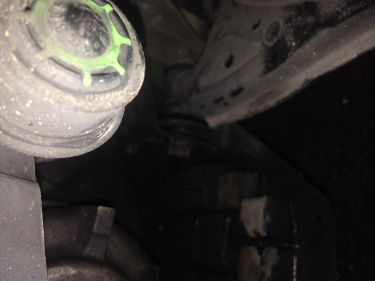

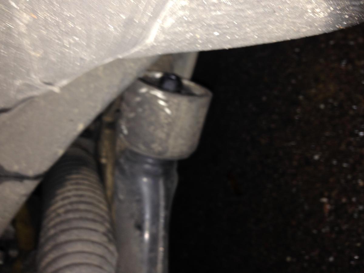

this bolt in picture, sorry is a bit dark
did not attatch file lol
its not this one
ok messaged the guy on ebay about that part, asked if it would my 2003 fabia vrs and he replied 'no'
had a look around on net and can't see anything, anyone help?
The items that steveopc posted in the link are the items you need. The thread inside the alloy strips, it's very common.
Stann. The bolt goes right through from the front bush to the console at the rear of the arm. It's a long bolt which only threads in at the back :)
Those consoles will sort you out.
