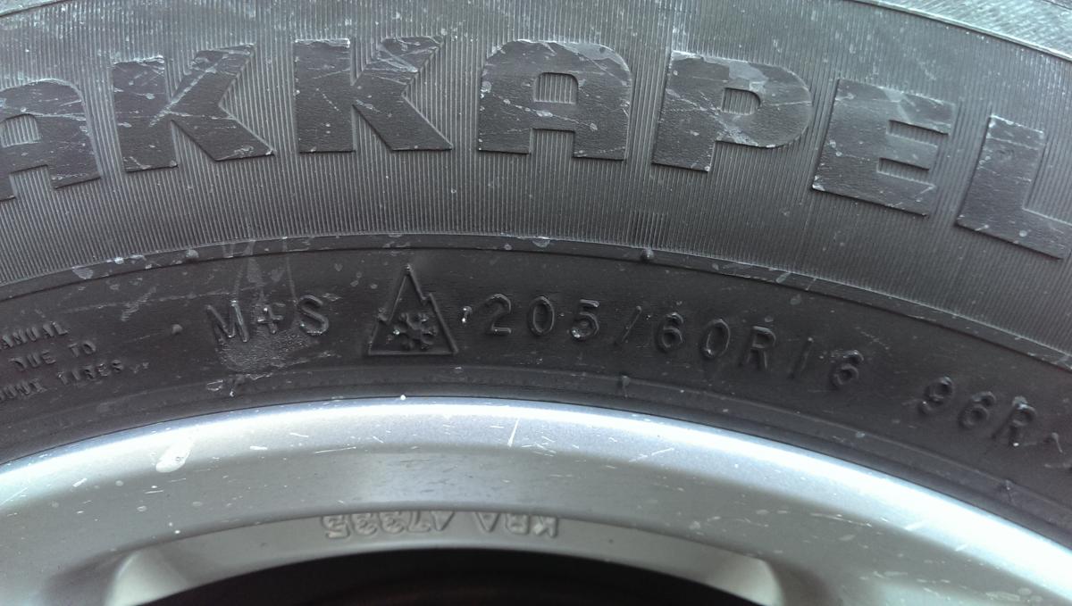

I have a Scout on order. Here in Norway the dealer sorts out winter wheels or recommends size if you choose to get them from somewhere else. My current Scout and future one has/will have 205/60 R16 tyres.post-83132-0-14860800-1416049977_thumb.jpg
