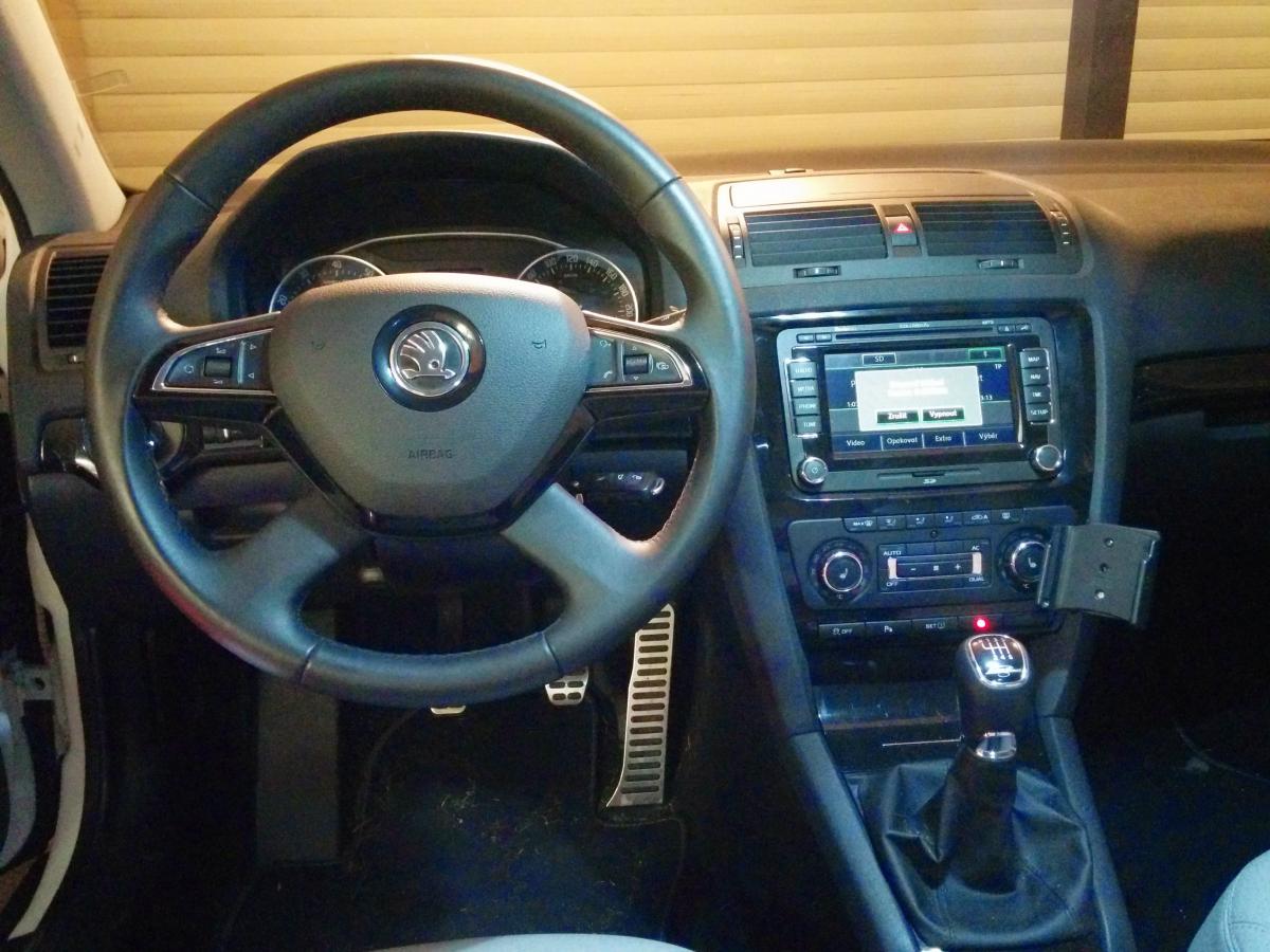

Steering Wheel From Superb 2 Fl
Edited by marekczek
I will be follower in some weeks, last thing is cable and airbag :)

I did this mod some time ago, and found out that a Octavia 3 wheel doesn't work properly and needed superb buttons.
So make sure you check this when buying a wheel
You need superb buttons:  5e0 919 719F
Cabel: 5e0 971 584
Necessary own facelift O2 with active multifunctional wheel with .....CH multifunctional unit.
CH unit is only for pre-fl and cars with old wheel ring till year 2010 ca, after that is no more problem with plug-and-play of old MFSW and MFSW with superb 2 FL buttons with cabel 5e0 971 584
