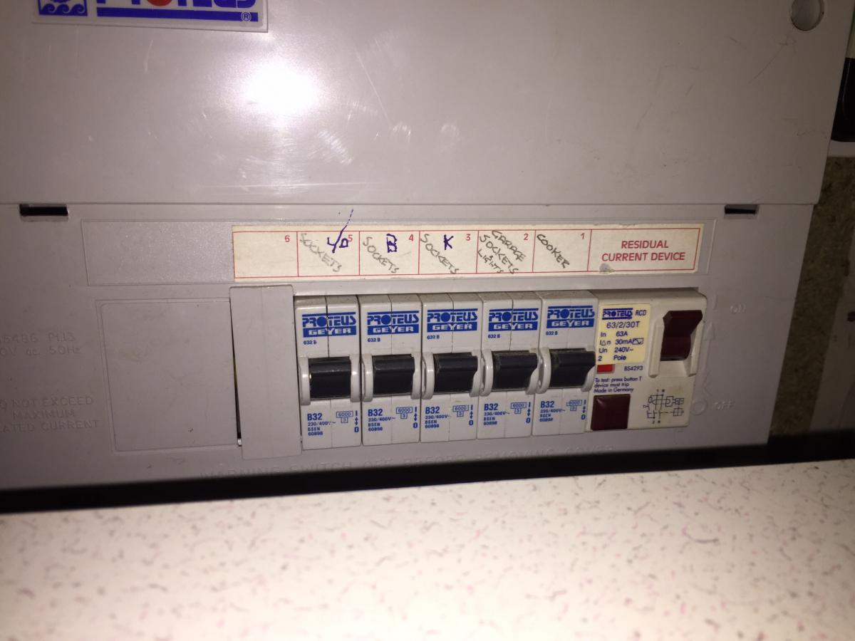

My electric is tripping about once a week, at random times of the day and not as I turn something on or off. It's a pain in the butt as it's not tripping room circuits but the sockets for the whole house. I thought it was an element to n the oven but it's happened when the oven was switched off at the wall. I've attached a photo - it's the main RCD on the right that goes,, not the smaller ones for each room.

Have you got a spur off the ring with an Outside security light on a PIR sensor? Is anything like the dishwasher on at the time. Fai.ing that the garage would be a good place to start as it'll be damper than the rest of the house.
Might be worth getting your friend to do an ohms check on all your sockets, that may cause issues too.

If the rcd is tripping, then something is leaking to earth.
Check storage heaters and immersion if they run during affected times.
Garage is another good place to start along with outside lights.
Any signs of mice? They like chewing wires
The last mysterious RCD problem I had turned out to be green slime growing on the insulation between the terminals in a the cordless kettle base; however I do remember an issue years ago where nothing in our house was at fault; it was a spike caused by a faulty appliance at a neighbours house.

Is it a new build?  If so get the builders back in.
I thought I had traced this type of fault to an appliance, but it was a faulty side of a dual socket - got the builders back to replace it free.
If its not a new build, previous owners' DIY would be where I'd look as that's where I've had the most trouble before, especially where they've put in light fittings or extra sockets.

Could it be the fridge or freezer turning on tripping the RCD.
Garage, sockets and lights on one 32amp circuit.  That isn't right.
as above RCD is a leak to earth, so even if the item is turned off (unless the socket is a double pole), then the neutral and earth are still connected, can could potentially by leaking power.
Disconnect the garage wiring and see if that helps (live & neutral)
The lights are on a separate box. This one is just the sockets (although I suppose the garage has lights and sockets).
Nothing going on with the kettle. I am suspicious of the hearing as it sounds noisier than normal. Might get the pump checked. It's only happening about once a week at most so it's tricky to see what the cause is, as I've used just about every electrical Item in that time without a trip

The cause was 2 junction boxes burried in the plaster. They were open with no cover on and had used a terminal block. So basically the plaster was touching the terminals and causing a very small current to pass to earth which would trip the RCDs now and then.
The earth on the fuse box also wasn't connected to an earth!

Its nothing to do with the neighbours. The fault lies within the Op's property. My advice is get a sparky to do a continuity test on all your earths from the fuseboard. It could also be a knackered RCD, they can develop faults over time.
Get your consumer unit checked out.
