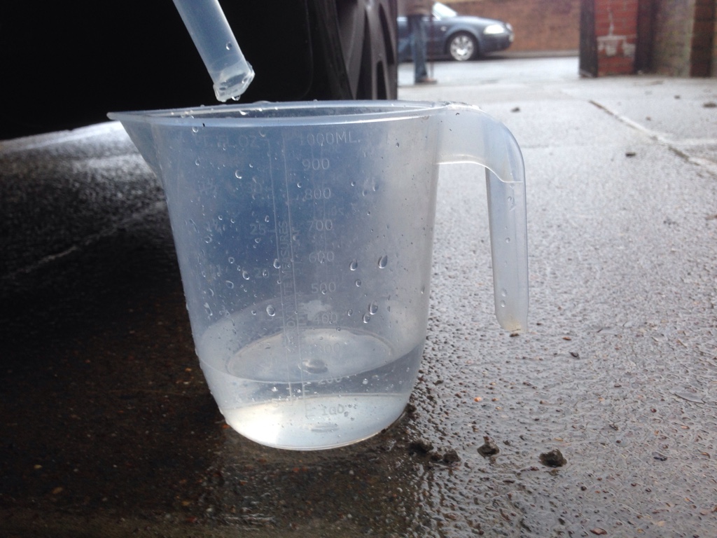

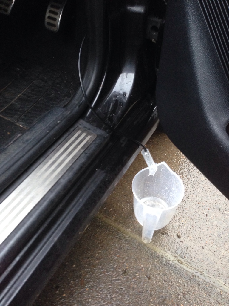

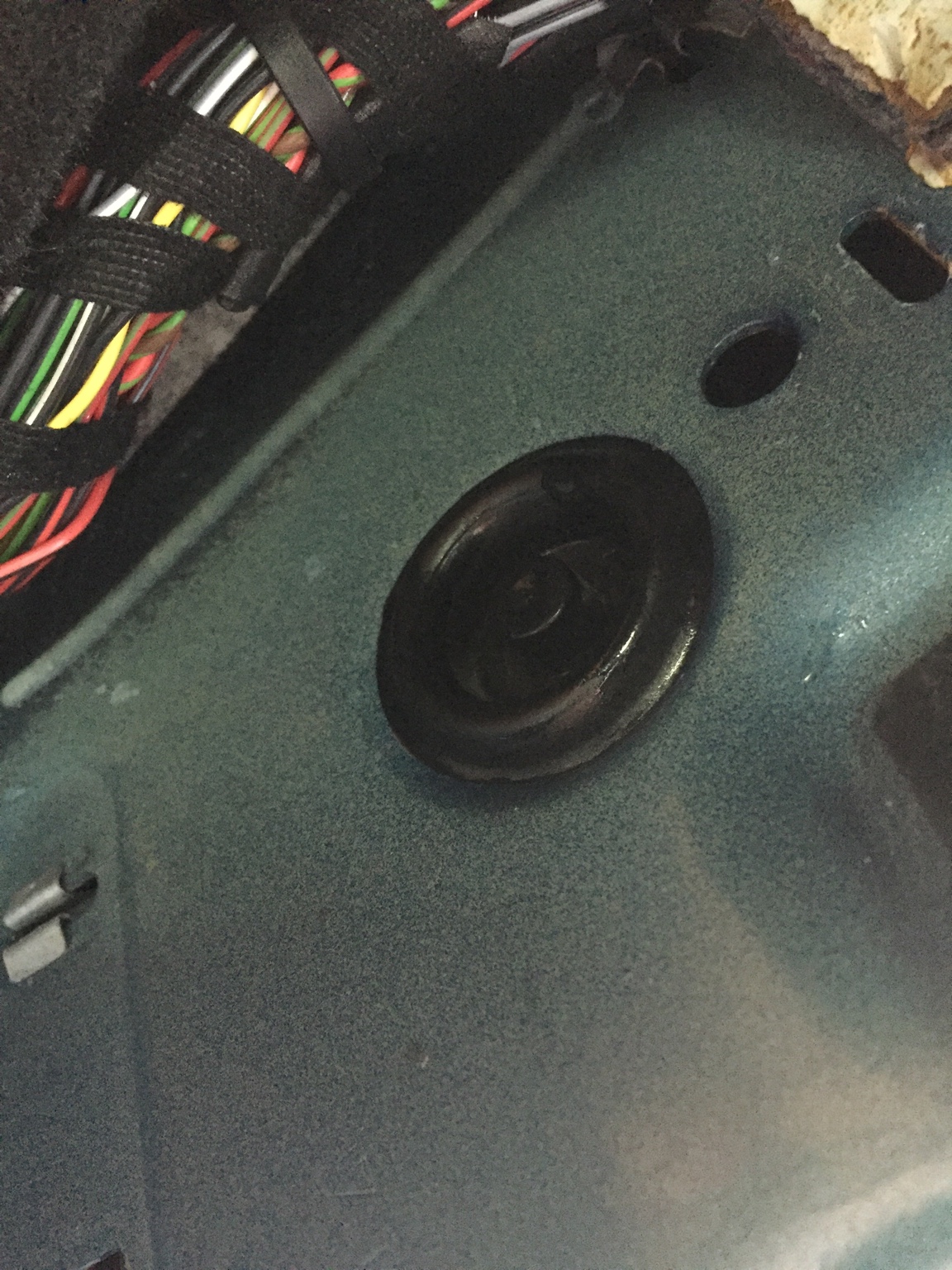

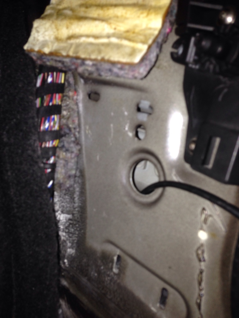

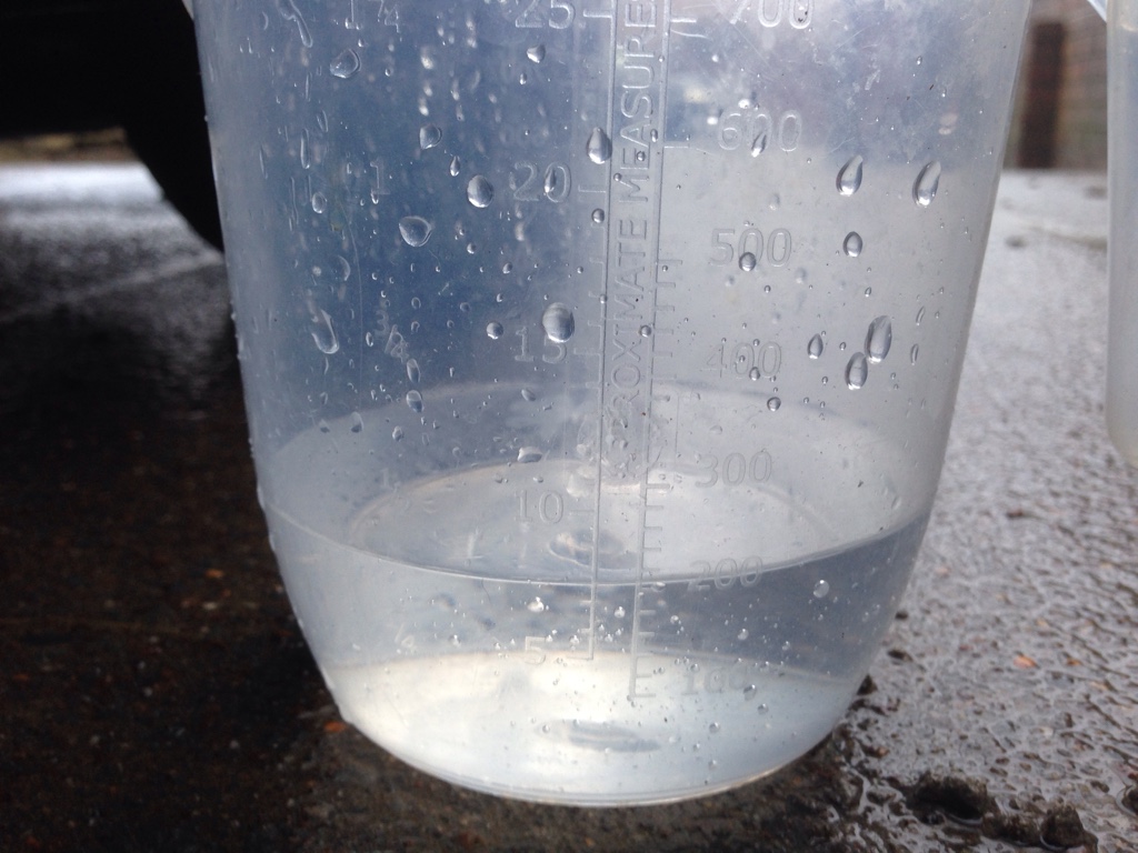

To show just how bad the volume of water is here's some pics i took this morning.
My 'leaky hole'
My syphoning technique
Jug of water
Lots of water
200mls of water from down the hole haha
So you've had a hose on it while you look inside with the endoscope?
If it runs in when the hose is sprayed between the wing and pillar it will be a wing off job, not too big a job just a pain as the rear of wing is attached with polyurethane type sealer which you need to cut through carefully without damaging the wing.

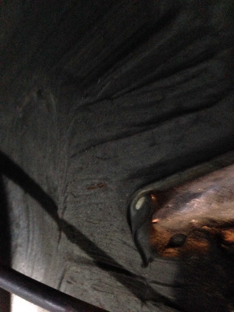

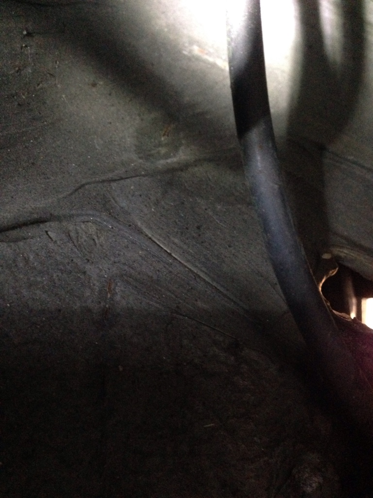

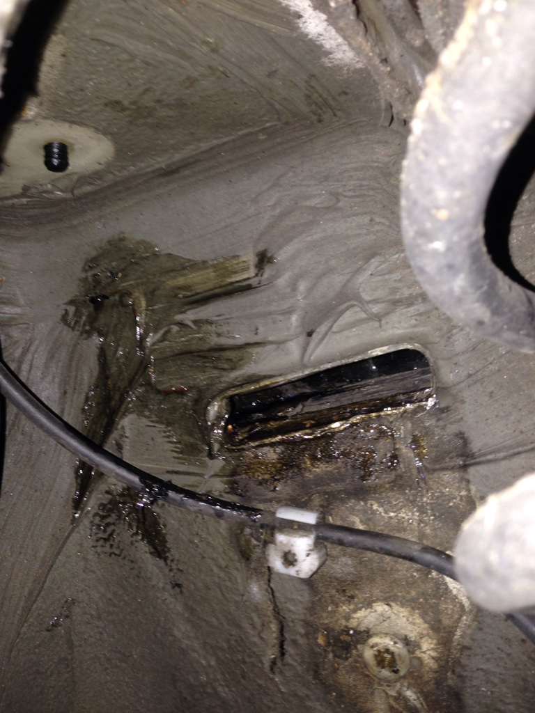

Finished work at 12 today with a new stereo after sum little buggers stole my Alpine a couple of month ago. Seen as it was a nice day i decided to take the arch liner out to see if i could see anything. Found a couple of suspect spots with signs of water.
Got some plumbers gold out and sealed them so now looks like this...
I also took the wiper assembly out again and sealed all along the seams. Im not i overly hopeful but next stage in wing off so i would really like this to work haha.

We'll my endoscope's arrive last week and straight down the A pillar they went. I can see a pool of water and wetness in various places but could not see where the water was coming in at all. So today i removed the inner arch, wiper assembly and the front wong. I sealed every seam imaginable. Still not hopeful on this though. Next will be a case of having to get someone to strip the dash out and and everything else they can think off and seal everything again.
I have a feeling its coming in here somewhere.
