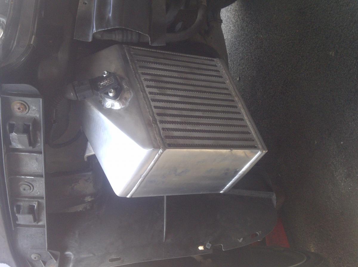

have you tried the darkside developments for a turbo? mines the one in this link
I have an SMIC its the solid aluminium one, i removed it off my bora before i sold it but never fitted it as the fabia came with an FMIC. its  near enough new if your interested. i'm just not 100% sure if the brackets are the same though.
Think I'll just replace it with a standard one tbh. That way I don't have to mess around with new pipe work. I'm still debating wither to get a returned turbo or new. Going to ring round a couple of places today
