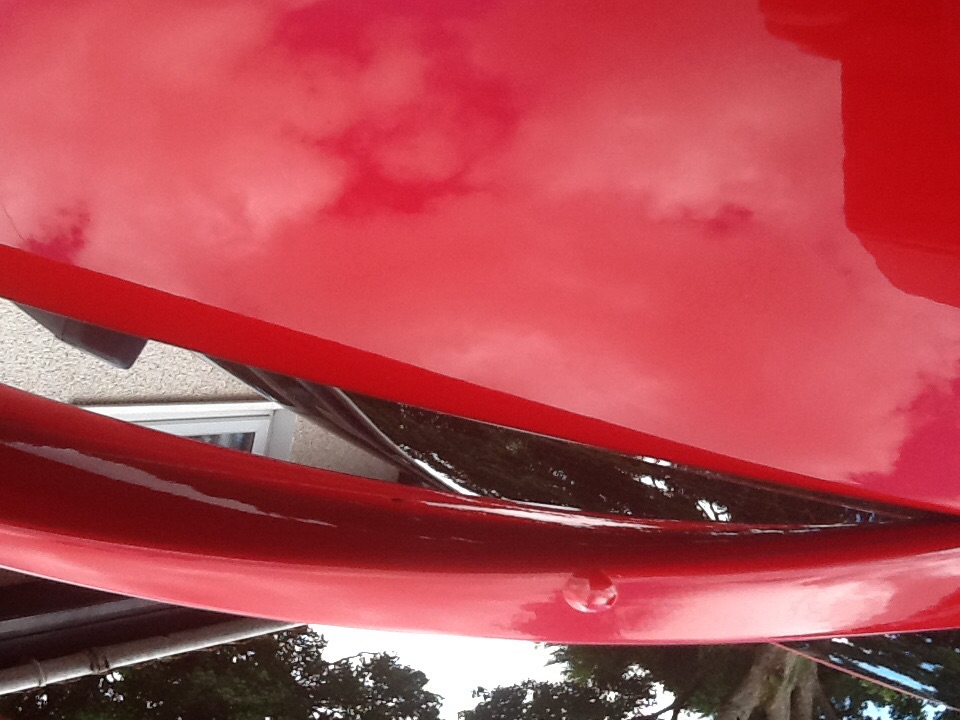

Well after several months of having a bubble free spoiler guess what I found the other day, another paint bubble. After numerous repair/replacements to my car spoiler I am plagued with the fact that no matter how often the spoiler gets fixed/replaced or resprayed this nemesis still returns. I am 2 years into my 3 year pcp deal and 2 months away from when I can terminate it via the 50% option. I cannot believe skoda produce a fast car with such a crap poor quality produced spoiler that can breathe, I will not be buying another skoda for as long as I live, totally fed up with this. The car has only done 5300 miles since new. Awaiting to see if skoda will yet again authorise a repair. Picture attached.

4 months up and 1 blister, going in on 29th for repair. I used to paint cars so am tempted to burst the bubble and see what is underneath and I have seen this along time ago where there
was some kind of oily residue in the plastic. I noticed a post earlier that mentioned a crack/hole that had been filled.
Perhaps they just dug out the residue and thought that was it sorted,(the unofficial/official bodge that the paint shop used).
