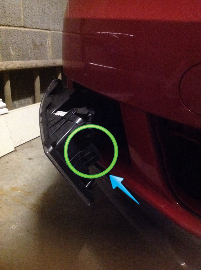

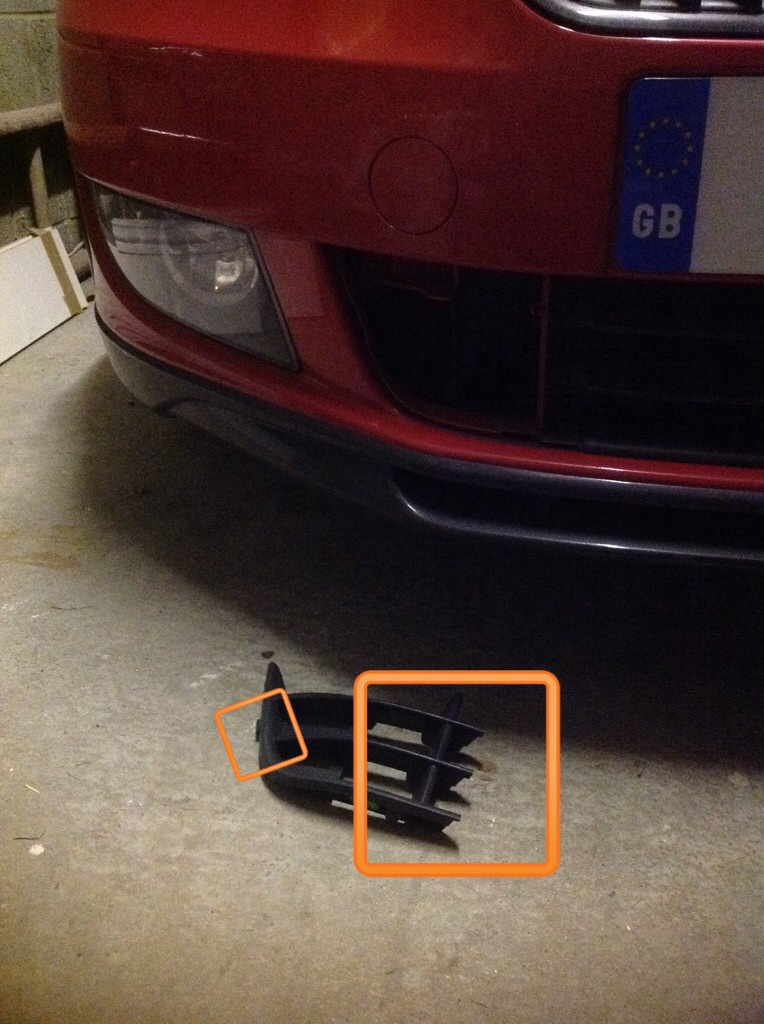

The part of the grille that needs to be pulled off has a kind of clip on each of the 3 horizontal fins then 1 on the left had side next to the light itself, I'm basing this on the driver's side DRL. Once you've pulled this off, it won't break as it's quite flexible, there's one clip that you push in behind the bumper and the DRL unit will literally pop out.
I've tried to take some photos with my IPad but the light in my garage isn't very good.
With a lot of pulling it finally worked lol, there was only one clip so it was just a case of pulling, thanks for the help. However my leds don't work hahah, i tried switching them around and twisting them but neither of them work, is it me fitting them wrong or are they broken?

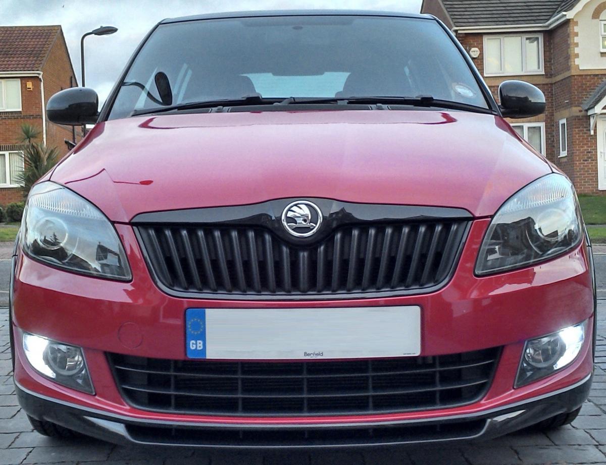

They're a similar type to mine, they look good fitted and fill the light unit and reflector well and do look like OEM LED lights.
Here's a daytime photo of them on so you get an idea what they look like.
Looks perfect, will order them tomorrow
