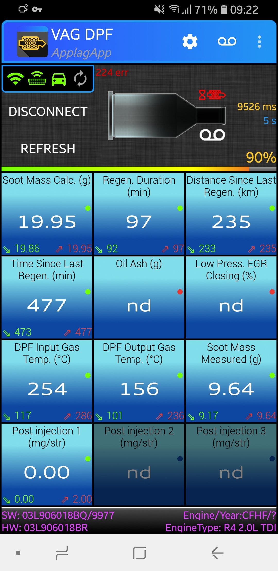

It is old topic but i am new in vw world and have 2012. yeti 2.0 tdi CR 81 kw. Buyed it from 1.st owner one week ago. It Have 190 000 km. scanned dpf activity with vag dpf pro apk on android and dont understand results. On board comp no errors, but after scanning thru odb2 connector, app shows 90% of fillnes i suppose. Can someone explain this data and what 90% actually means? End of life?
Help ;-)

I have this app and your screenshot indicates an active regeneration is due / scheduled (? was previously interrupted).
Driving the car at reasonably high revs should see the DPF cannister graphic turn red and the % bar indicator will fall until it reaches around 20%. At this point the cannister graphic will turn back to grey / green and the active regeneration will be completed.

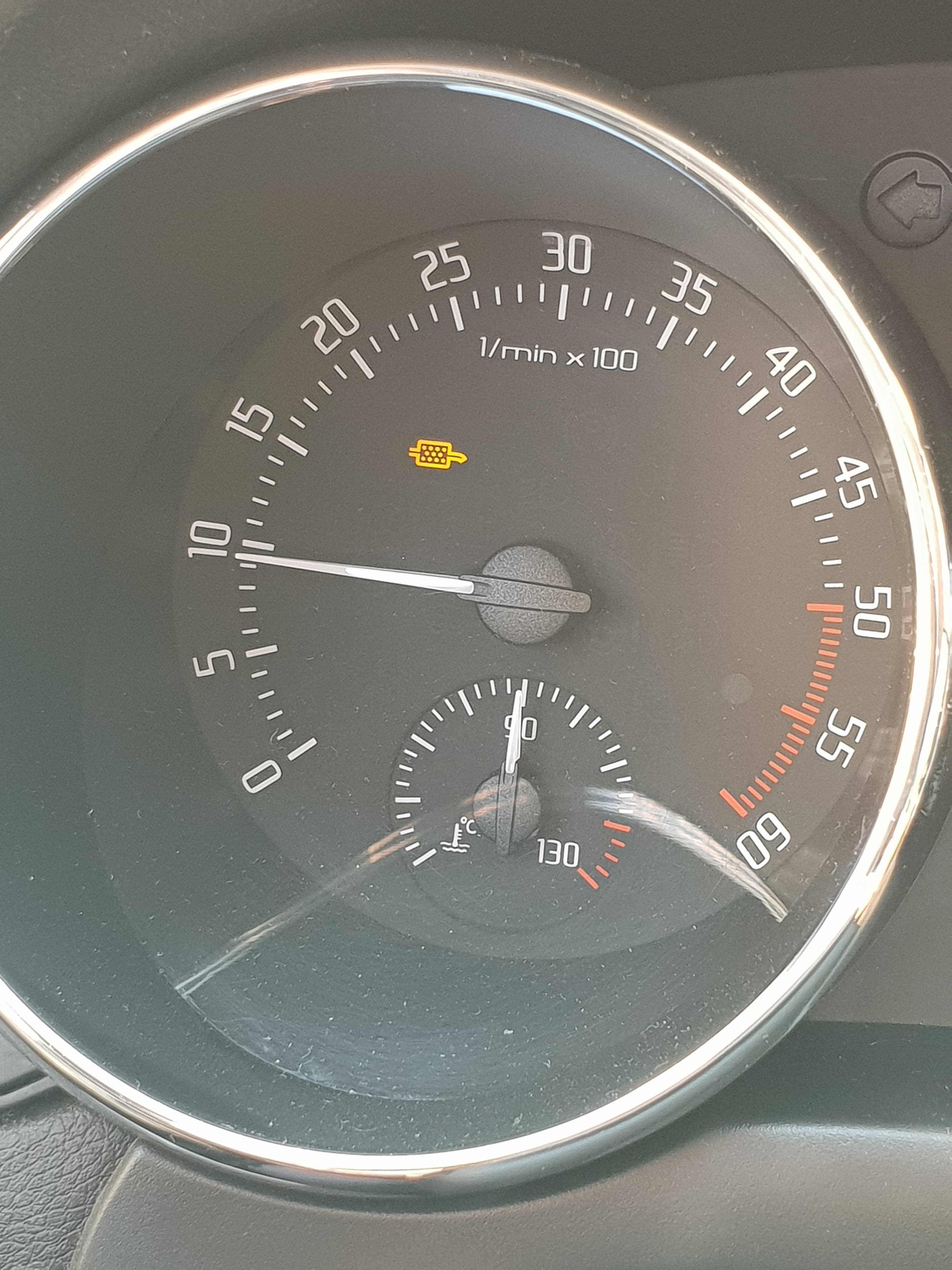

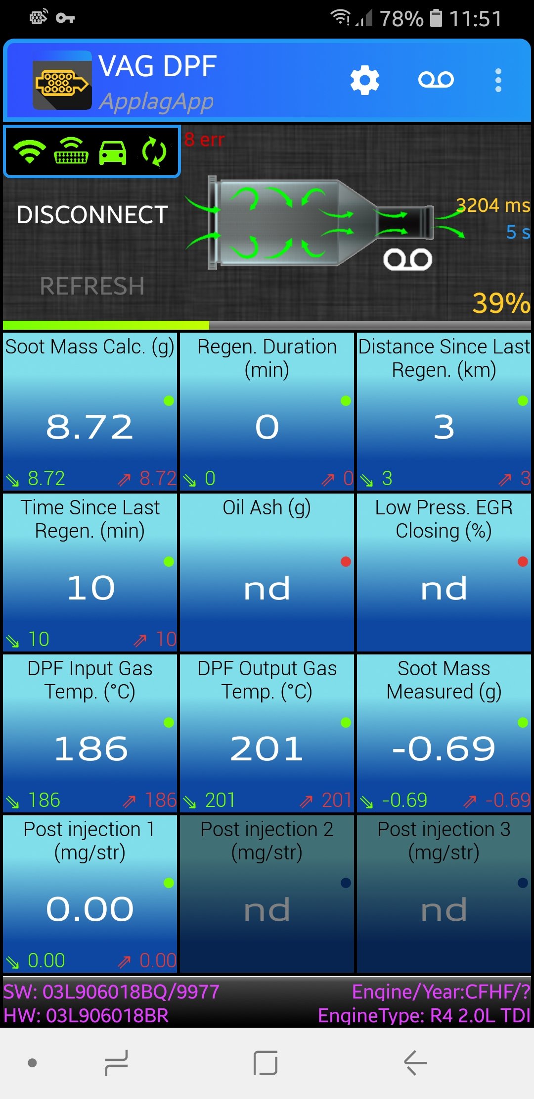

In morning when i was going to town, dpf warning appeared. Went to gas station and filled fuel to max. Drived 10 kms thru town and warning disappeared. Strange..
Percentage dropped..

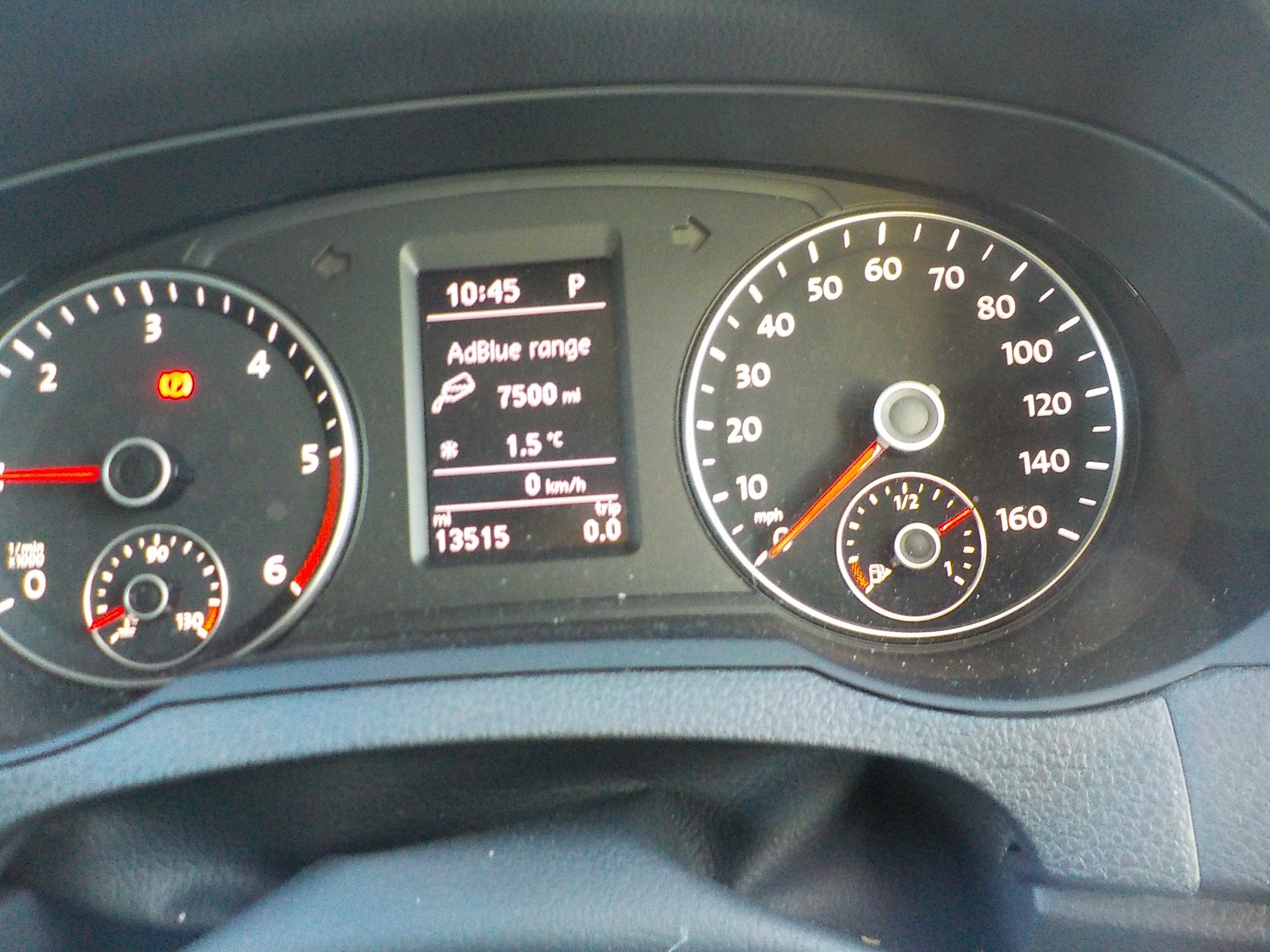

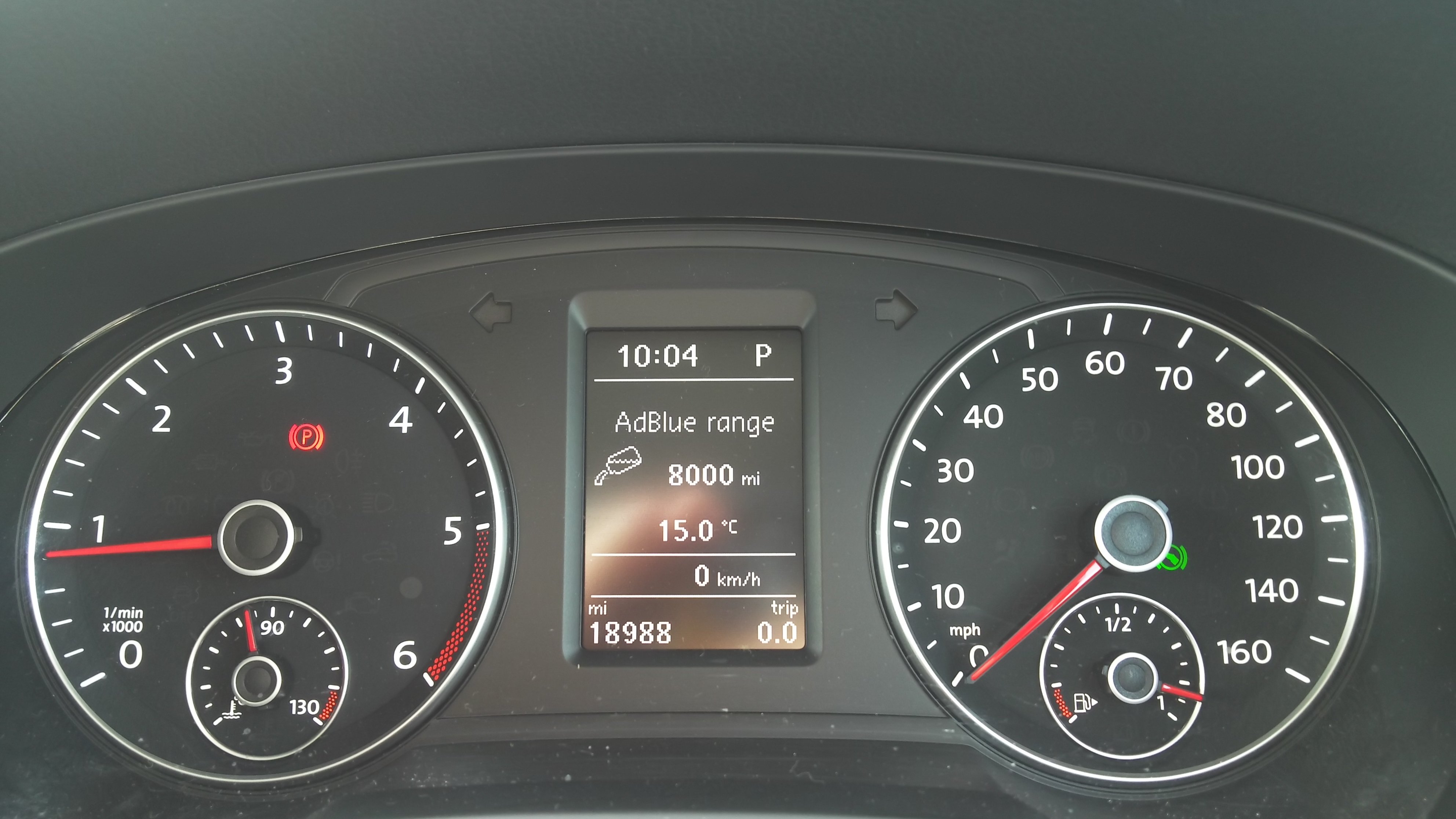

What i mean is the car new November 2016 came showing 7,000 mile AdBlue range, on filling up 1st & 2nd time went to 7,500 mile range. Maybe fuller.
On the next fill up showing 8,000 mile range & was no fuller than the time before and now is just sipping the Ad-Blue not dropping every 500 miles as it was, but then no longer getting used as a going to the shops car, short trips very often.
