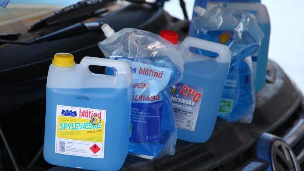

Isn't all comercial washer fluid basically a mix of water, kind of soap and alcohol? Here in Norway all fluids manages -15 deg celsius. The freezing temperature is dependent of the alcohol prosentage.
What type of washer fluid is available? Consentrate is handy, you simply mix yourself to match your expected lowest temperatures. You can also add a clunk of consentrate in the tank to lower the freezing point. Or top up with "winter type".
It is really just a matter of water-alcohol ratio. It is even possible to make your own from scratch: iso-propanol + water + soap. I'm sure variants can be googled.
