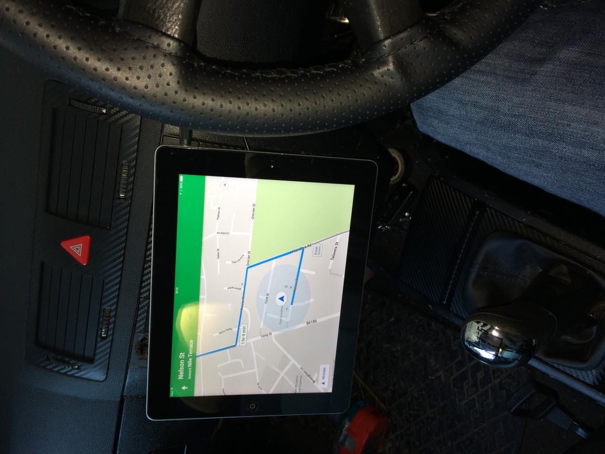

Hi everyone, finally finished the project, here's the result:
here's the 3d printed piece that holds the ipad (with magnets)
without the ipad
And the wiring, which now sits behind the thing, where HU used to be

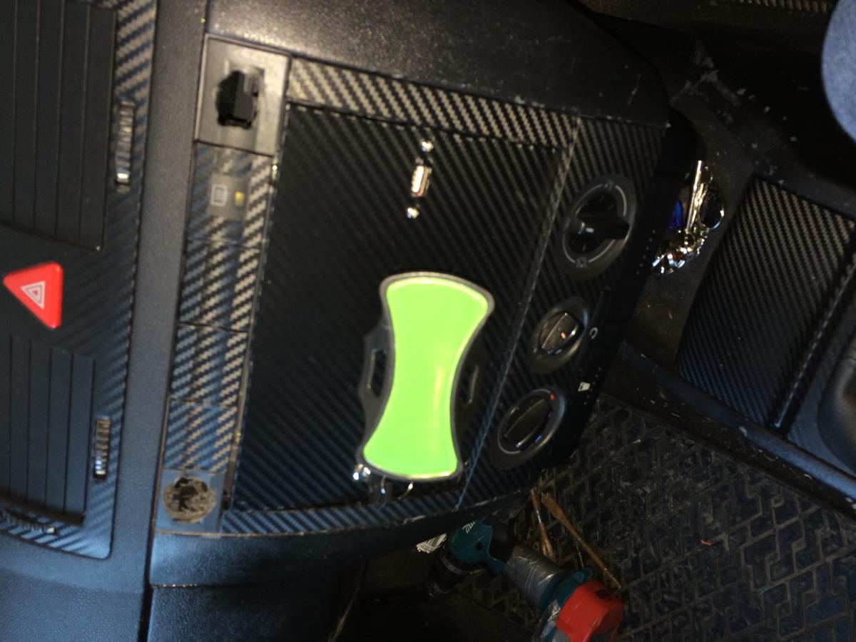

I've taken your idea and built on it slightly..
I dont want to lose the ability to have the radio on, or the fact that I have a very good stereo kit in the car by removing the radio and going straight to the Amp.
I have decided to move the Radio to the glovebox, built a small box to house it securely. Add a USB Cigarette lighter adapter in the Glove box too.
Run the Bluetooth unit on the Cigarette lighter USB ( wired in for ignition on only) Then plug the outlet from the USB Audio receiver into the Aux plug on the Radio.
Great Sound, and I still have the radio if I need it :)
Few links for others if they want them :)

This is what i'd like to do, how the hell did you run the loom to the glove box, had a quick look and couldn't find an opening from the centre dash :(
Bit of jiggery-pokery and a saw blade. Cut a hole but be careful of the wires. Take it slow. I'll upload the pics when I get round to it.
Thank you very much! Would really appreciate the photos :)
