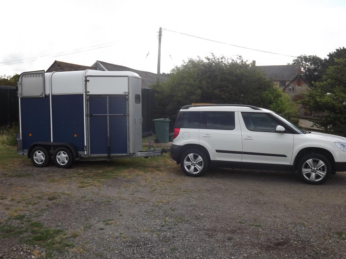

Hi, I tow a horse box with a pre fl 140 4x4. the box weighs 900kg & we reckon the ponies are about 700kg between them. I have to say the Yeti tows them quite easily. Not had  any issues at all.
post-24105-0-65619200-1419922972_thumb.jpg    post-24105-0-84013900-1419923009_thumb.jpg
Ah that's interesting thanks for that it's nice to know that someone uses the yeti in that way.
