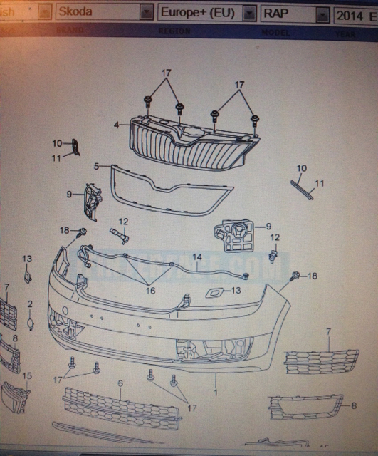

I managed to get the garage's instruction on how to remove the bumper on the Civic. I would've thought that the Rapids would be floating around in cyberspace somewhere
I've tried always to look for a How to but there's nothing available (for free).
Even Skodas part catalogue is useless. The top screws are fine it's just a matter of what's at the bottom holding it.
I wouldn't pay £9.99 just to look that up though. I'll suss it out somehow. It can't be as bad as my Citigo was [emoji57]

I've got some bad news for people looking to replace the front grille the front bumper need to be removed to get at all the bolts that holds on the grille. It's the some thing for all new skoda's the grille is part of the bumper.
They sell the grille assembly seperate so it can't be part of the bumper. There must be clips at the bottom.
There are many EPCs that are worse lol VW's ETKA system is one of the better ones
Others have removed the grille without having to first remove the bumper, so I'll remain optimistic for now... where there's a will there's a way!

I've mentioned here before that I had work done on my 64 rapid liftback. The front grill was removed while the bumper was on. Its just the screws at the top and then clips.
Edited by mcdl
Thanks mcdl [emoji106]
There picture isn't very clear on this.
