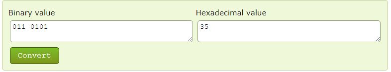

Original bits (ESP always on bit in bold):
011 0101
translates into hexadecimal:
3 5

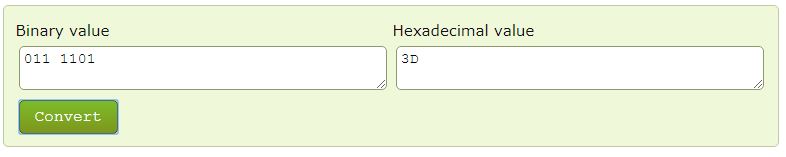

Modified bits (ESP off function enable bit in bold):
011 1101
3 D
Useful tool when changing bits:
https://www.binaryhexconverter.com/binary-to-hex-converter
