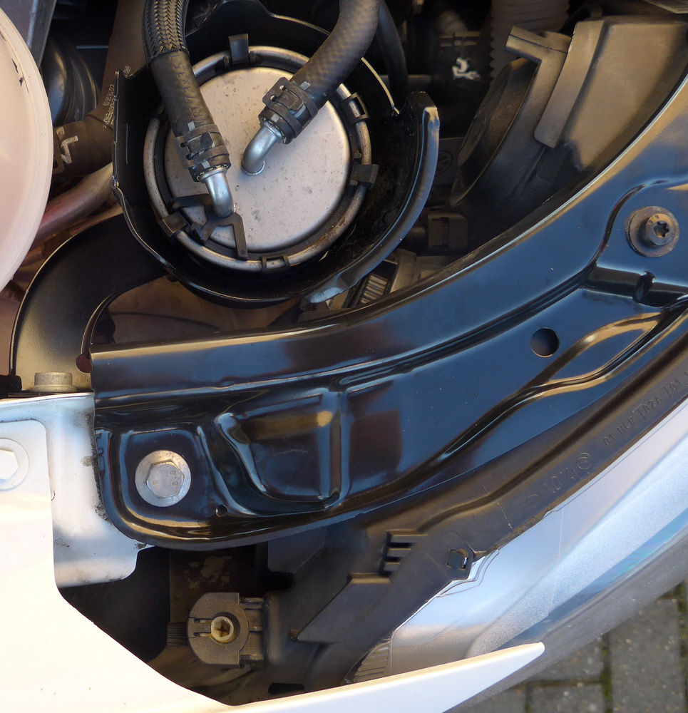

what a mare changing those bulbs! now i have to visit the skoda dealer in peterborough tomorrow to see if they have the protective cap part for the rear of the dipped headlight housing! yes, i dropped it into the void of tangled metalwork and aircon pipes to an irretrievable place! i gave up in the end i went to halfords... where they also had a mare but a fitter with the slimmest hands managed to get dipped and sides replaced. i went for bosch gigalight plus 120's. the new drl's do look sweet as well. £90 later and i now have a new set of h7's from euro car parts taking up space in the glovebox :-)

Wow, I see your problem.  My car does not have the black bracket or the silver can it contains, just a space that my hand passed through.  I'm rather suprised as I thought there was an EC requlation that meant bulbs had to be user replaceable.  Looking at the connectors I wonder if it is a fuel filter or similar.  As to the rubber cover, if you lost it as you pulled it off the lamp unit it could be lodged behind the plastic wheel arch cover.  If you lost it as you brought it out towards the engine it could possibly be sitting on the engine undertray which is secured from underneath with 9 torx screws.  In both cases I can't imagine it causing a problem if left so a new one from the dealer sounds a good plan.
the silver can attached by the huge black bracket could be something to do with the climatronic climate control thing? (stop me if I am getting too technical). the halfords person expressed surprise that whatever it was had lower fitting bolts that were directly under aircon pipes, making them impossible to undo! I hope whatever it is, it has a life of more than 3 years when I will replace this car.

Looks like the Diesel filter
I am happy to go along with that theory. as I say I love driving cars but have no real idea how they work
pic of the access area on drivers side... impossible for my hands

Is it s diesel?
That looks like the filter [emoji6]
