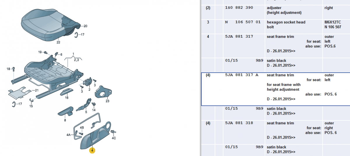

Here's something that was in front of my eyes but I hadn't noticed: The seat frame trim has been added to the production since 26/1/2015. (Unluckily my car left the production line on 22/1/2015 :sweat: )
So that's why nothing has changed for MY2016, it has already been done. I 've attached a snapshot from ETKA below. It is item number four.
Someone from Russia has already done the retrofit, check it out:
https://www.drive2.ru/l/6442681/

Thanks for digging this out.
If I am reading this right - the frame has not changed, so we can retrofit this to seats in earlier cars - right?

Very interesting and potentially very good news.
Although if been in production since Jan I wonder why there are none at dealers?

As far as I can tell from ETKA:
The frame (and everything else regarding the seat) remained the same as before, when the trim was introduced back in January.
For the height adjusted seat there is only one frame version. For the non-adjusted one, there are two versions, pre and post March 2013. I suspect that the trim fits both, but I cannot be sure.
Long story short, if you have a seat that can be adjusted for height you can do the retrofit, use part numbers 5JA881317A, 5JA881318A, 5JA881559A, 5JA881560A, 4x(N90737107, N90703802, N0385012). If you have the non-adjusted variant chances are that you can still do it, especially if your car was made after 3/2013, and use part numbers 5JA881317, 5JA881318, 5JA881559A, 5JA881560A, 4x(N90737107, N90703802, N0385012).
Total cost in Germany, including VAT: about 65 Euro.
EDIT: Found more people that have done it. See this Czech forum: http://forum.skodahome.cz/topic/130417-seda%C4%8Dky-zakryt%C3%AD-kolejnic-sed%C3%A1ku/page-3#entry2035008

Been speaking to my SEAT dealer the last couple of days.  The salesman and the parts guy have now found the SEAT version of the exploded seat diagram showing the seat trim.  They have today emailed SEAT in Spain to ask if new build cars have this trim fitted now.  If they don't have it fitted from the factory they are going to try and find out the correct SEAT parts required and will be willing to order the parts and retrofit the trim.
Sound like good news either way.
