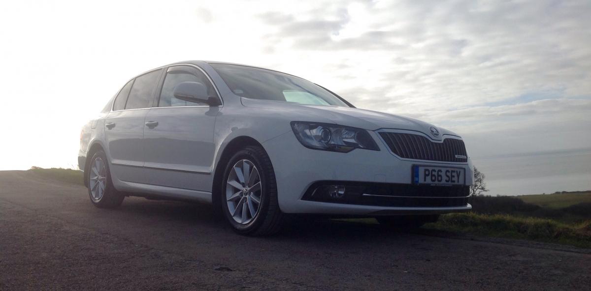

Hi there , love my Skoda superb greenline but find the ride a bit hard , anyone have any ideas for softening up the ride , I know it's lowered by 15 mm and has the sixteen inch wheels with special high rolling tyres.
Was thinking of changing them to 17" and putting the correct tyres on them that come on standard superb , any advice welcomed
