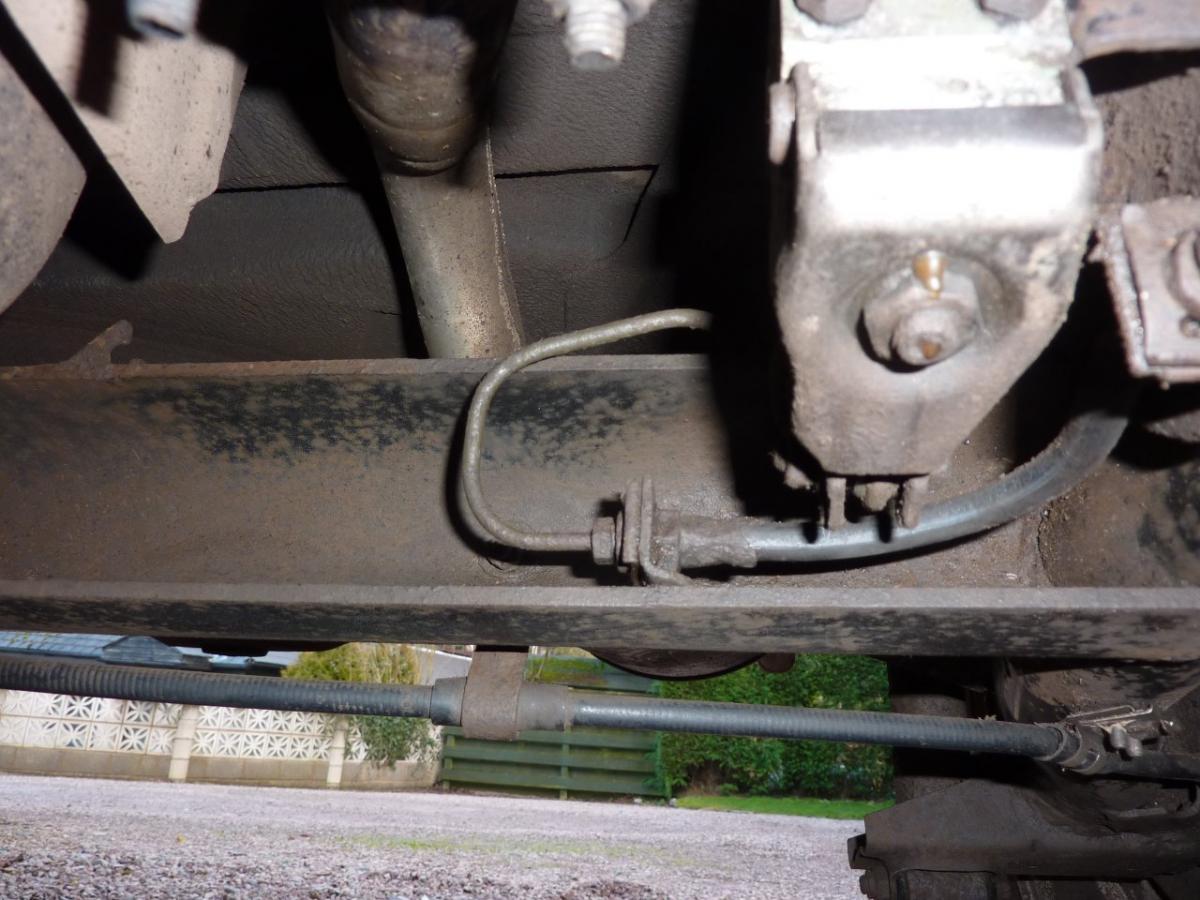

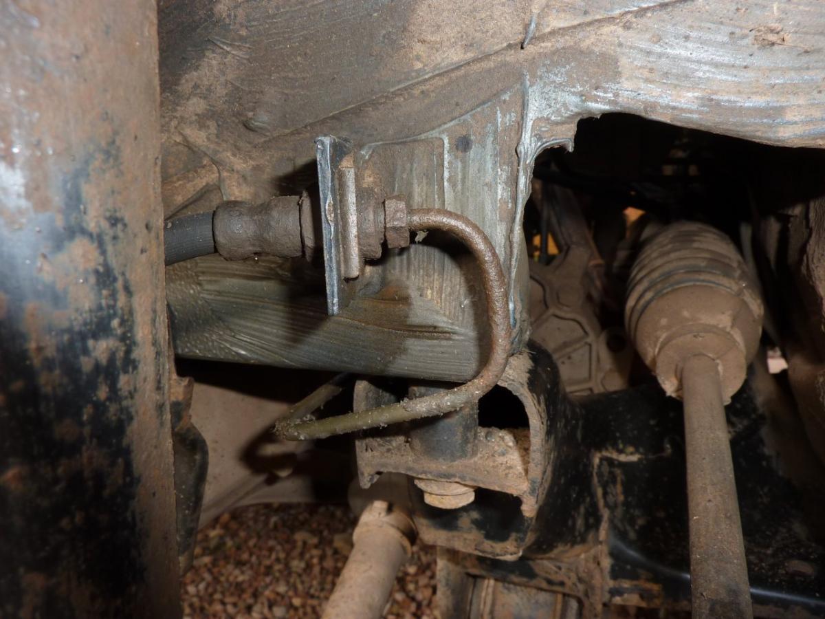

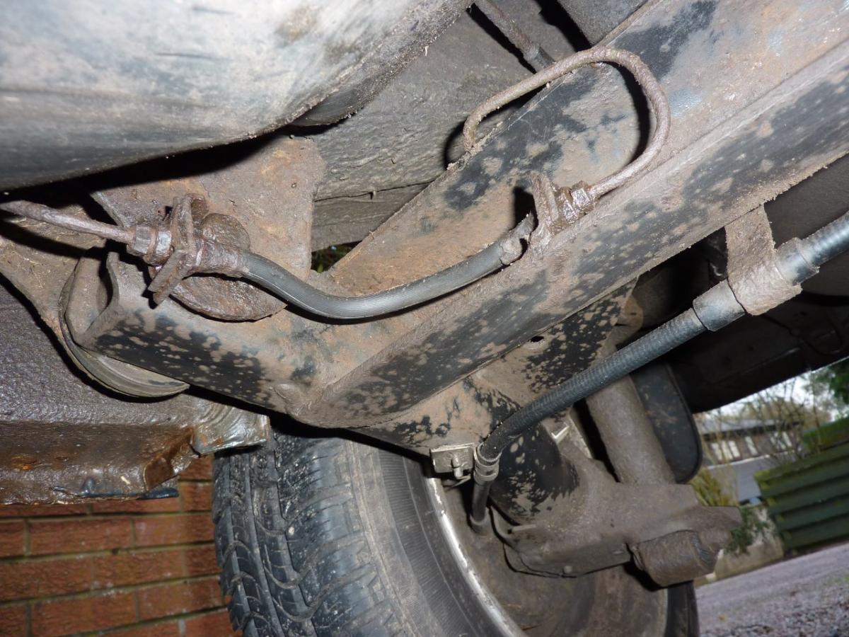

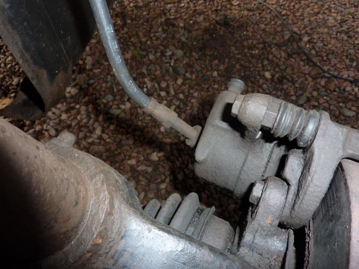

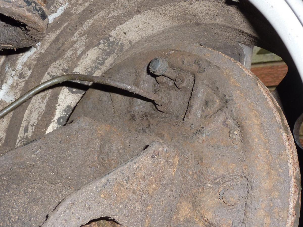

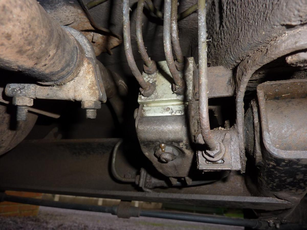

Hi there, hoping for some advice about my brakes.
I've cleaned them up for the photos - so you can see them in all their horrific glory.
Several of the pipes were marked as advisory on the last MOT, and the next one's due very soon.
I'm also wondering if the rear brake pressure compensator will need replacing - you can see the alloy is pitted and corroded at the pipe connections and I'm concerned that if I remove the pipes, the unit might be too damaged to re-use.
Any advice/thoughts welcome.
I've seen a lot worse but you will need to change the brake pipes if they were a advisory last year the MOT examiner will see that when he gets details up this year. Let's be honest brakes are the only things that stop you so spend a few quid and get them sorted. The compensator should be okay but they can corrode with steel connectors into an aluminium body new ones are still available but not cheap I've got a good second-hand one if you need it Also be prepared to struggle with the rear wheel cylinders the good news is They are readily available and not expensive clive
You can always coat up all metal pipes with a layer of grease (copperslick preferably). It's always best to do this anyway to stop corrosion in the first place.
This grease then gets coated with road grime, which less vigilent MOT stations don't bother to wipe away to check under.
If you are really woried, then as rv125 says it's replacement time, but I recall there being a thread a while back about how hard it was to get replacement brake pipes.
I've just painted my brakes, and it's took several weekends.
Depending on how confident you are a break pipe toolkit to make your own is about £15 on eBay. A roll of copper tube is a similar price. I am lucky in Crewe there is an old fashioned Car parts Cornershop and you just take your old pipe to him in the correct shape and he will make you a new one always leaving a little extra length as it's not difficult to lose some if  long but it's impossible to stretch them if they're too short Possibly you could find some were similar also I wouldn't want to replace with steel but to be honest your brake pipes have survived well our cars are getting rather old  and they will be the original ones
In addition to my previous post I've just been to my lock-up to help another member out and I have found a full set of rear brake pipes in copper have been used but obviously will never grow old lol  it may be a challenge posting them to you obviously they don't weigh anything just a strange shape clive

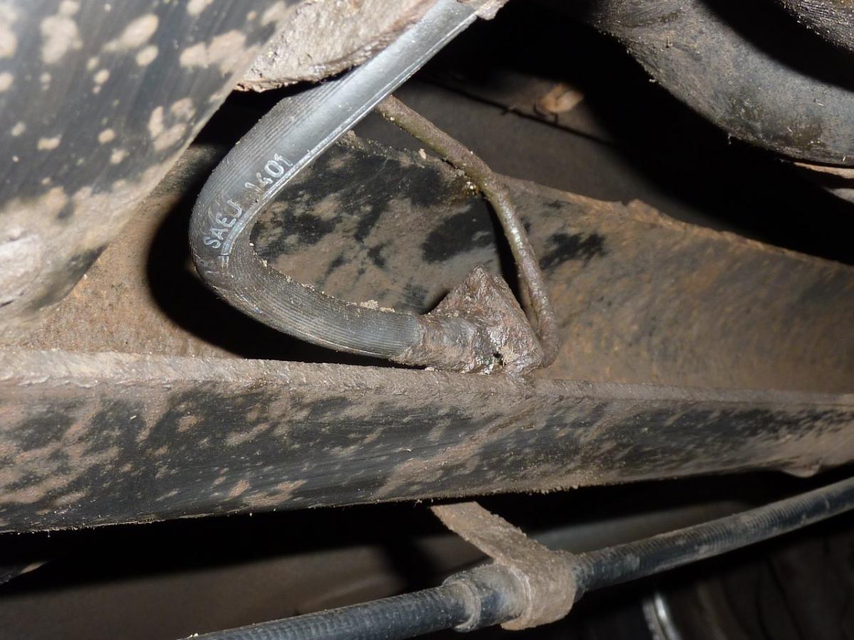

I'm an MOT tester, and from what I can see in the photographs I'd be happy to clean up and grease the brake pipes as they don't look excessively pitted or corroded, but I'd be wanting to replace the rear brake hoses because the ferrules are very corroded.
As I said, that's from what I see in the photographs, other sections of brake pipes may be more corroded and need replacing.

On the front caliper, the long straight rod sticking out that the hose connects to - does this come off with the hose, or should it stay in place?

Clive - you mention struggling with the rear cylinders - do you mean the pipe connection to the cylinder? What sort of difficulties should I be prepared for?

Dave - I showed the worst bits.

The straight rod comes with the new flexible holes and is removed

The rear cylinders can be difficult as the brake pipe not will almost certainly be reluctant to come out also if it does go wrong the two screws that hold the wheel cylinder to the back plate will be full of crud make a point of cleaning them out before you put the Alan Kek in to remove them make sure it's fully inserted or you will round them off quite easily.

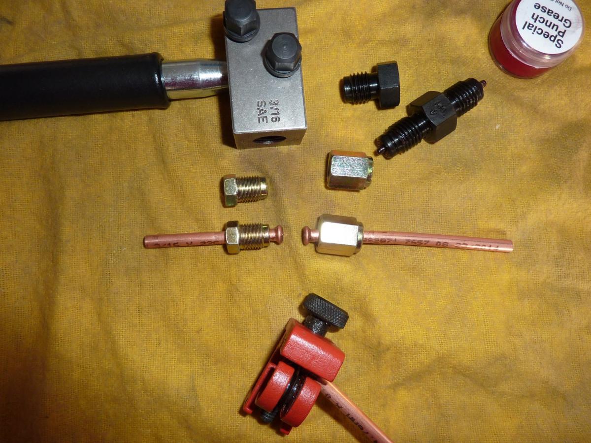

I've got the kit now, just practiced using the flaring tool. I'm just a little confused about single flare, double flare and bubble flare.
Which one should I be using?
I will have to cut the existing steel pipe and renew the rusty section.
Photo below shows two double flares, into male and female fittings. Can these two join together to link two pipes or do I need a proper Union fitting?
have a look at
If you search on Google images for  brake pipe flaring You will find lots of pictures to point you in the right direction.As you remove each old pipe examine it carefully to establish which type of end it has and recreate the same remember to put the nuts on facing the right way before you create the flair. I would guess the in line connectors  you will need to purchase will be a single flair both sides Basically you create a single flair by putting the pipe in the tool once and compressing the end . To create a double flair you usually use another adapter or turn the adapter round and compress the pipe again this folds the end of the single flair into itself. You must get a correct connector to join the pipes together you cannot use a male and  female to join 2 pipes together the copper will just bend against itself.
You will find flairing the steel pipes on the car a lot more difficult As the steel is a lot harder than copper a little grease or lubricant may help Don't leave any in the brake pipe though.
Thanks rv, I'm getting clearer now I think.
I've just been out to buy a box of female/female connectors, so I could join the old to the new, but on the way home, I realised I probably don't need them. I think I can use male and female connector to form a union but I need to do a single flare for the male part which sits inside a double flare for the female part.
I have photos to clarify, but can't seem to upload atm.

Last years MOT also noted slight corrosion to the front offside pipe, but I'm wondering if I can get away with it as it is (see first post for photo).
