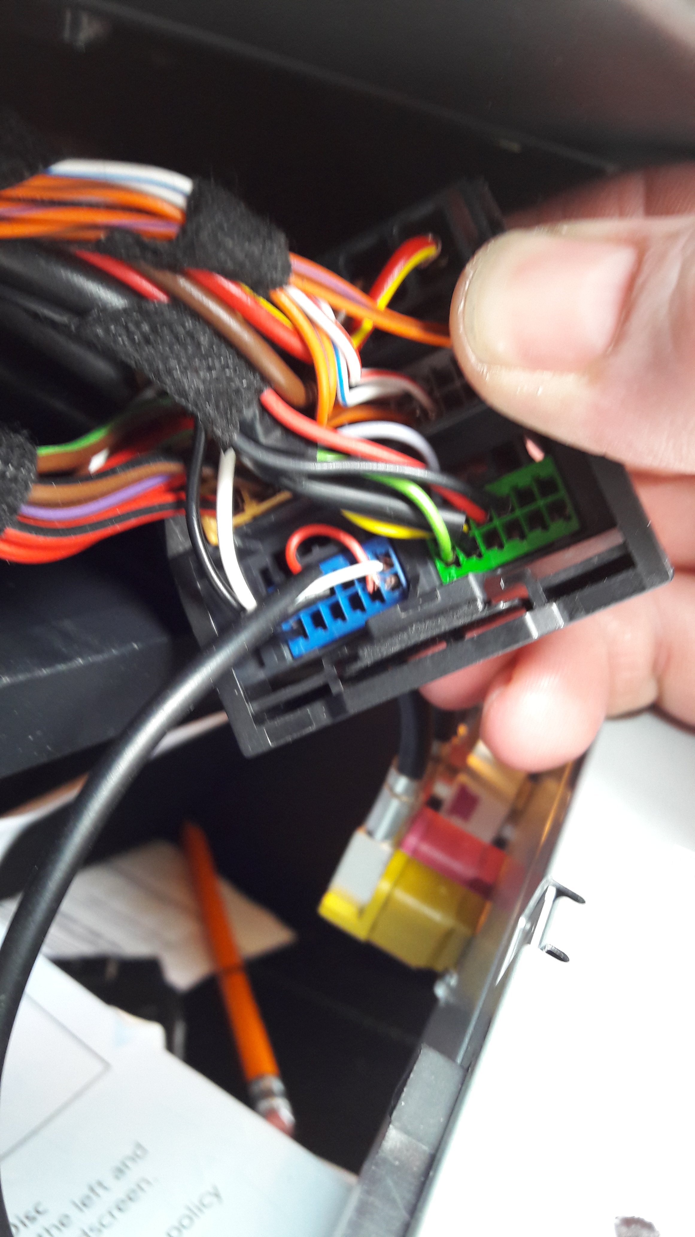

Yes I think I have.will post a pic later showing.
6 is the top right one looking from the back
sorry but from that pic it is very difficult to see, the cable does not look to be the correct type, is it a shielded cable?
if so the shield needs to go to 12 and the centre core to 6. Try swapping them over and see if it works

I used an rca cable and cut of one end and then I just crimped the terminals on to the wires
John
Mine is not shielded either, that's not a problem. :)

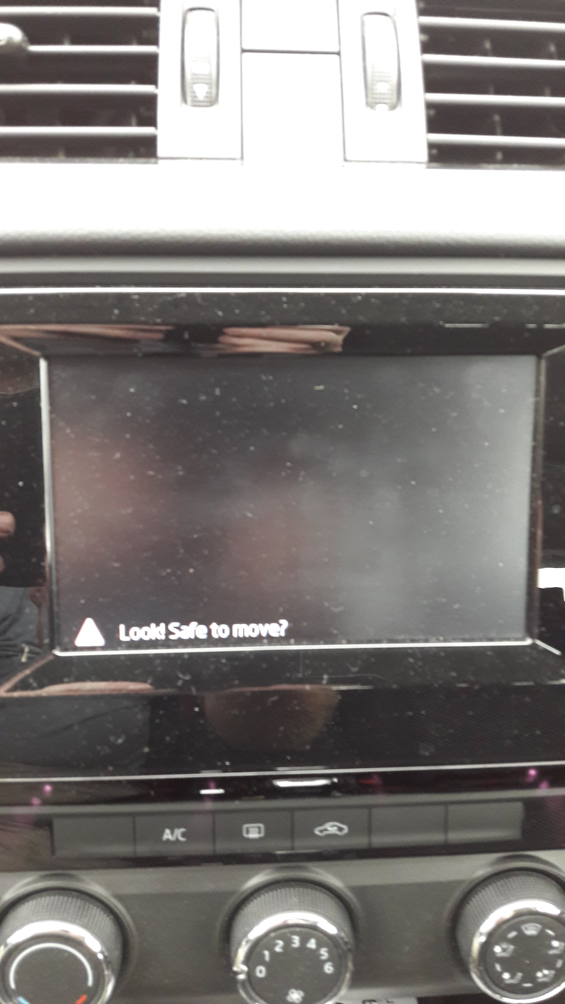

Hi
I haven't installed the long cable yet.
Hooked up for testing first.
Head unit
All I have on screen

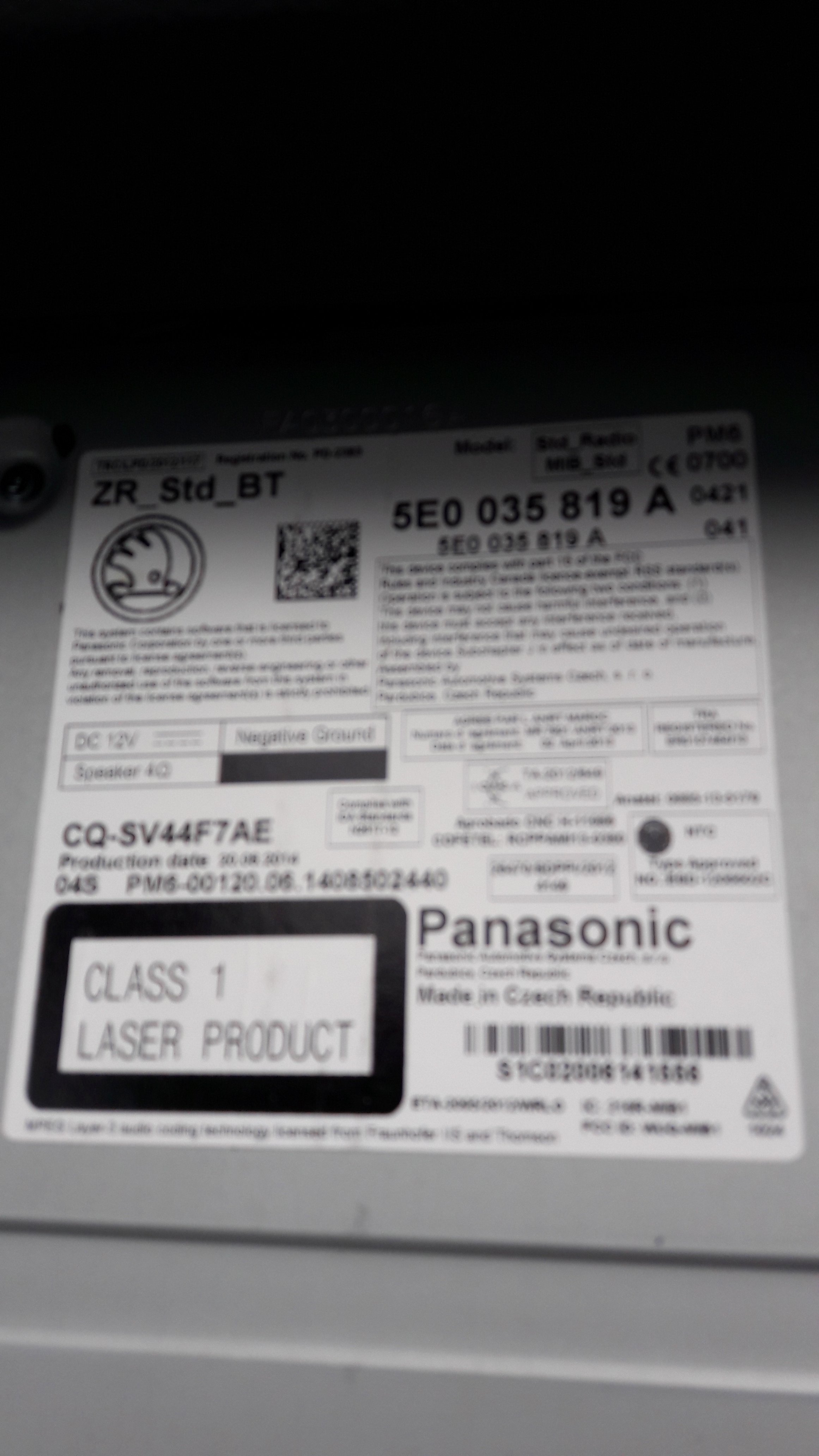

Can anyone confirm they have the RC working on the above radio pleas
This is not your lucky day then. :sadsmile:
The same info here, yours is on the list...:wall:
Balls.
Camera for sale so.
Could I swap out this bolero for another one??
Probably cost too much???
