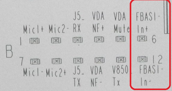

Having made a connector for the rear view camera input I wonder what the other connectors shown in the picture are?
Does any one know?
They seem they are phone specific connections like muting etc. Probably for an optional phone car connection kit, which makes sense for a media module.
Most radios have them.

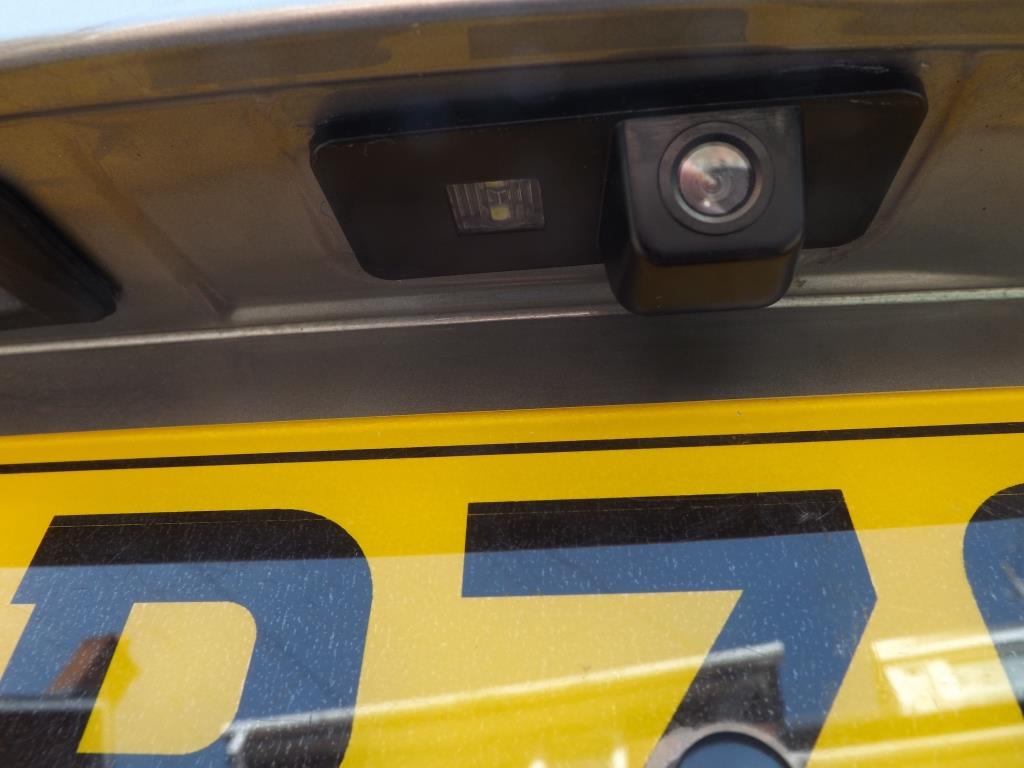

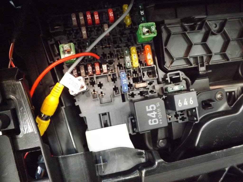

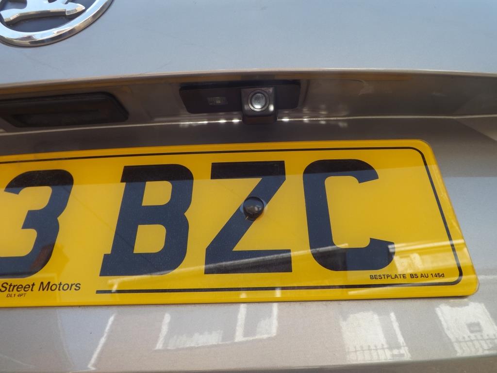

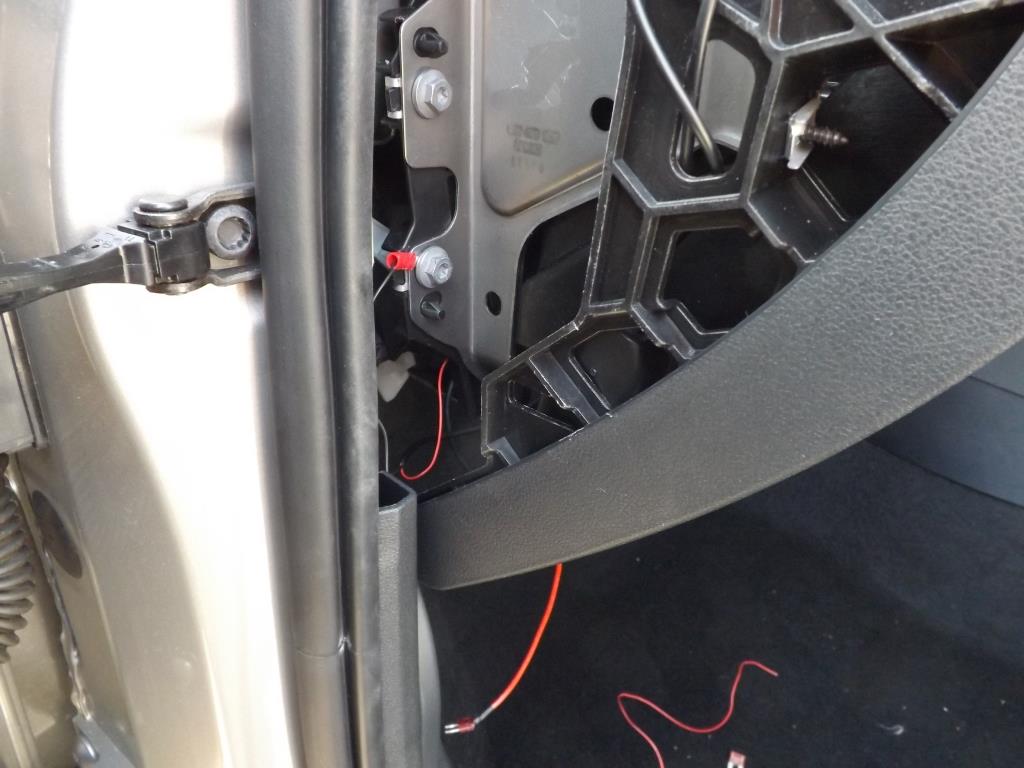

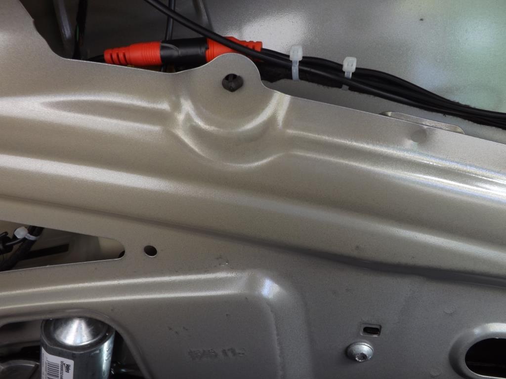

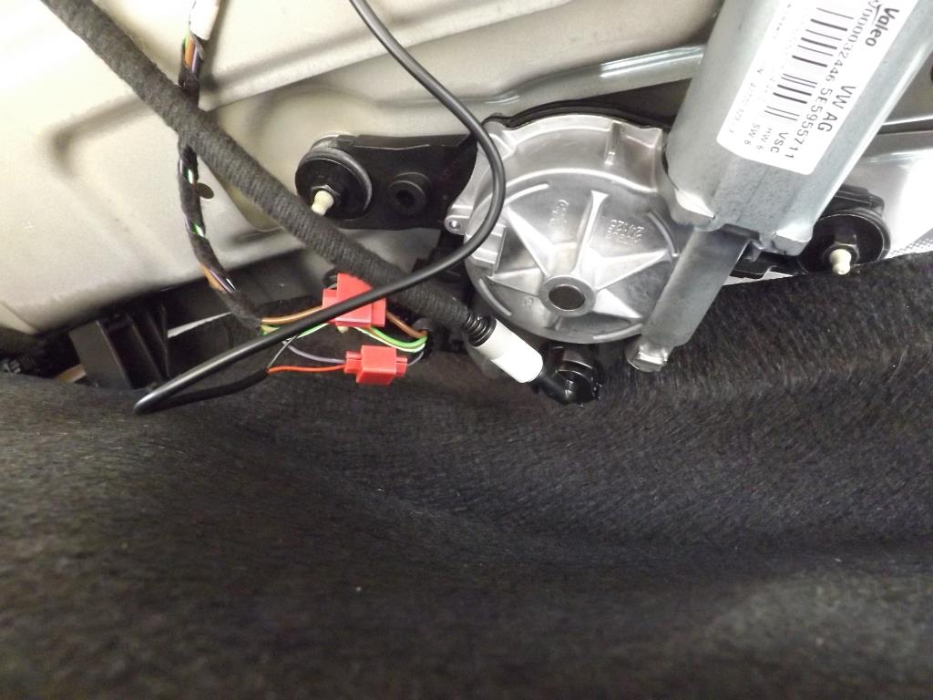

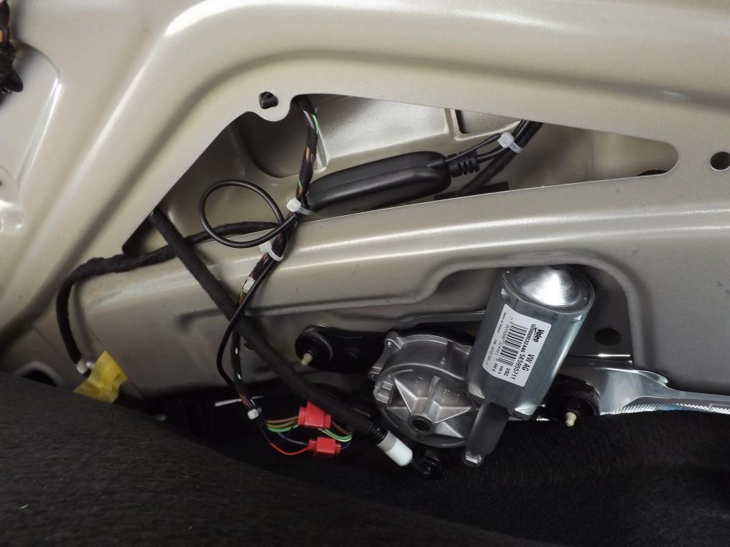

OK, as the weather was good today and the camera arrived on Thu decided to finish the install attached are some pics.

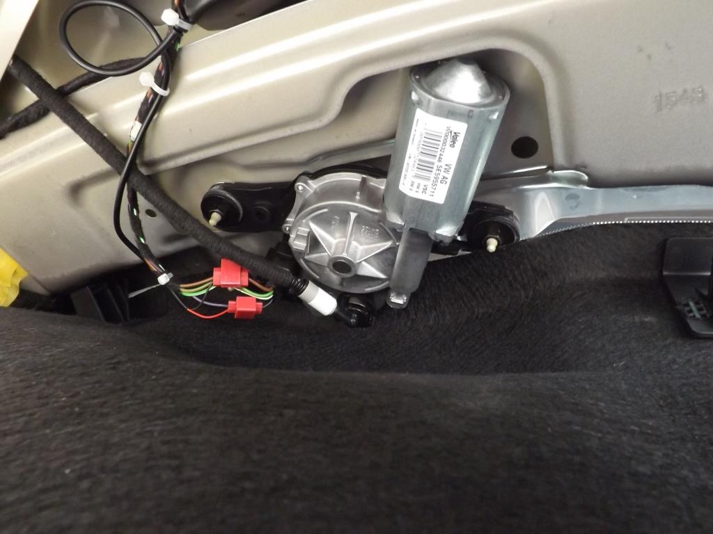

power to the camera and wi-fi module from the rear wiper (only live with IG on)

Wires neetened up

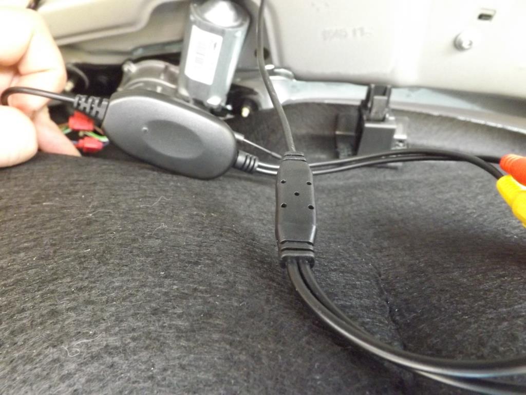

The power and video connections from the camera
wi-fi module tied up

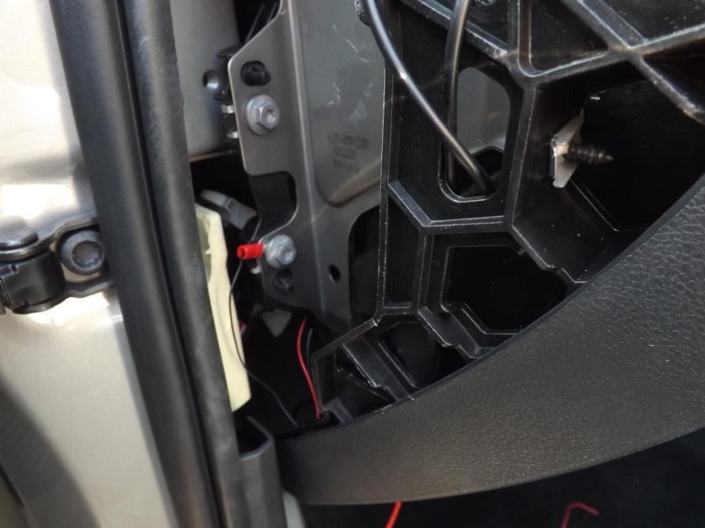

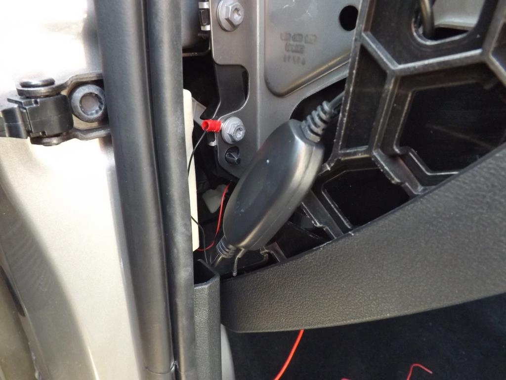

Ground connection for the wi-fi reciever module located behind the panel on the left side of the dash
The wi-fi reciever
The wi-fi reciever tucked away
Fuse location on the board (only live when IG on) and the video in to the MIB

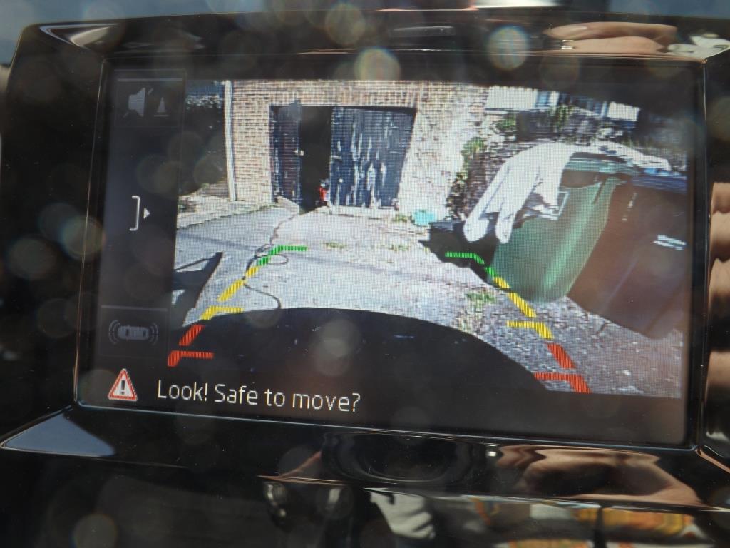

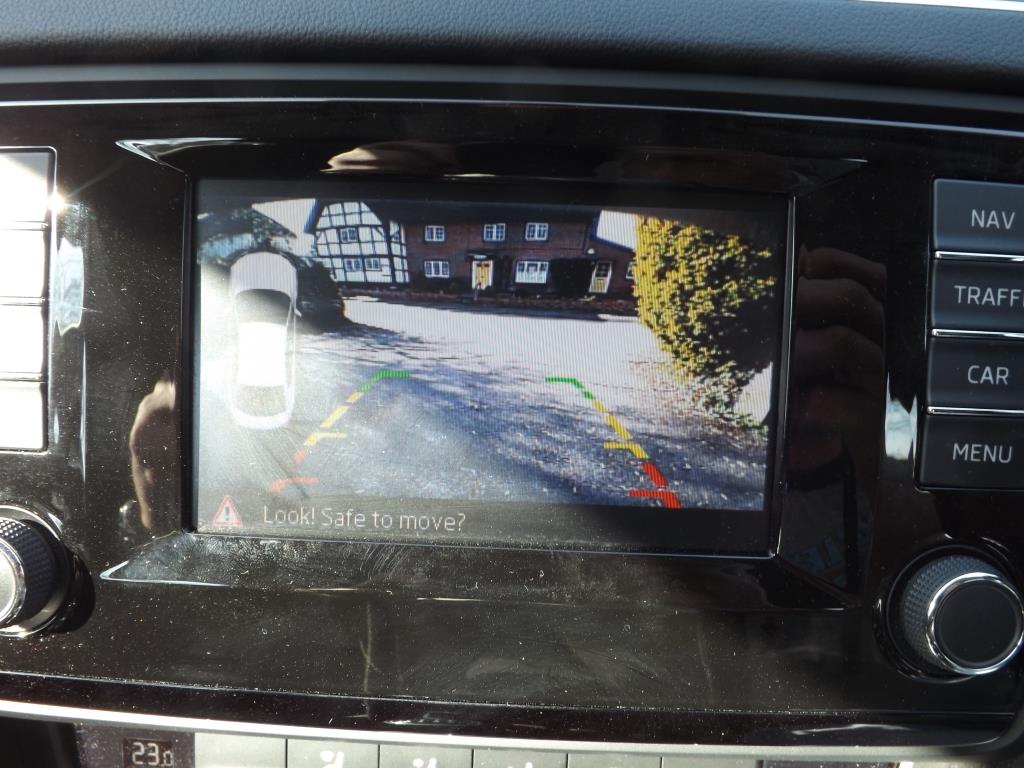

View on display when reverse selected (pre head-unit firmware update)
View of the fitted camera
A closer view of the camera
View on the headunit with reverse selected (post firmware update)
Hope this helps anyone wanting to do this update

Reversing camera works much better with newer HU firmware.
The controls hide automatically and the background is transparent.
With old FW: video
With new (0435 and higher on Bolero/Amundsen): video
You still have to activate the camera with VCDS but FW update is a different thing. :)
