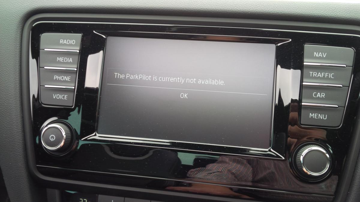

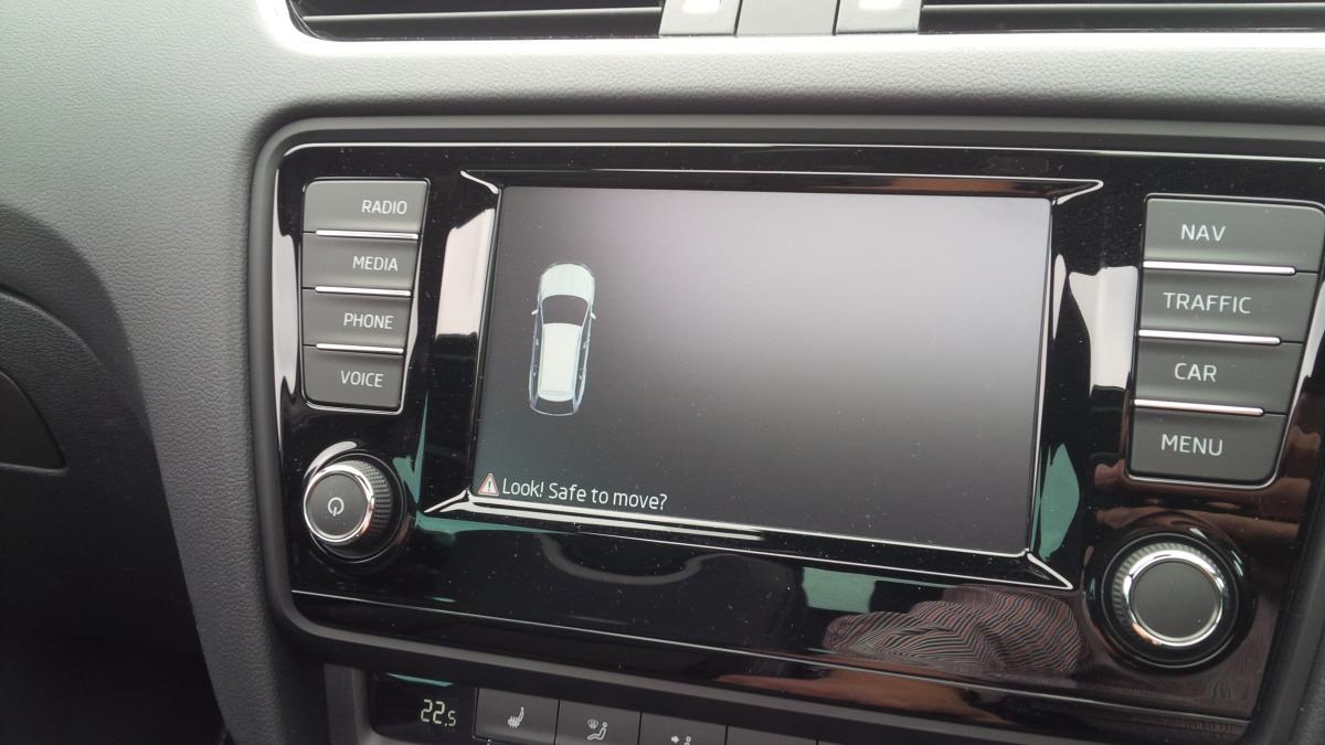

Can I just confirm what coding changes are required on my Amundsen before I do this, I've read right through this thread again, but can't find it.
And is it okay to make changes before installing the camera?
Well, I'm struggling. :(
Installed the camera, changed the coding, thought I had everything connected correctly (took positive and negative from the rear wiper), and then I got the following when selecting reverse:
post-61800-0-24619700-1471893126_thumb.jpg  post-61800-0-15679900-1471893147_thumb.jpg
A scan reveals the following:
Monday,22,August,2016,19:40:27:18343
VCDS -- Windows Based VAG/VAS Emulator Running on Windows 7 x86
VCDS Version: 16.8.0.3
Data version: 20160803 DS255
www.Ross-Tech.com
Address 10: Park/Steer Assist (J446)       Labels: 5Q0-919-283.clb
   Part No SW: 5Q0 919 283 F    HW: 5Q0 919 283
   Component: PARKHILFE 4K  H10 0054
   Revision: --------    Serial number: 39291610604280
   Coding: 0001150011
   Shop #: WSC 73430 031 12345
   ASAM Dataset: EV_EPHVA14AU3700000 002024
   ROD: EV_EPHVA14AU3700000_SK25.rod
   VCID: 3C7C2618B72C00A2BC-8068
Address 5F: Information Electr. (J794)       Labels: 3V0-035-MIB-STD2.clb
   Part No SW: 5Q0 035 874 A    HW: 5Q0 035 874 A
   Component: MU-S-ND-ER    H25 0245
   Serial number: SKZAZ2S5040473
   Coding: 03735201FF00000011111201008800002F0201D601208100C6
   Shop #: WSC 73430 790 00063
   ASAM Dataset: EV_MUStd4CTSAT 001022
   ROD: EV_MUStd4CTSAT_SK26.rod
   VCID: 326008206568C6D266-8066
6720 - Rear View Camera
          B1102 31 [009] - No Signal
          Confirmed - Tested Since Memory Clear
             Freeze Frame:
                    Fault Status: 00000001
                    Fault Priority: 3
                    Fault Frequency: 1
                    Reset counter: 236
                    Mileage: 6535 km
                    Date: 2016.08.22
                    Time: 19:17:24
                    Voltage terminal 30: 12.1 V
What have I done wrong?!
Thanks in advance...
The headunit probably needs a (force) reboot. Press and hold the POWER button for 15-20 secs.
Fault code is interesing, what byte/bit did you change?
