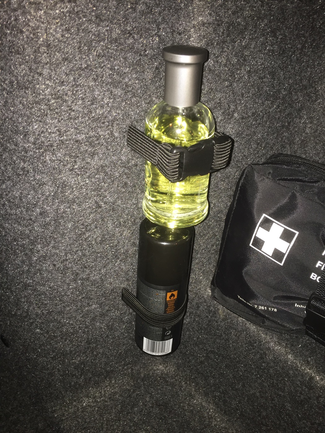

new feature, simply clever ;)
Two little straps in the boot are perfect for some deodorant and boss aftershave.
Gotta freshen up after a round of golf lol :)

Two little straps in the boot are prefect for some deodorant and boss aftershave.

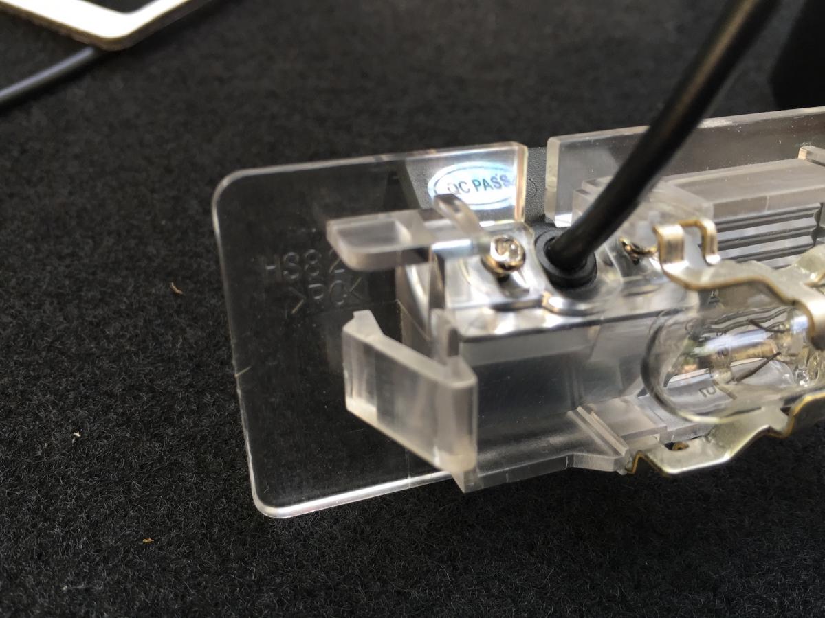

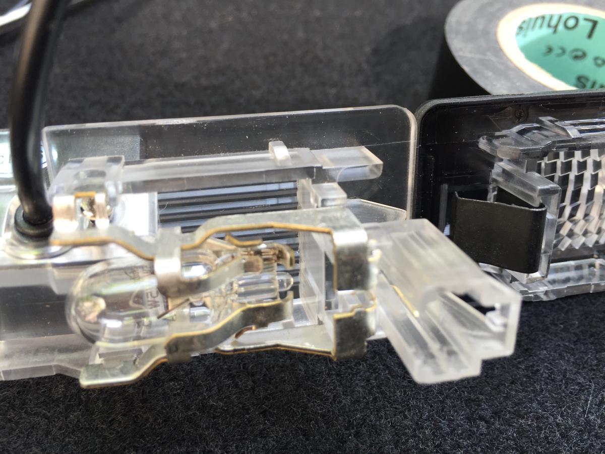

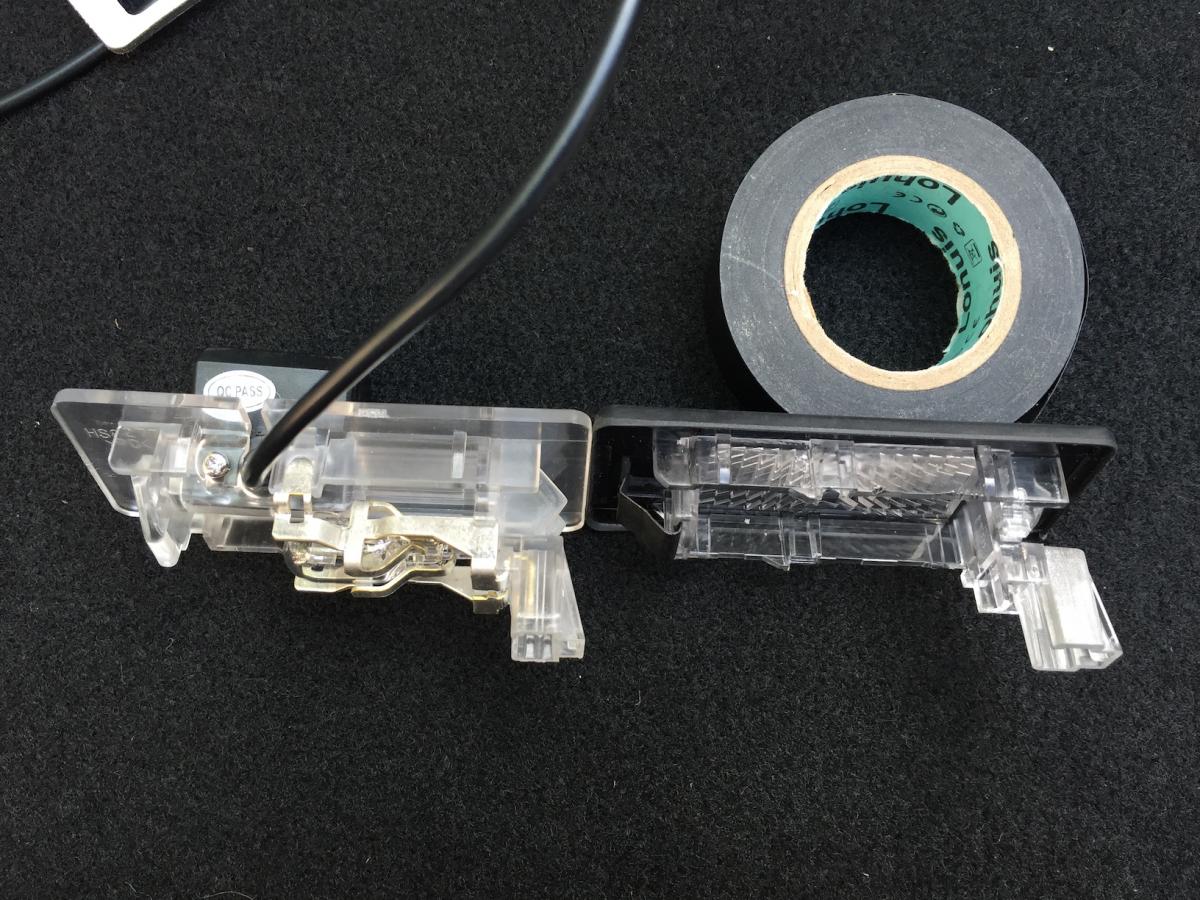

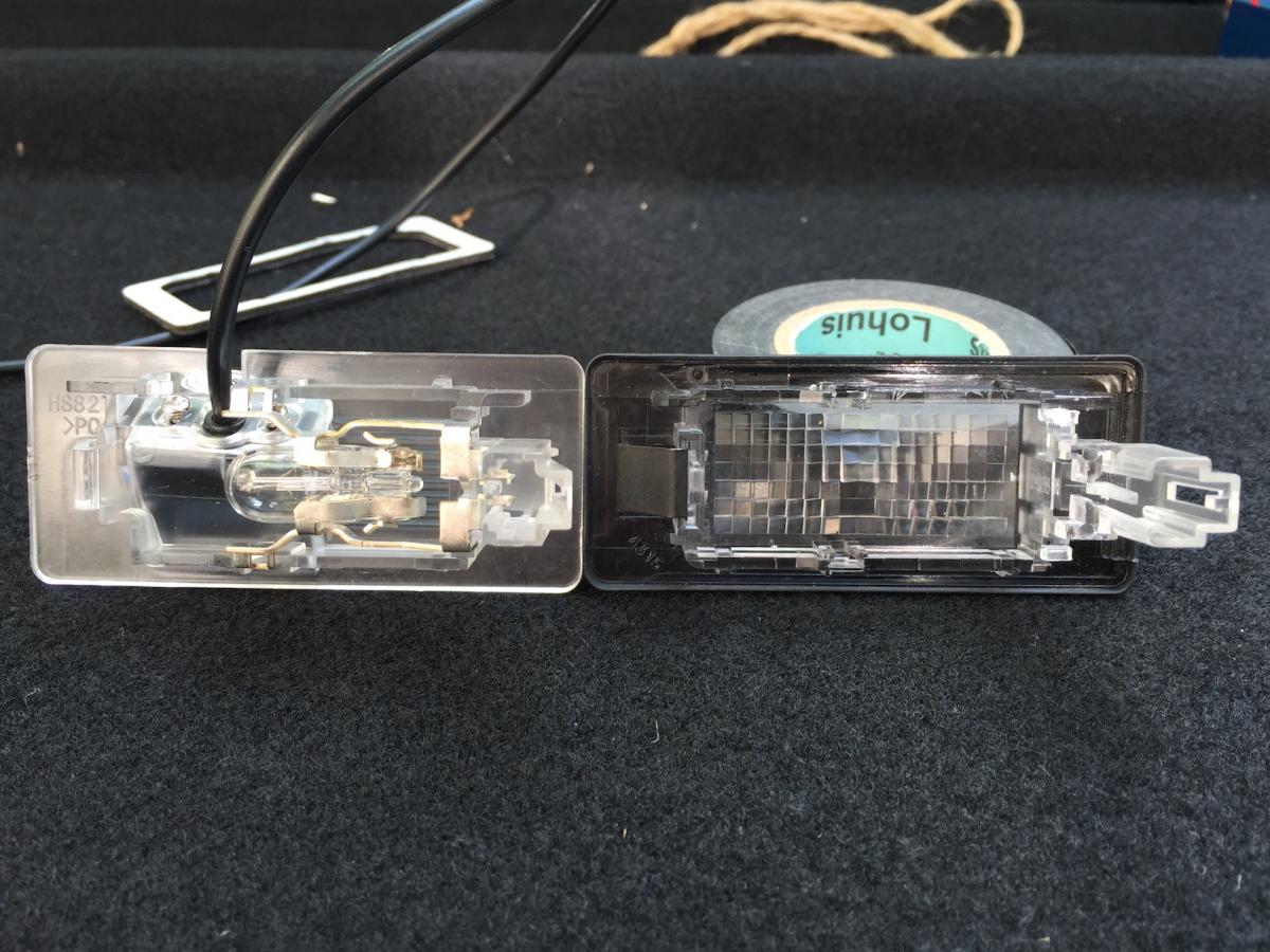

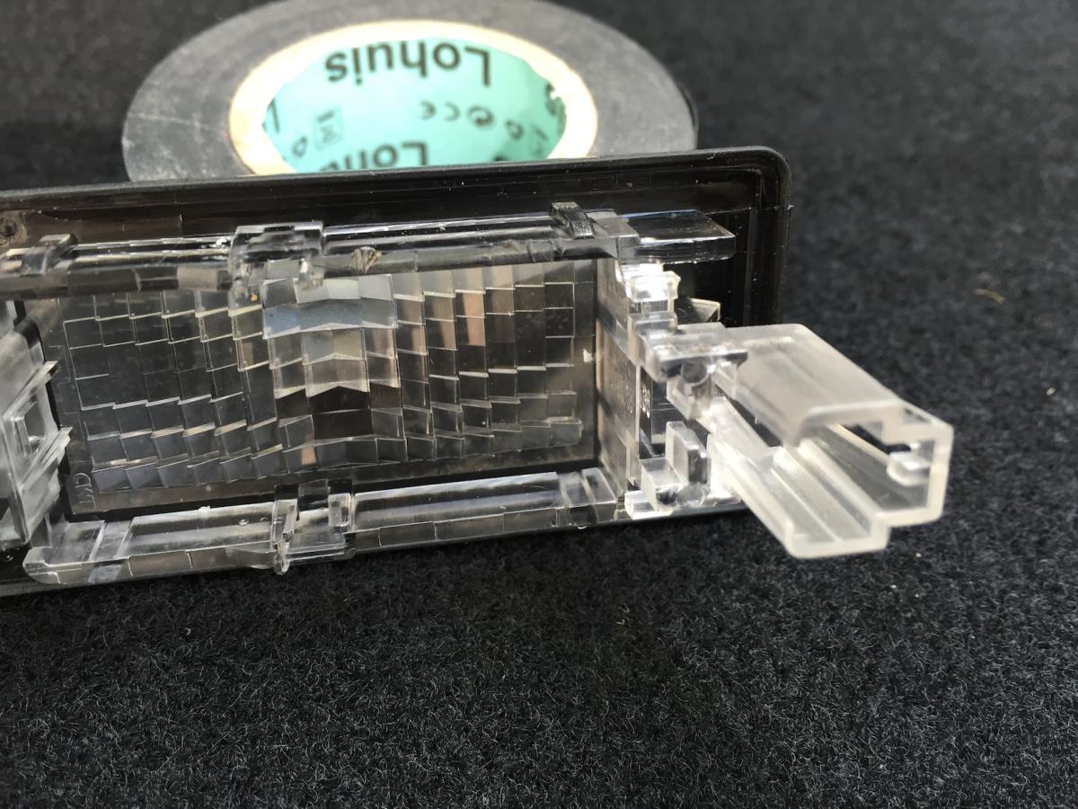

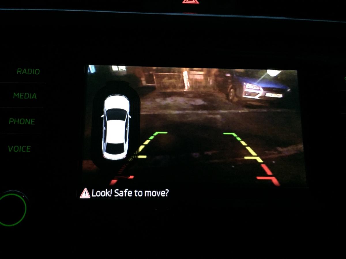

I have purchased the first one, and it has arrived just yesterday.
One thing to notice is that the camera light does not come with the metal bulb holder, witch i had to get from the original light. Not a big deal, as it is done in under one minute.
I installed the camera with the light bulb in place, just to see if it fits, and it is about 95% the same size as the original one. It does have a small wiggle, but in all fairness, it comes with a double sided adhesive tape that should hold it in place and make it water proof.
I am planing to install the wires by the end of the week, and should be able to post some pics by then.
Regarding the 108, i would think it will not fit, as the inside edges are of a bigger size that the one i bought. Also, the mechanism seems a bit different.
You can however do some test by removing your light and measuring the hole.

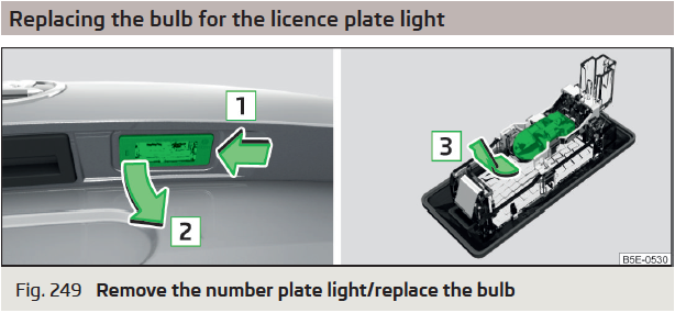

For those who do not know how to remove the light, please have a look at the attached picture from the manual.

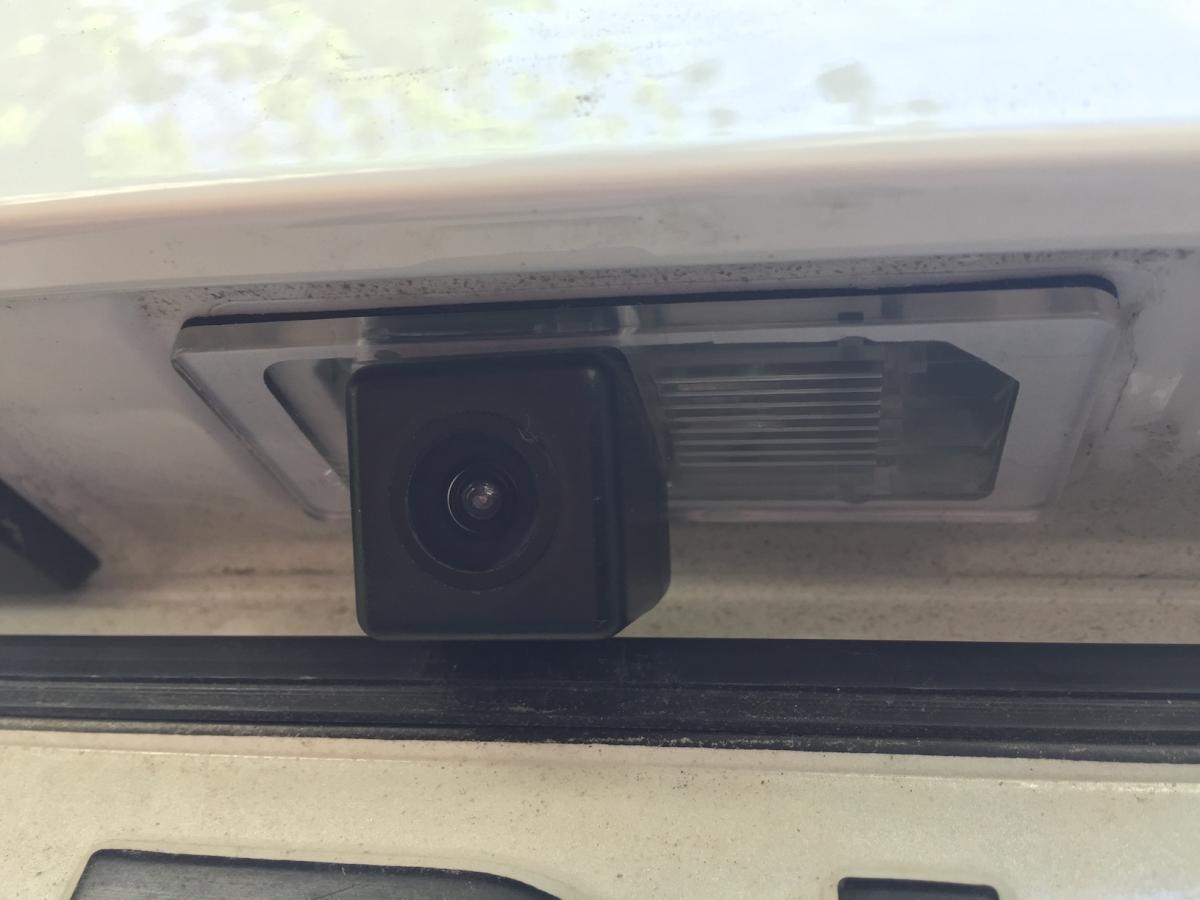

Challenge accepted and completed :)
The installation went very smooth, i got the power from the rear wiper, and did not have to deal with the 12v coding for reverse light.
After using the double sided adhesive tape the product was held firmly into place. No more wiggle.
By comparing both products, i can say that the only difference from the original one, is the metallic spring that holds the light, witch in the purchased product is made of plastic.
To answer norsko, i did buy a license plate and realized that is not worth puncturing the boot.
Also, in my case, i went to a dealership and asked about the camera, and they said that an original camera cannot be installed on my car ( possibly because in the octavia configurator you need to upgrade to columbus or amundsen to add a camera), and an after market one would cost about 500 EUR + labor.
And finally, an original camera costs between 100 and 300 EUR (for the high line) on ebay, and i got this at 10% of that cost.
Photo with the camera picture please. :)

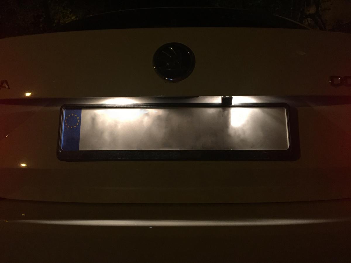

How does your license plate lighting look like now? Isn't assymetric?

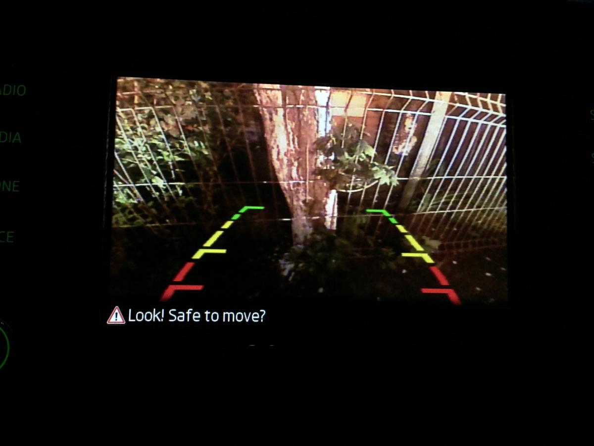

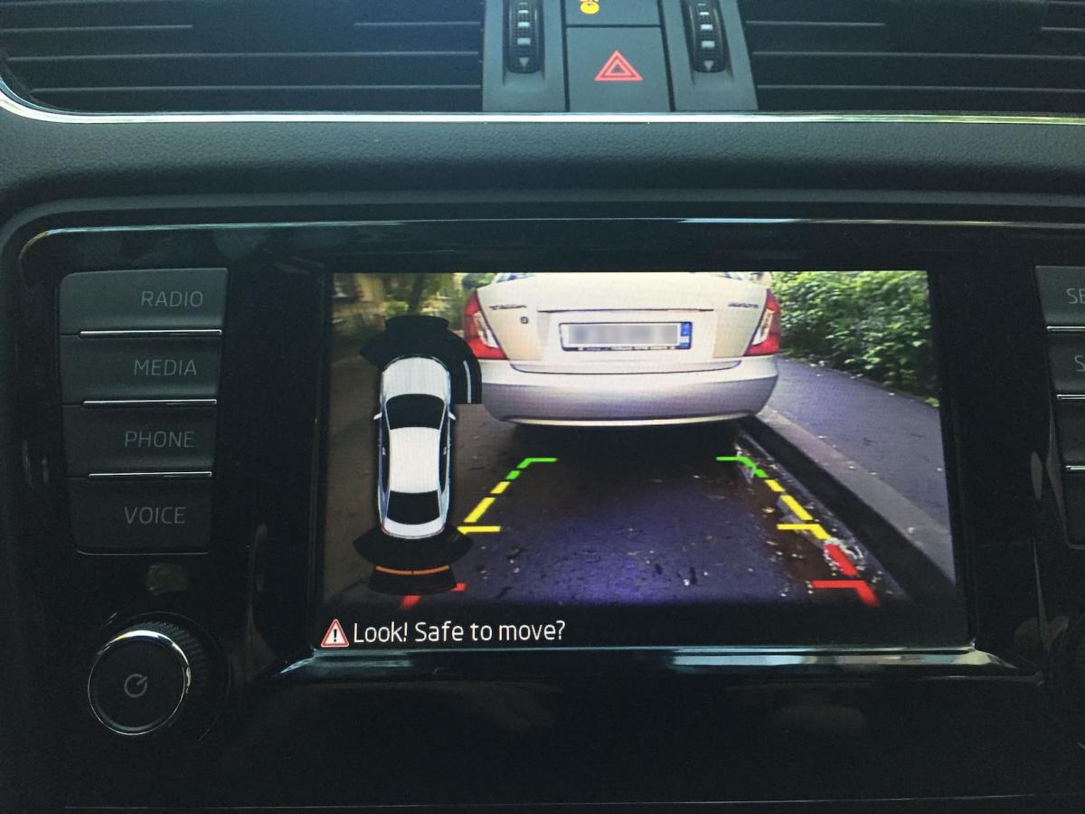

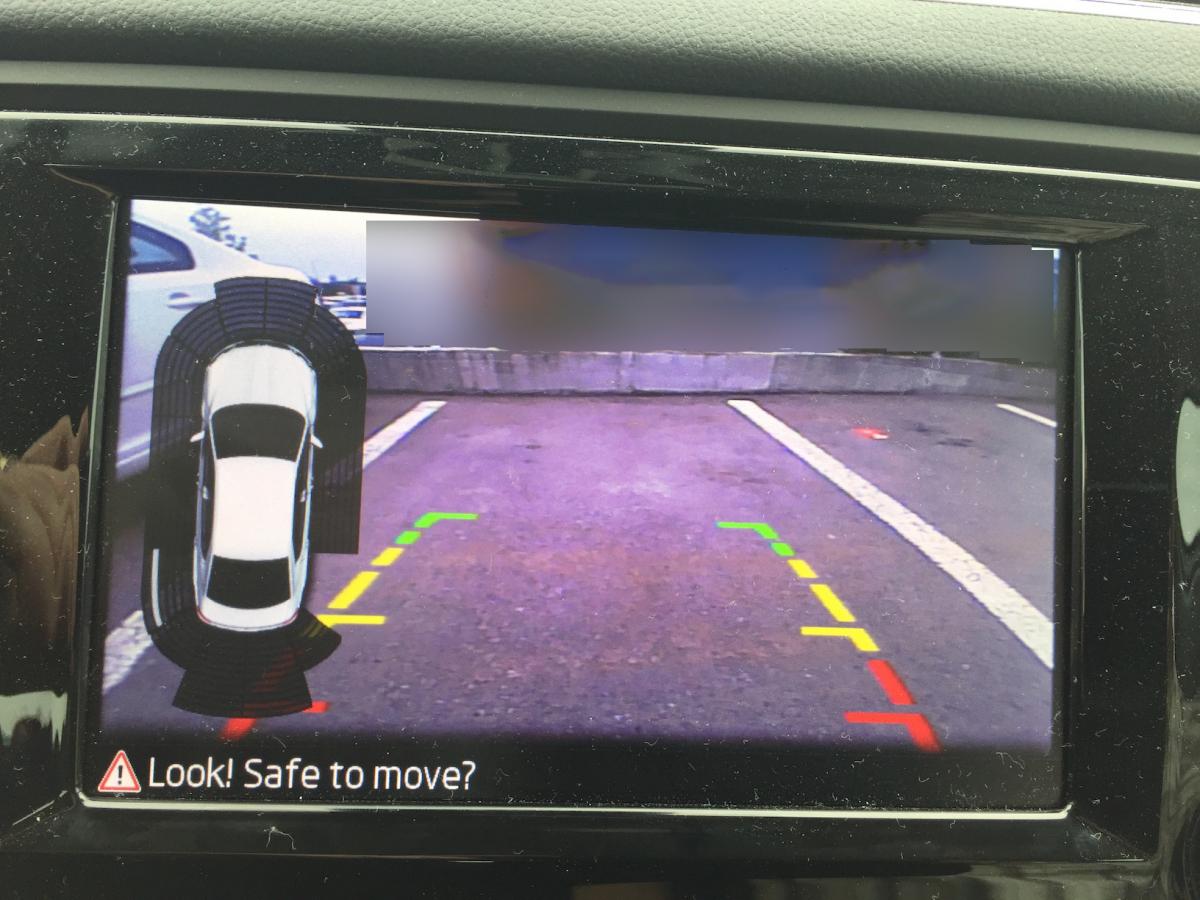

Image is good enough  even in the night.
The only two problems i have are:
 - cannot see the bumper in the video feed, it is covered by the overlay : Look! Safe to move ?
 - image is slightly to the right due to it's location
The illumination of the license plate is a bit asymmetrical, but something i can live with.
I edited the license plate photo to remove the numbers , but it reflects the real illumination.
Also, it would be nice to have the option to activate it without engaging reverse.

Looks good, as your camera is on the left I would have put it in the left number plate light position as then the camera would not have obstructed the light

I really don't mind the light issue, the plate is readable at night, and i wanted to have the camera as close to the middle as possible.
I have the original one and has missed the option to use it without reversing also.
