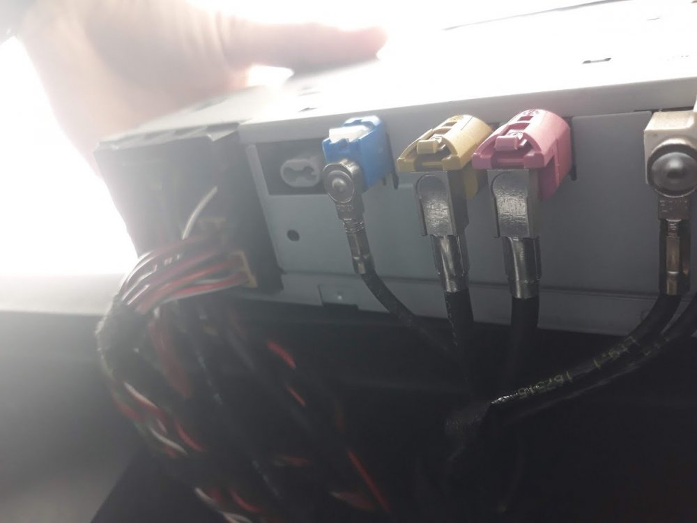

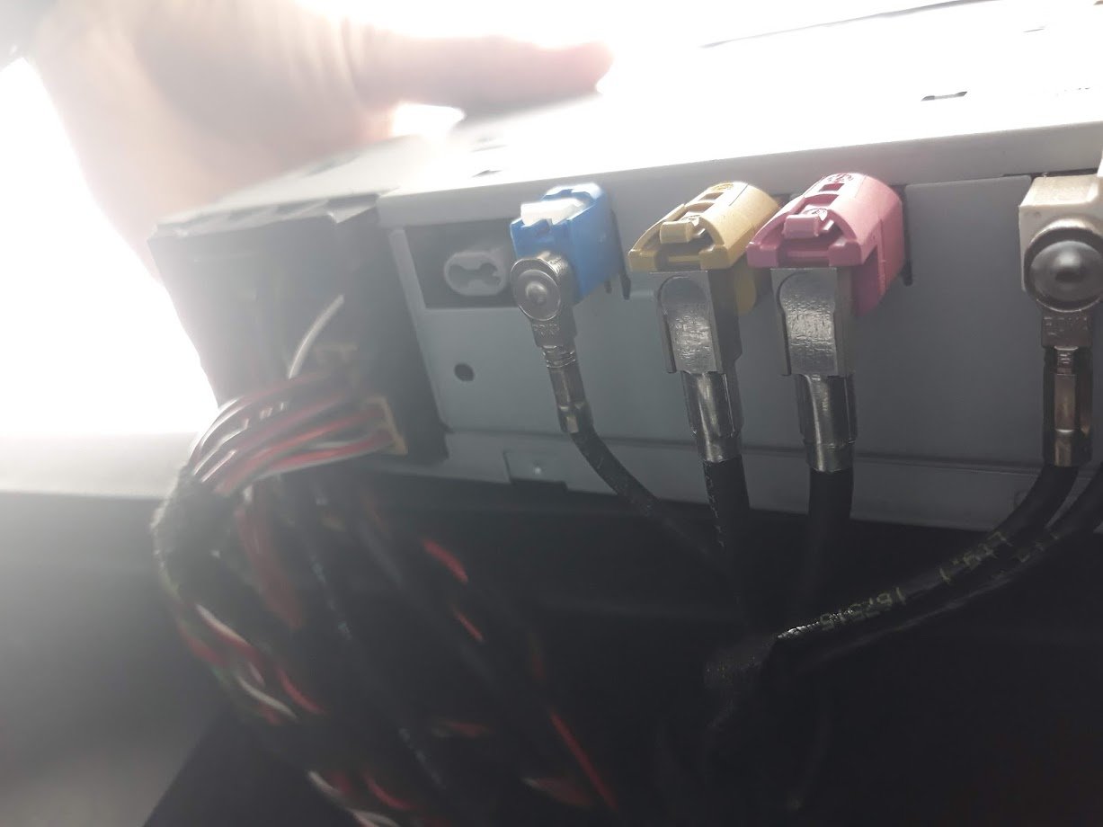

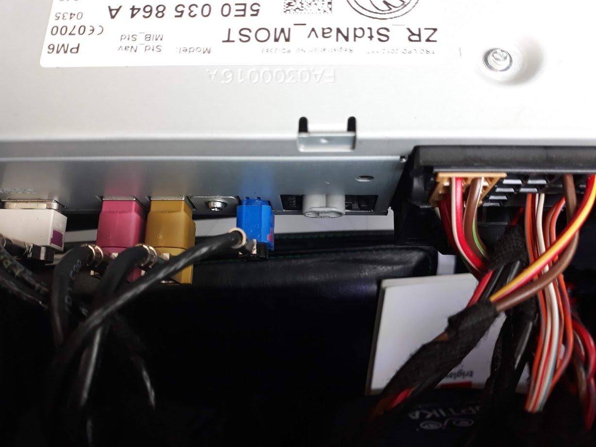

hey.. sorry for bumping up the topic but I am obviously missing something here...
when I removed my MIB1 and amundsen there seems to be no place to plug in fakra cable from the camera, or do I need some kind od adapter / camera module to plug it in my mib 1
here is the picture.. thanx
FBAS1- In+ ==> CVBS NTSC video
FBAS1- IN- ==> CVBS NTSC ground (shield)
But I'm not pretty sure if MIB1 Amundsen, which is your unit, supports RVC at all
it should as I have read..
thanx.. i got it wrong.. now i see that video cable that connects to the camera actually splits into pins that go to blue and green connectors.

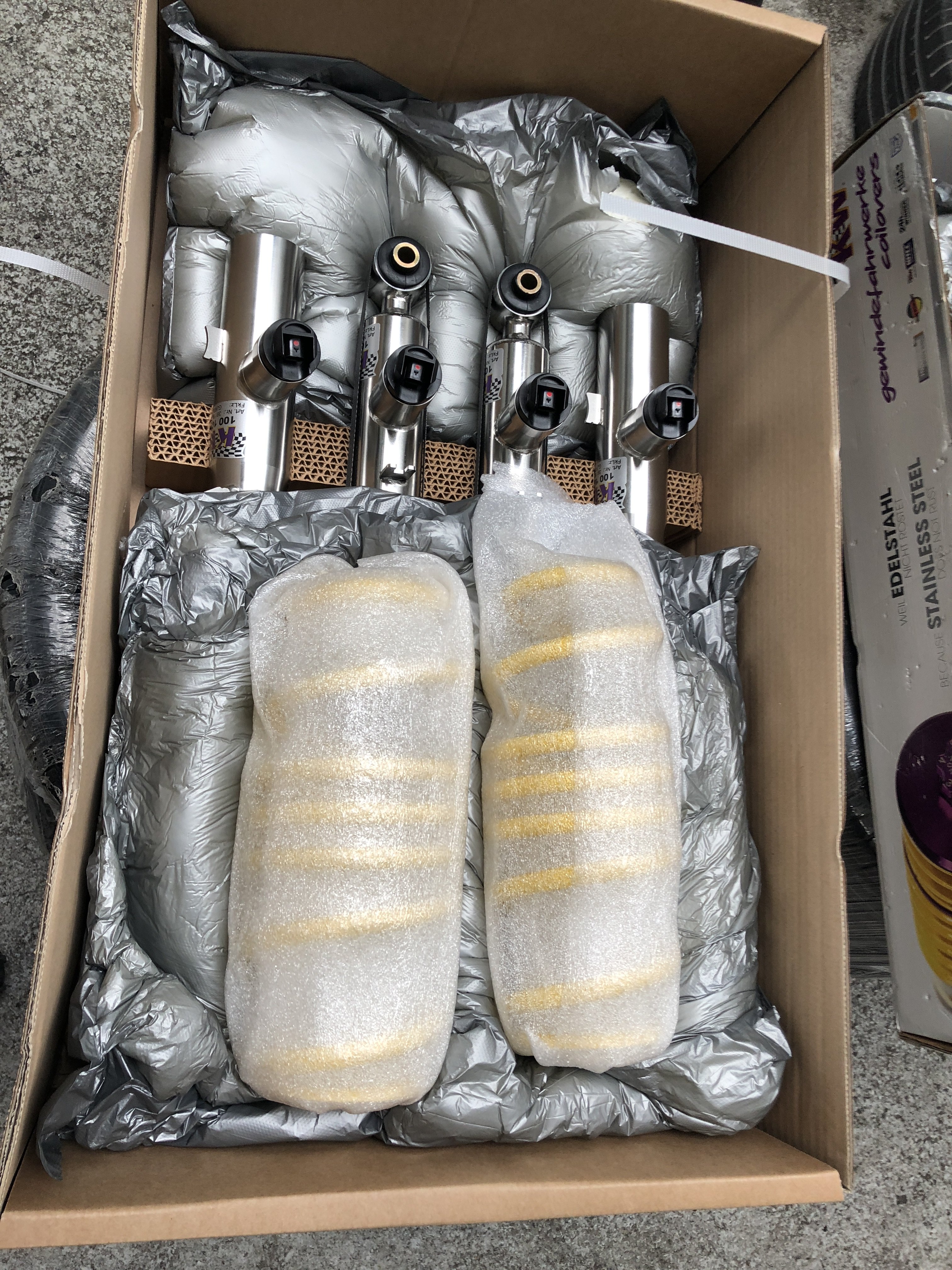

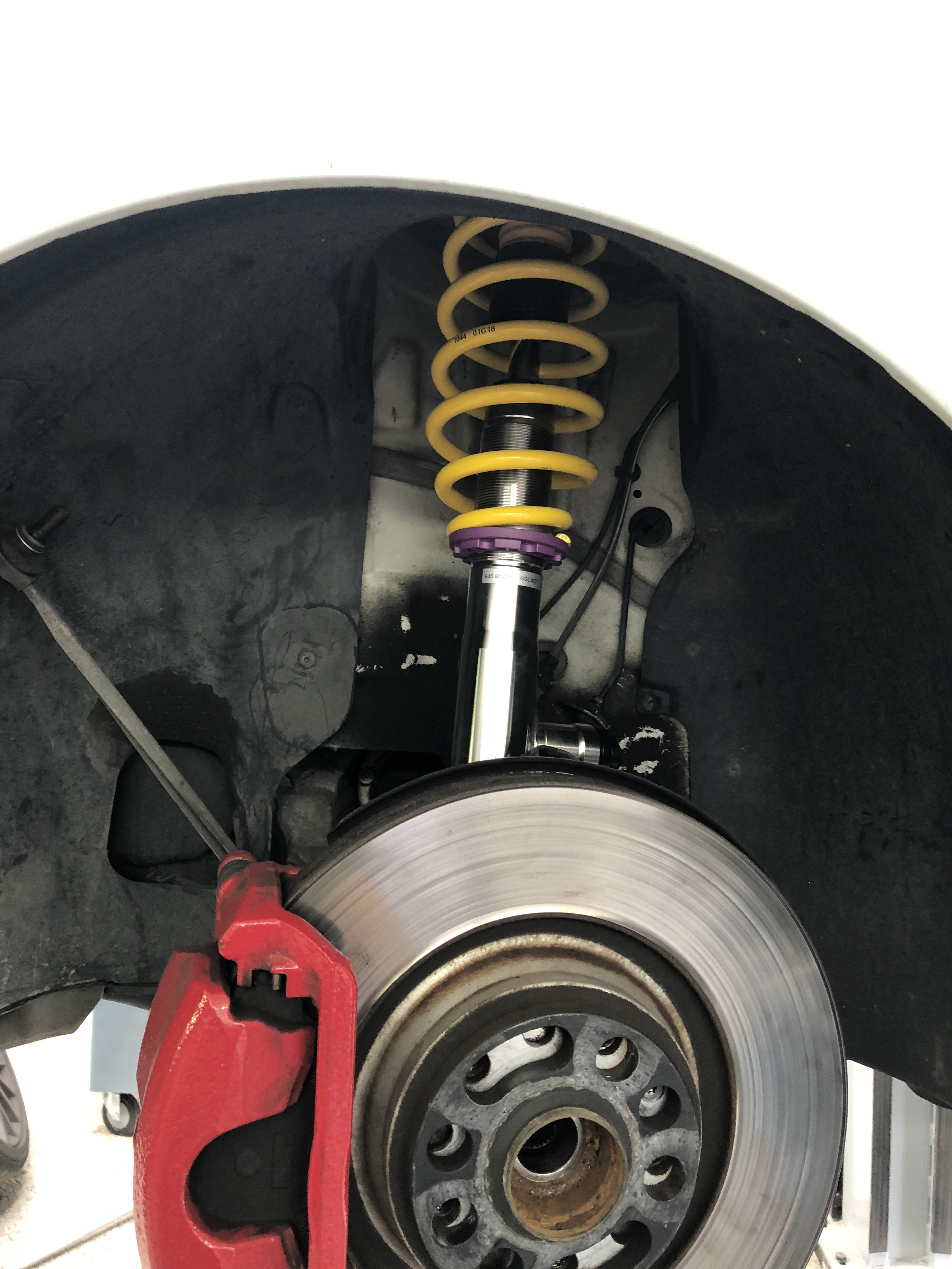

KW DDC Plug n Play, the perfect complement for my retrofittet oem DCC.

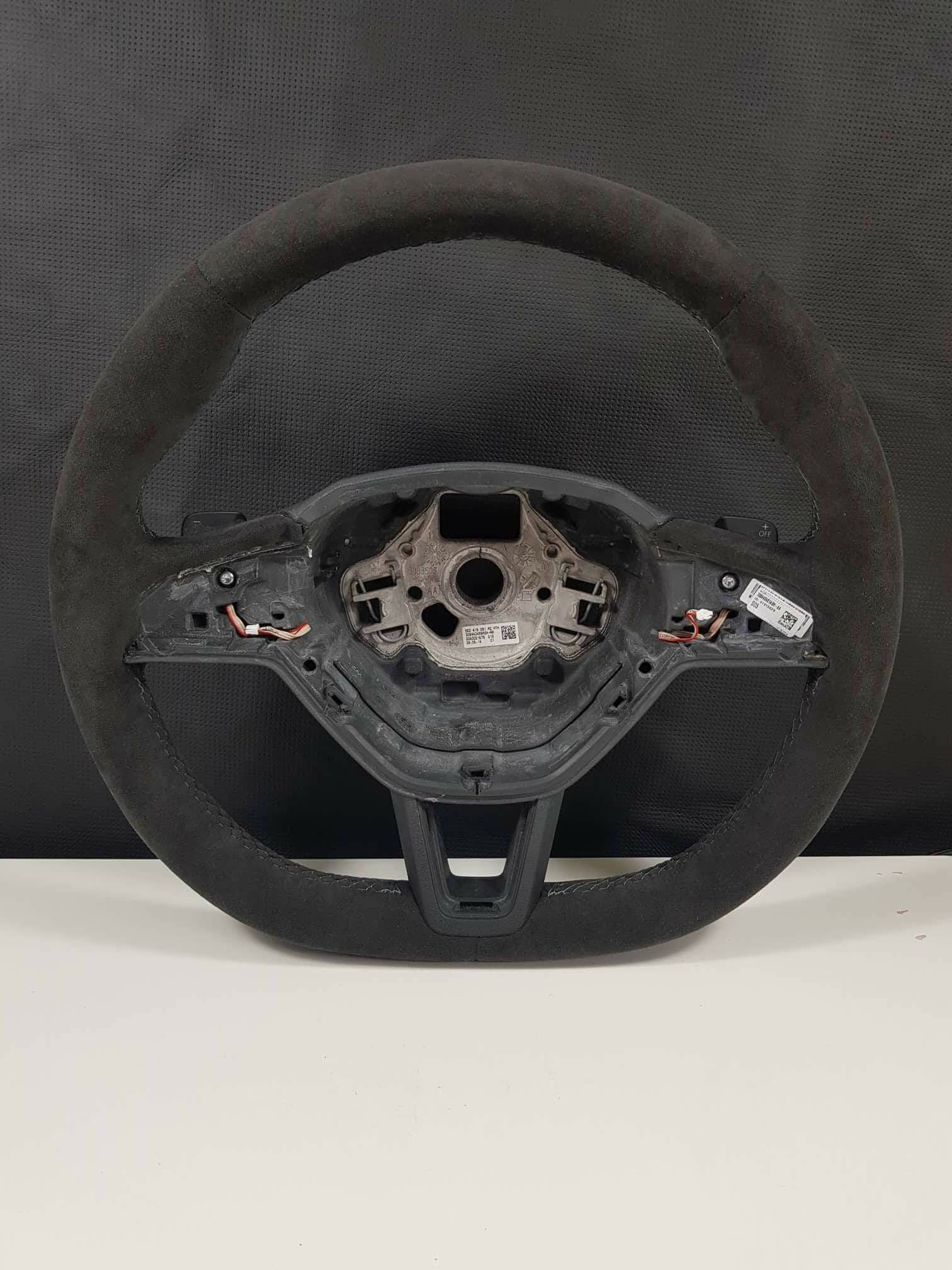

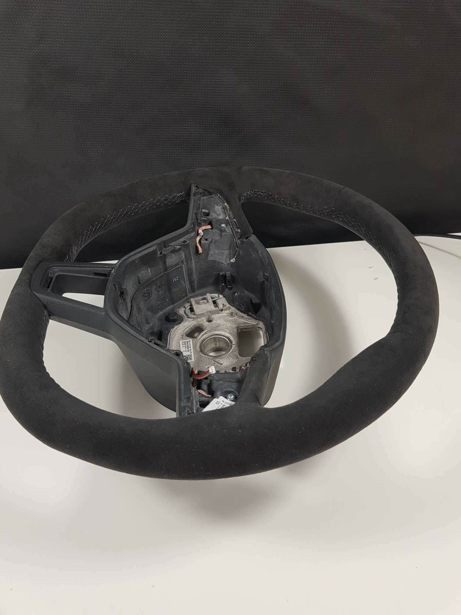

My steering wheel have a ne coating with fine Alcantara.

the pimp master strikes again! i dont think you will ever be done modding your motor. did you reftofit the DCC? how much did it cost?
2 hours ago, Trust2k said:

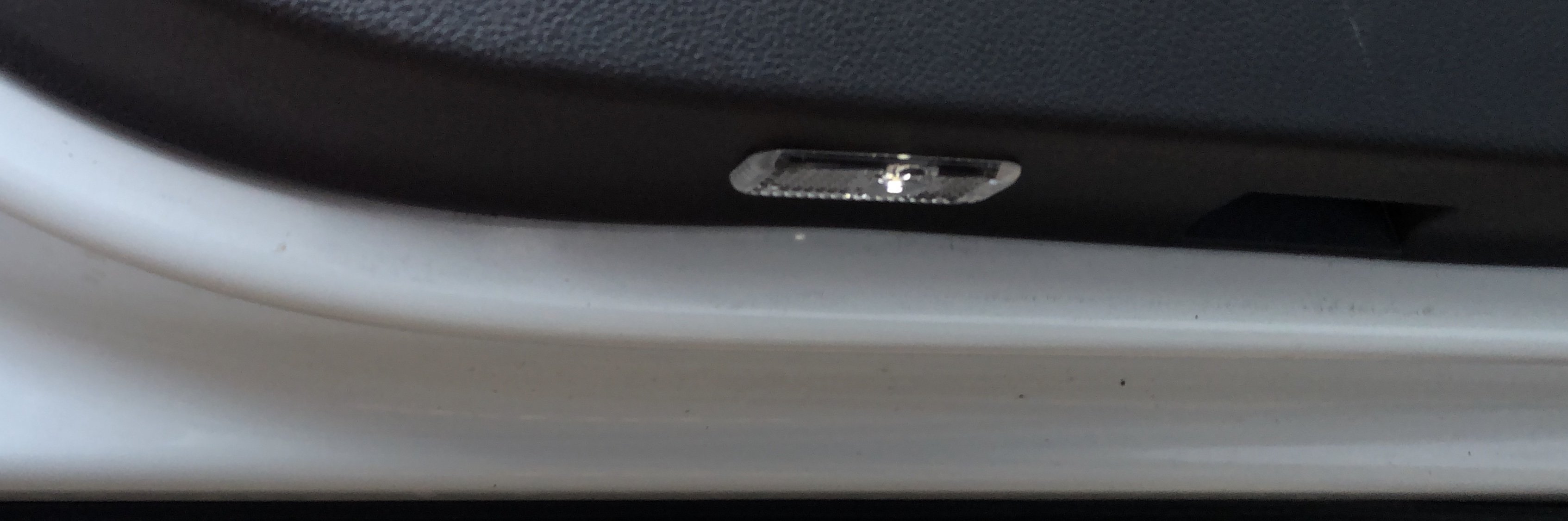

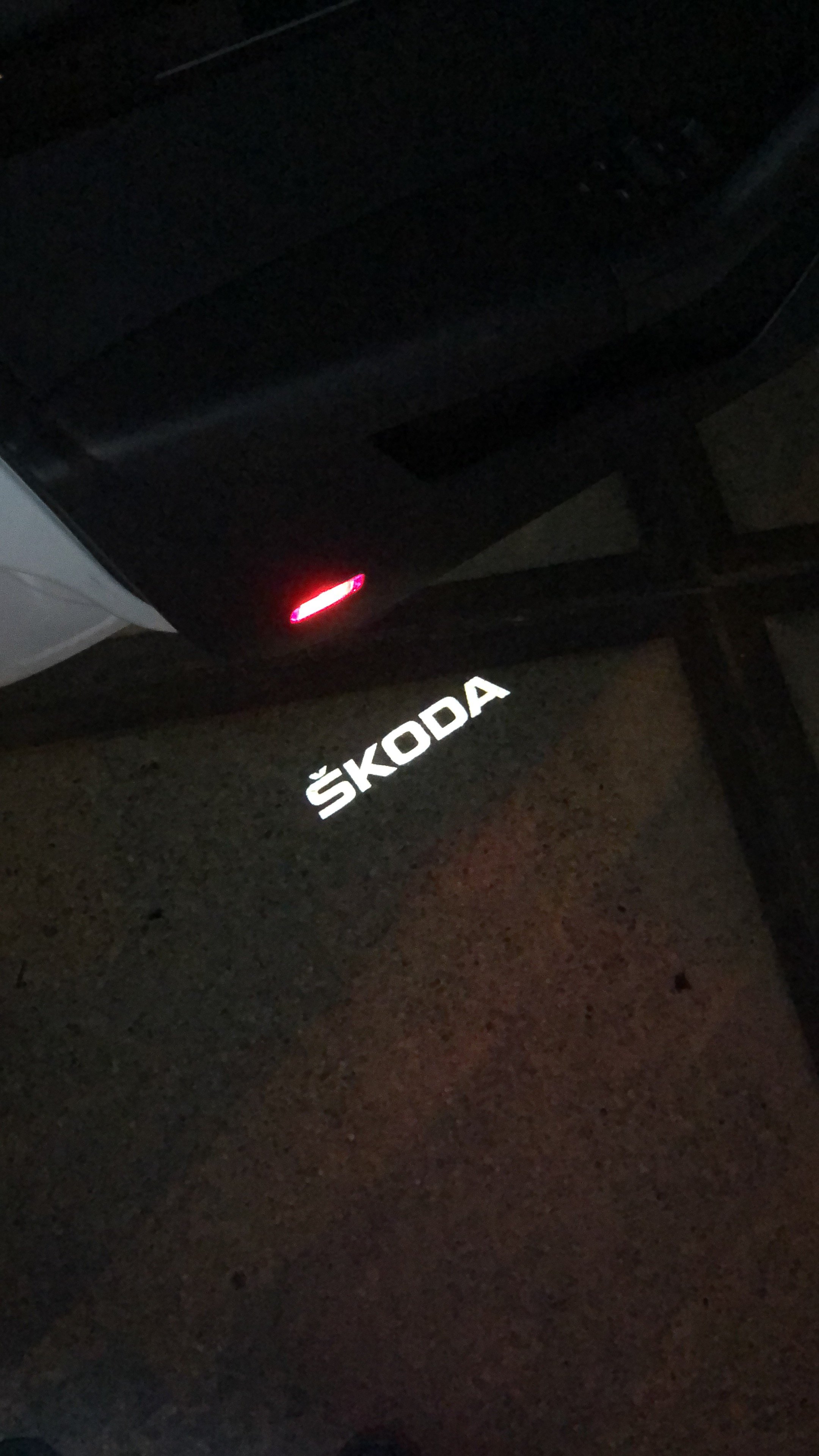

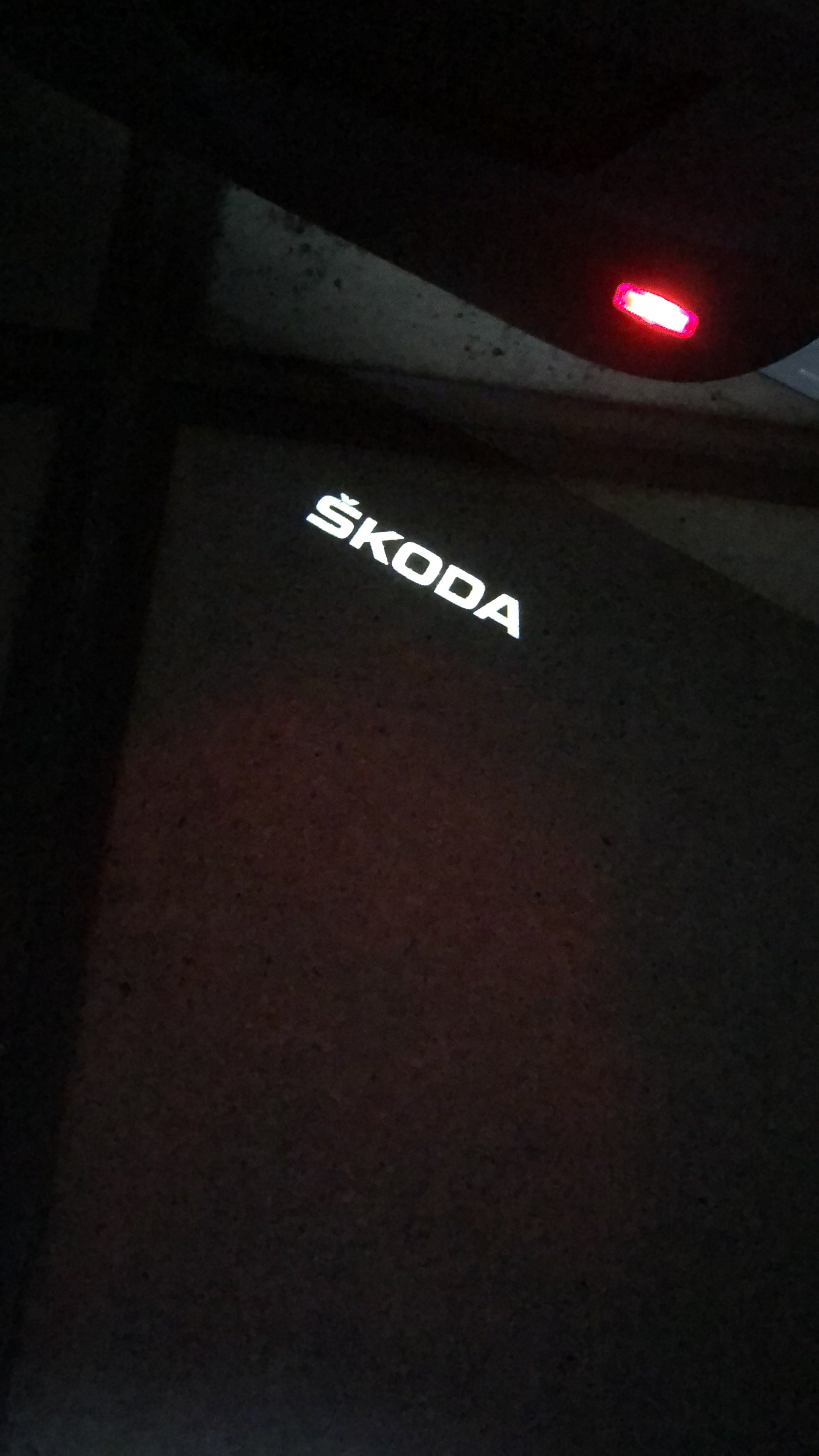

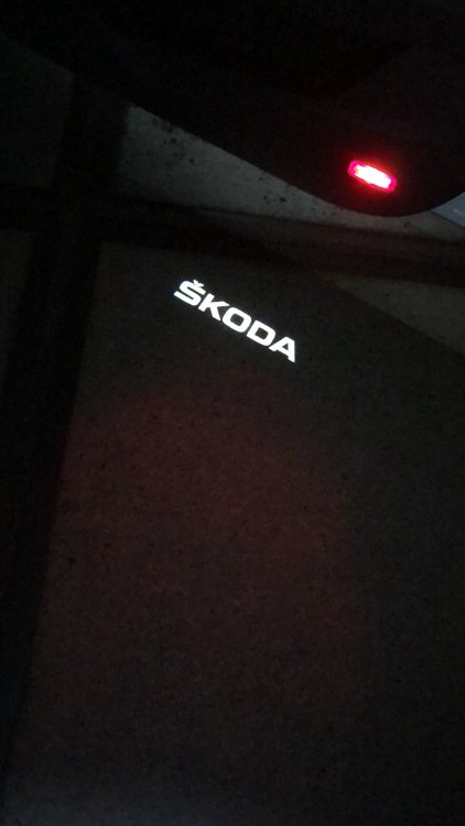

Skoda Laser Logos from Karoq
i like this one have you got any notes up yet on where to get it and i wonder could the image be changed? vRS im thinking.
the laser logos are from the Skoda Karoq ( OEM) , DCC retrofit cost a lot of time and i think maybe nearly 1000€ with used parts.
