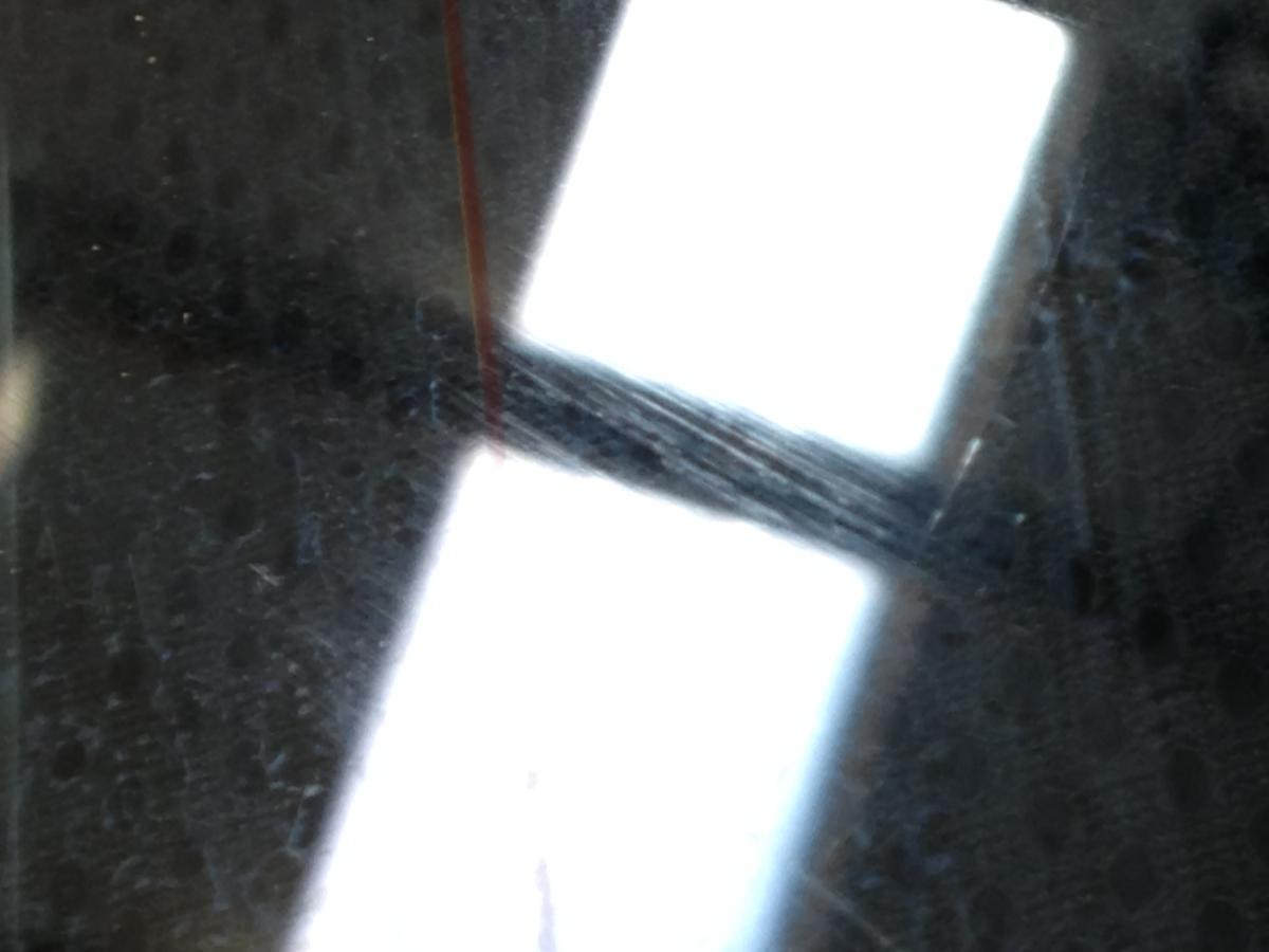

You'll have to take my word for it as I was to excited to get to work with it, to of taken pictures of the wiper marks but rest assured the vast majority have gone. To give an idea of how effective this product is, i'll show you a couple of before and pic's of a deep scratch I had near the bottom of windscreen.
Quite a deep scratch, deep enough that you could feel it with your fingernail. So after much effort and quite a bit of focus on this particular area this is how I left it.
Not completely gone but far less pronounced than it was.

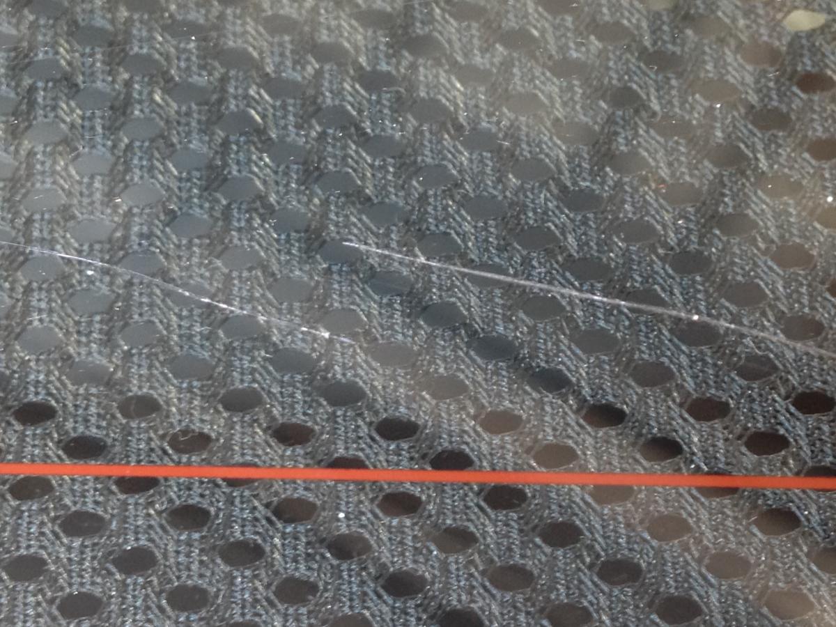

For the sake of removing deeper scratches then that will take a bit more patience. Here's a pics attached of my rear screen with a nice deep scratch  plus some of the rear wiperblade scratches. i'll post more when i've spent a bit more time on it to show you the results.
