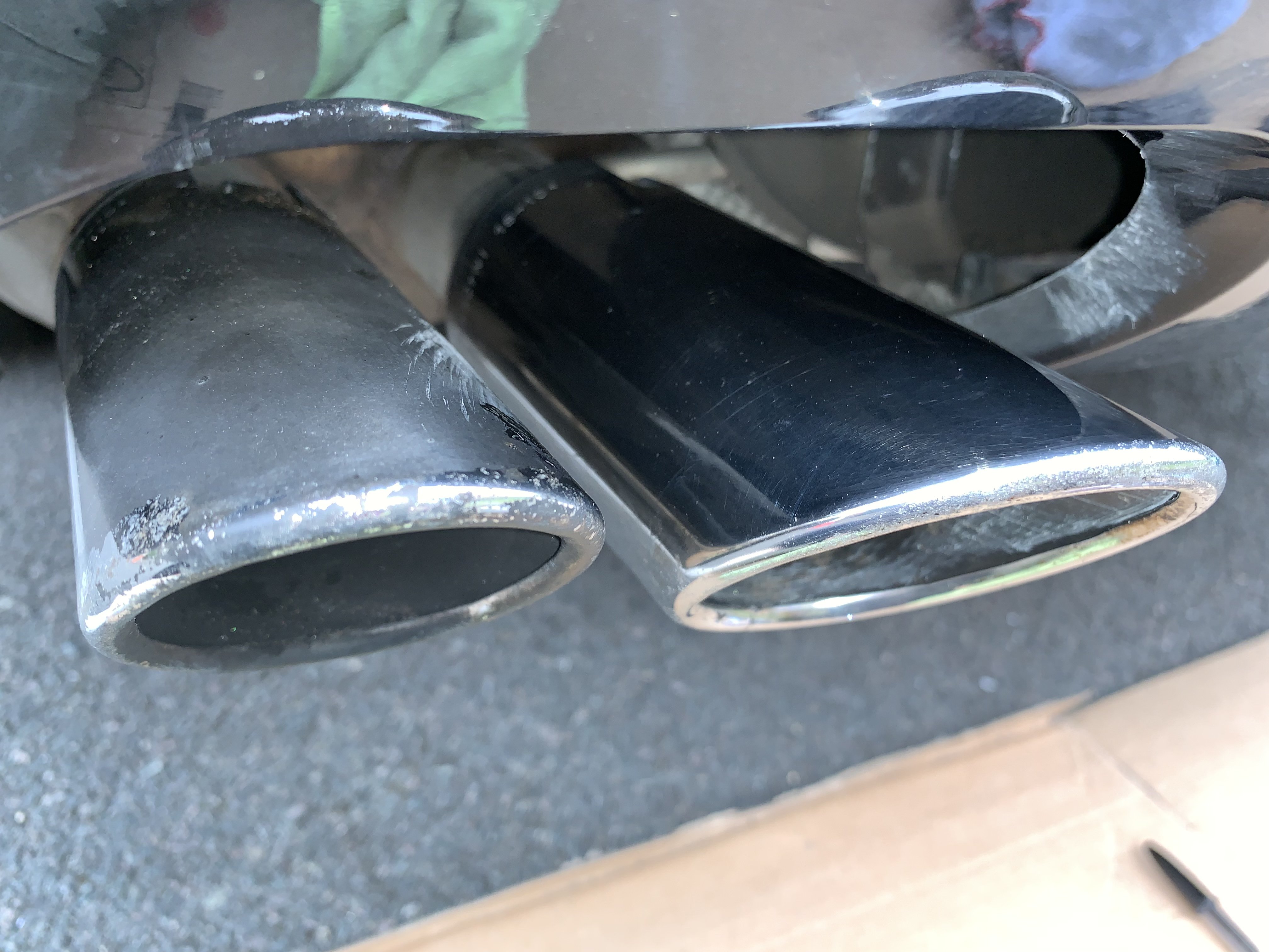

Before (forgot to take a picture so one is halfway done)7DF20E9D-7828-45AF-8A0C-FA57493B48AC.thumb.jpeg.013432a0eab922178ece41a4684fd3e9.jpeg

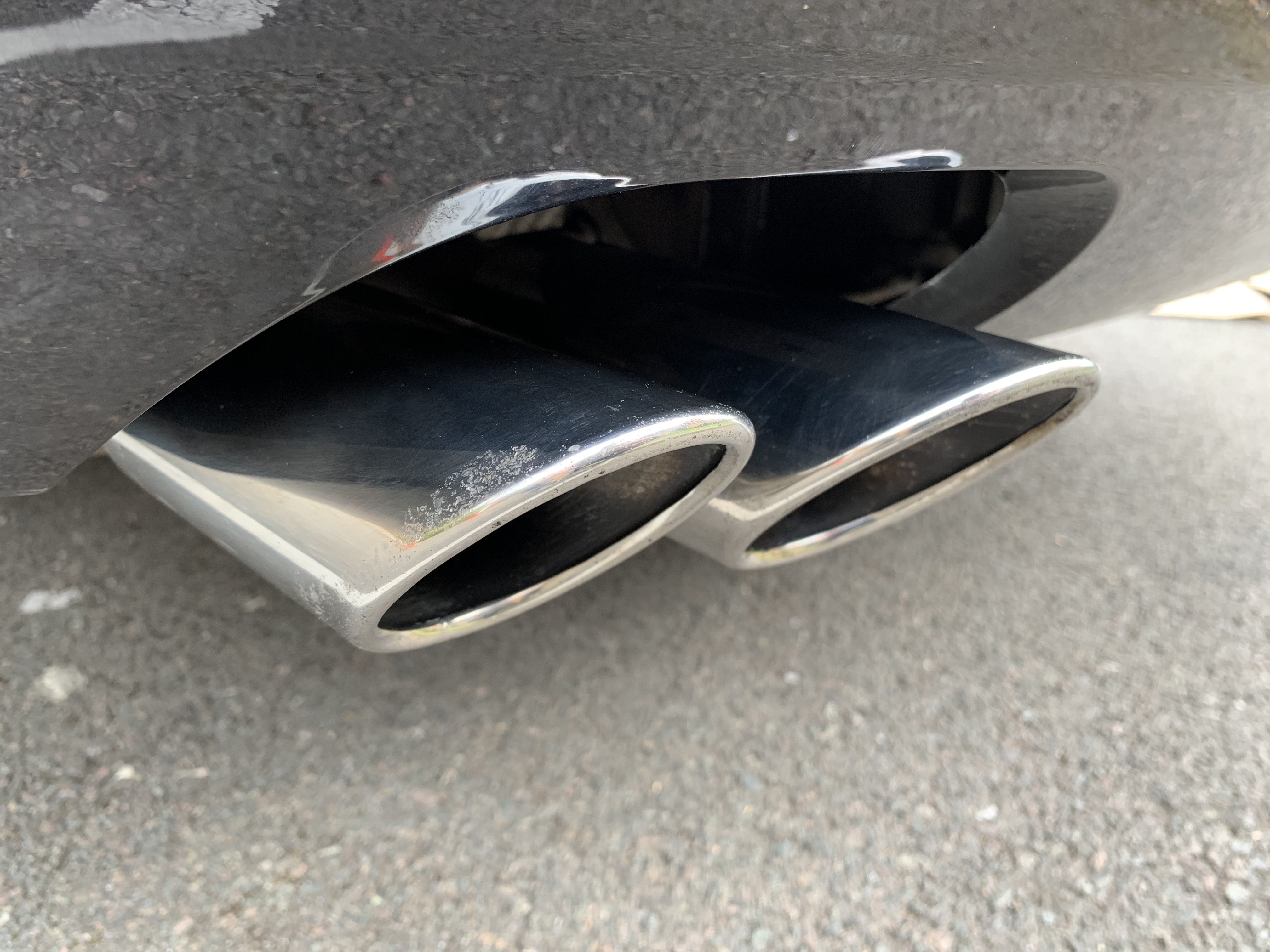

After. Note the pitting still left on the side. Not much I can do about that without some serious tools and effort.
