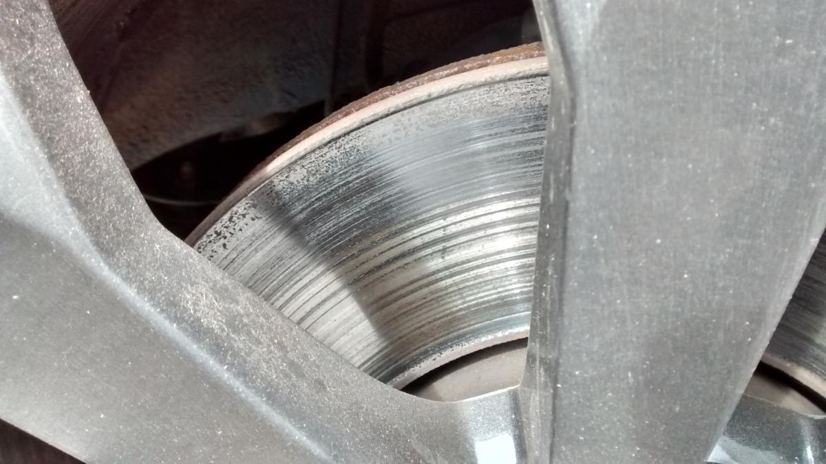

Actually,when you mention it,the edge of the drivers side front disc is a little rusty,I would actually say that the disc dos'nt have that full silver shine if you know what I mean,I'll post a PIC later..
The noise does get a bit louder after a few miles,and when I brake the sound does quiten...

This is what the brake disc looks like...post-36138-0-31460500-1428163512_thumb.jpg
And that's after 12 miles with braking at numerous roundabouts!!

You had best look and see if there is any Brake Material on that pad,
is it not down to the metal?
I just replaced these Discs,  pads still had plenty of meat.

Yeah,there's about 5/6mm on the pads..but question is,is this is where the noise is coming from,it deffo quitens when braking..
