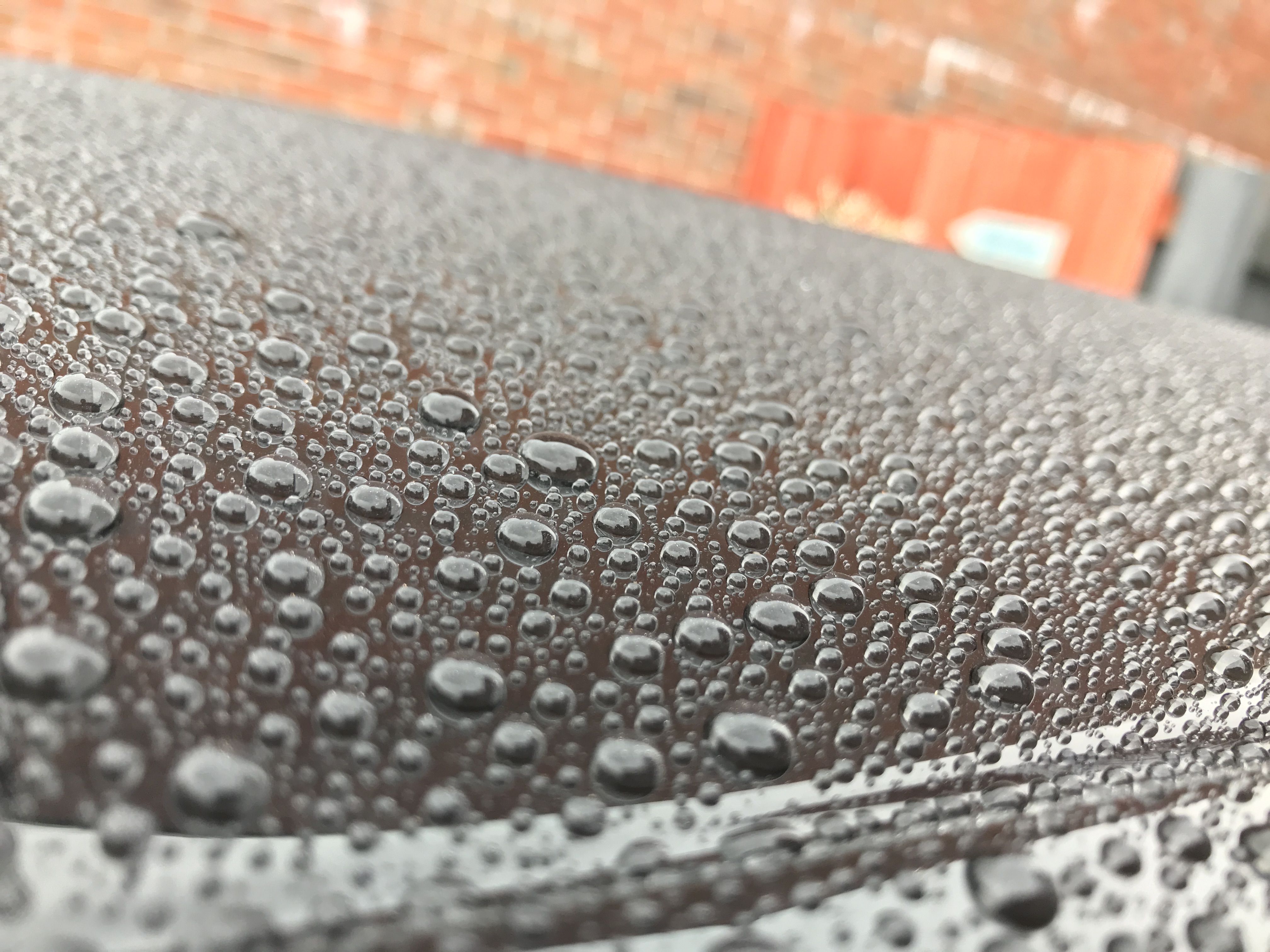

  • Not a detailer by a long stretch but do like to keep my car as clean as possible even though it's a daily run around. Bought some bilt hamber double speed wax and thought I'd try it. Polished with aut

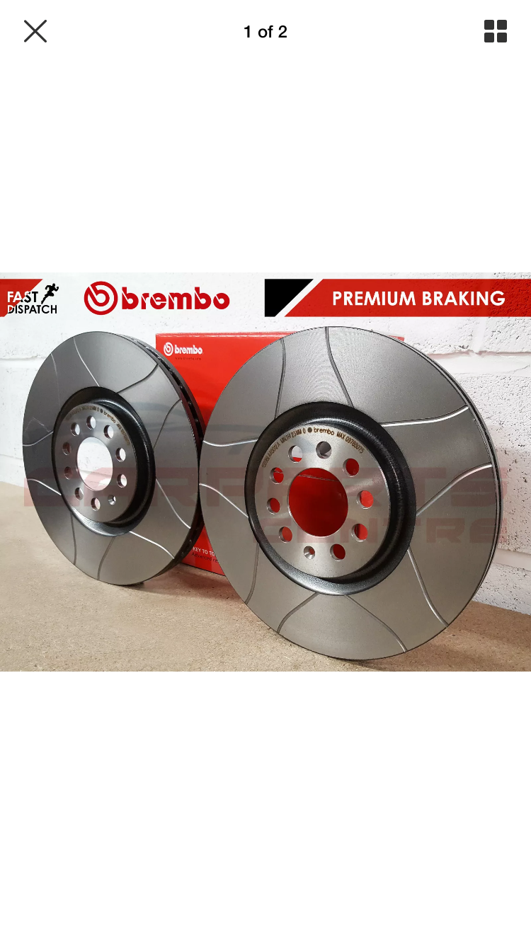

  • More of a what's to come update but still These should be on next month with some freshly painted callipers and carriers. 312mm look quite big in person on a small car. Can't wait !

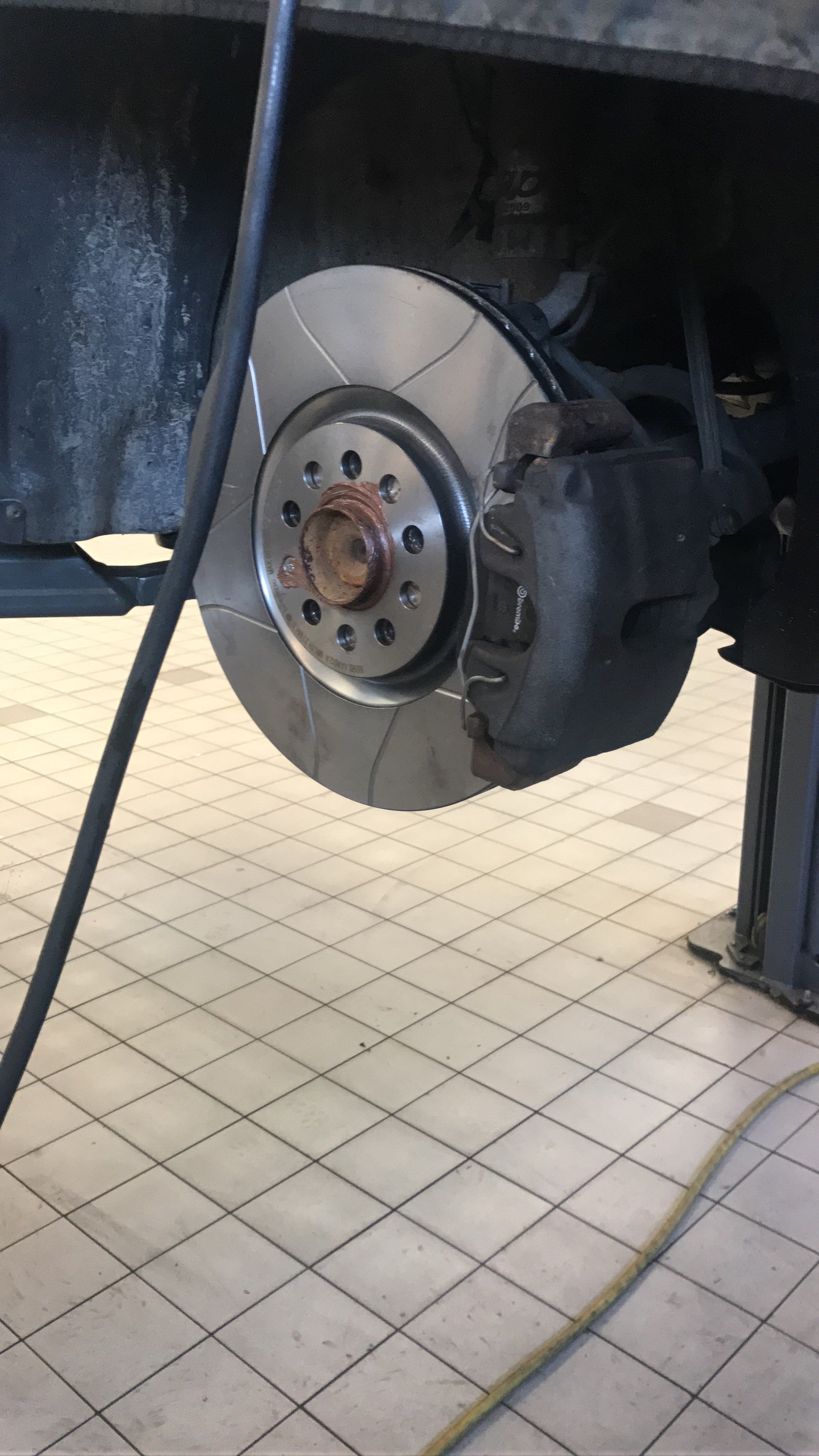

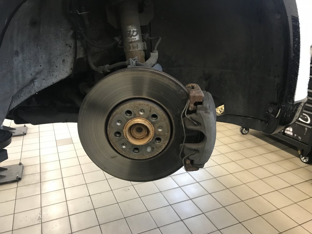

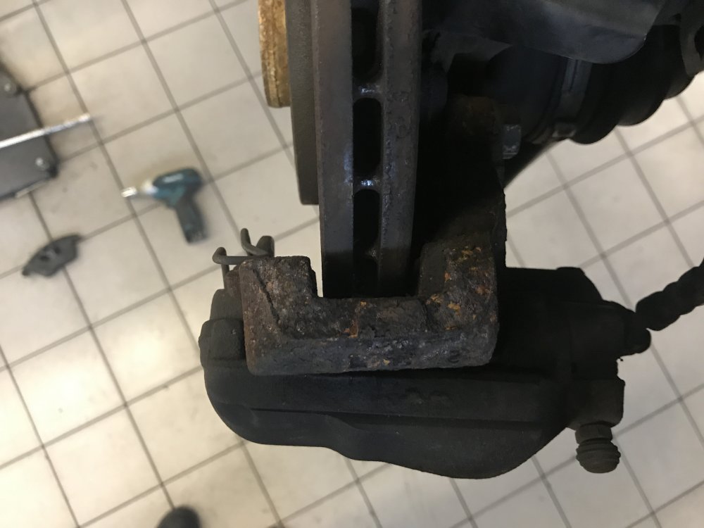

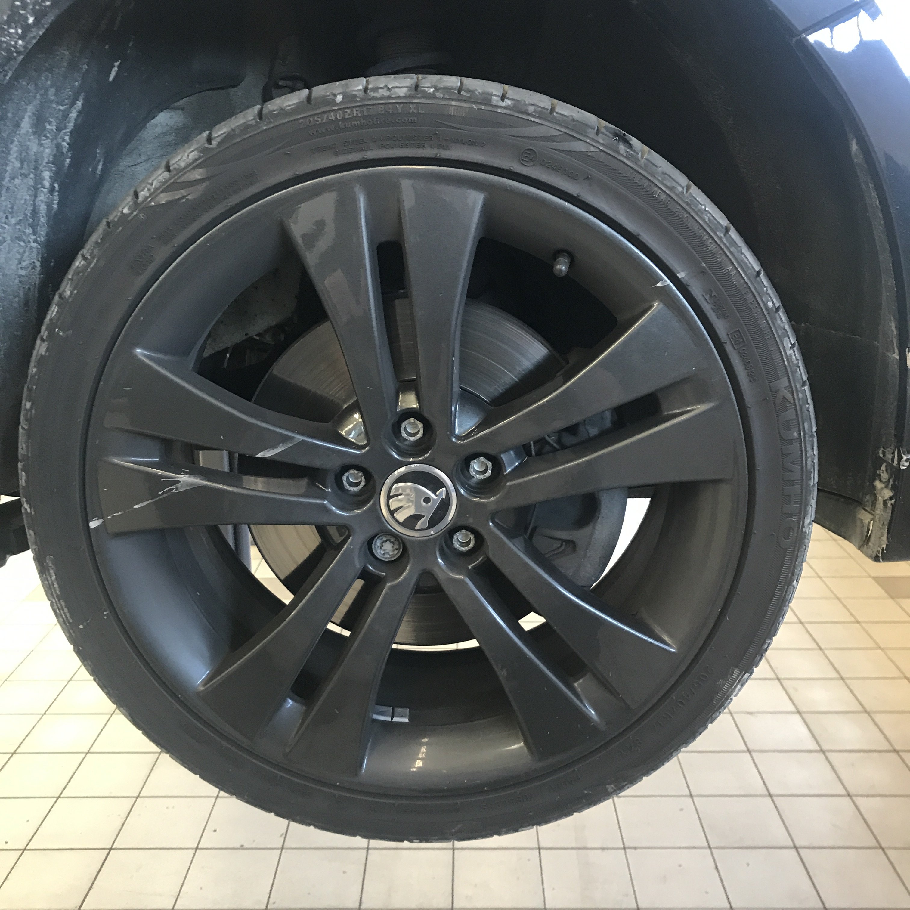

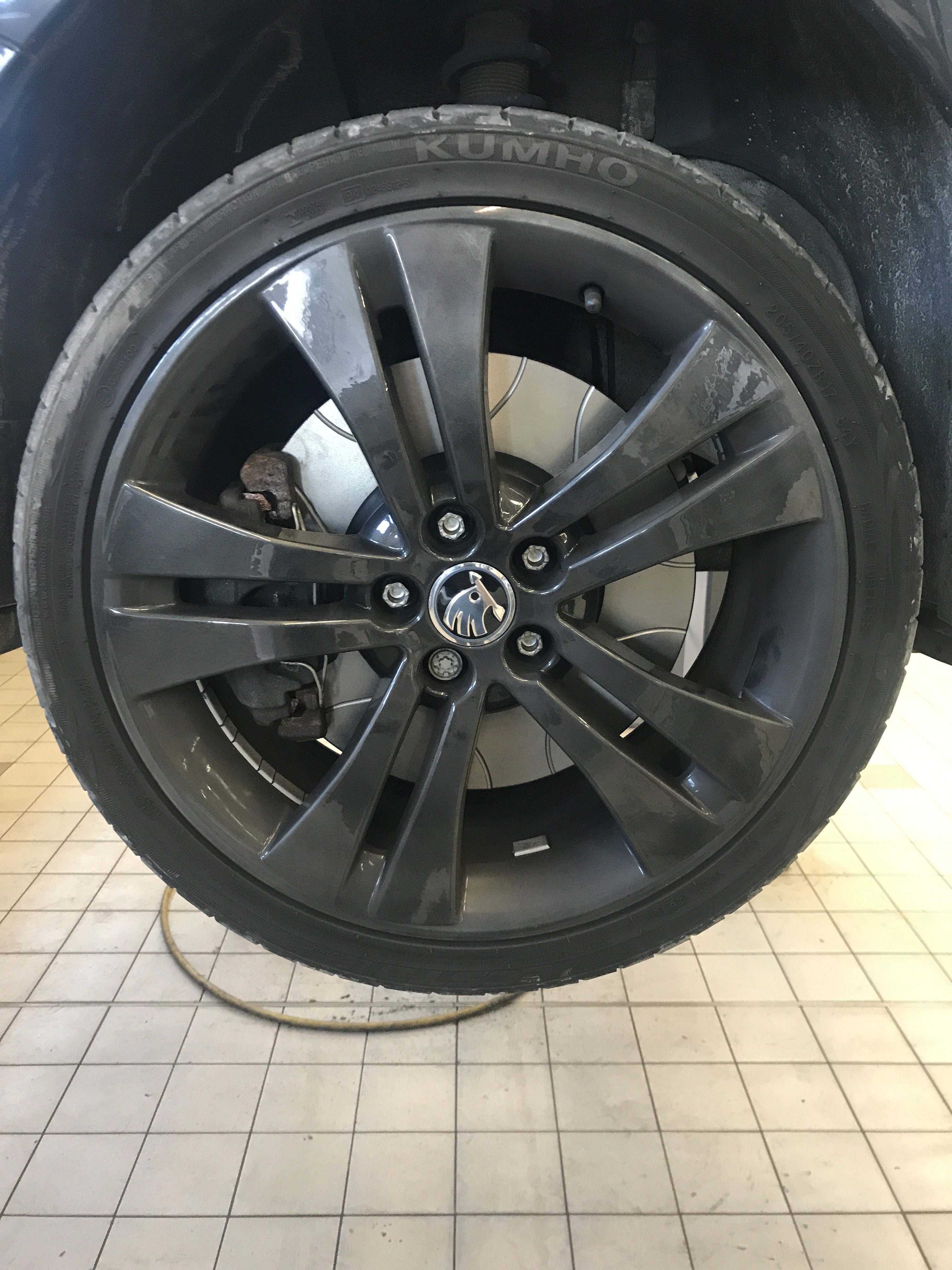

Finally got some 312mm carriers and test fit was good. Got pads and awaiting discs, should be on sometime next week :)
Well they finally arrived and to confirm the spring retaining clips are different thank god I have VW and audi next door. I had to run between garages at half 5 tonight !!
But all fitted and working :)

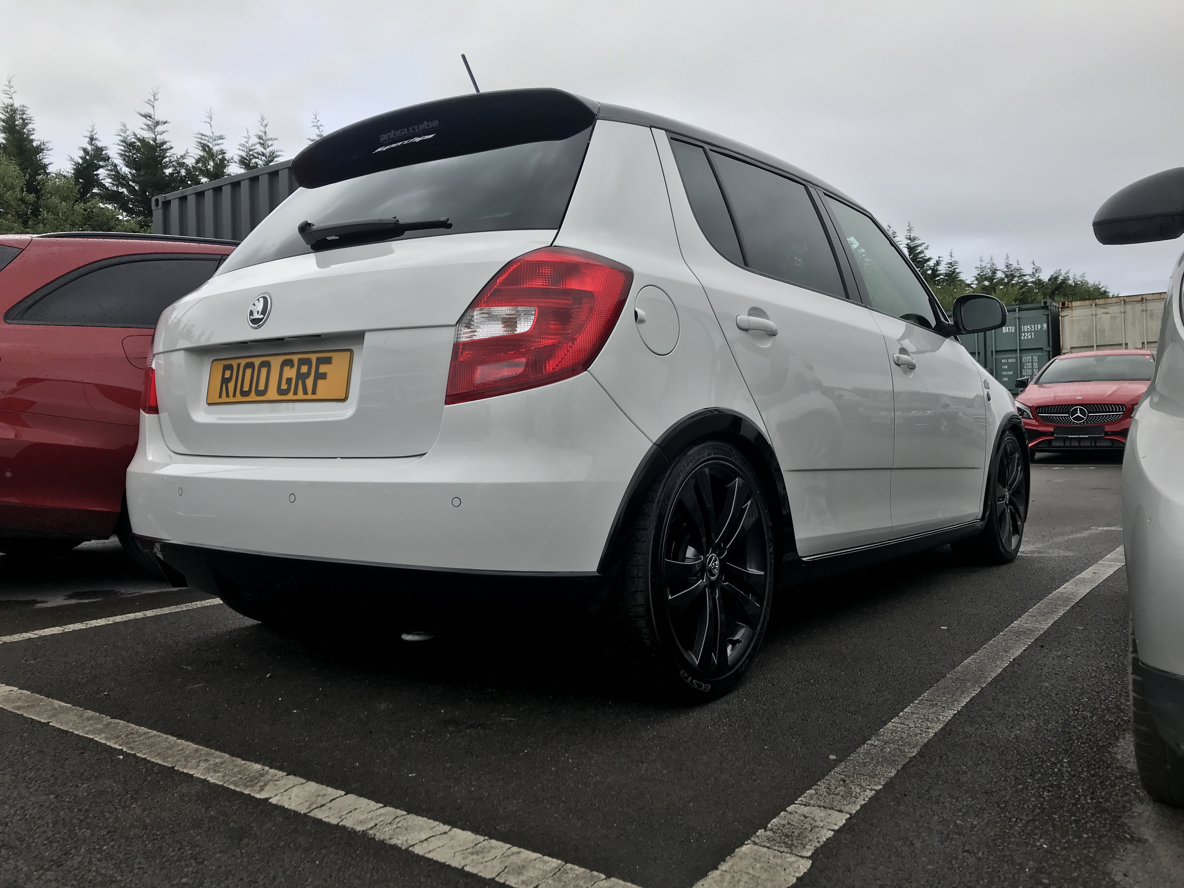

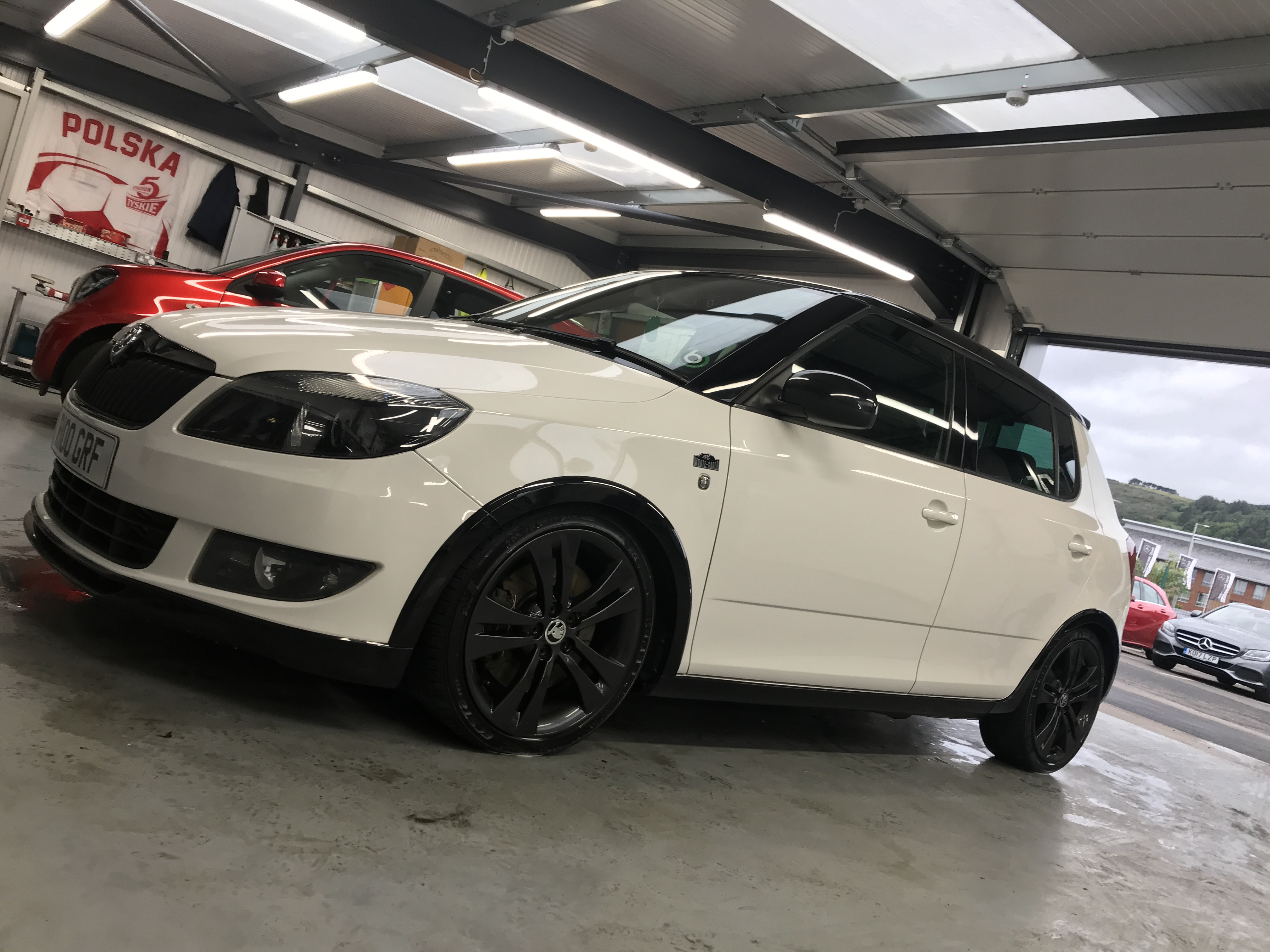

May have been a few more mods since last year even though I had none planned. Short shifter fitted, egr deleted at exhaust manifold now too.
Trying to keep the car as clean as I can :)

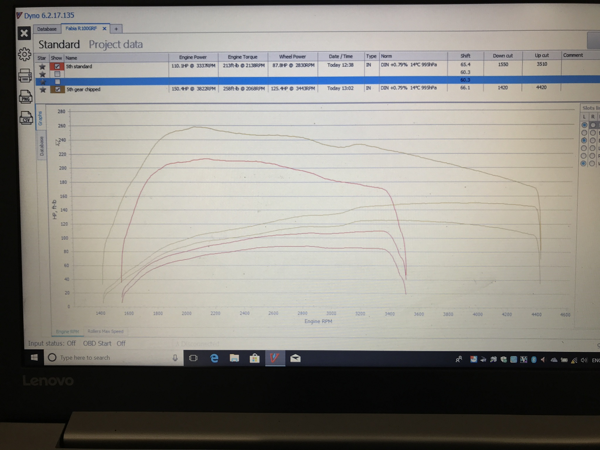

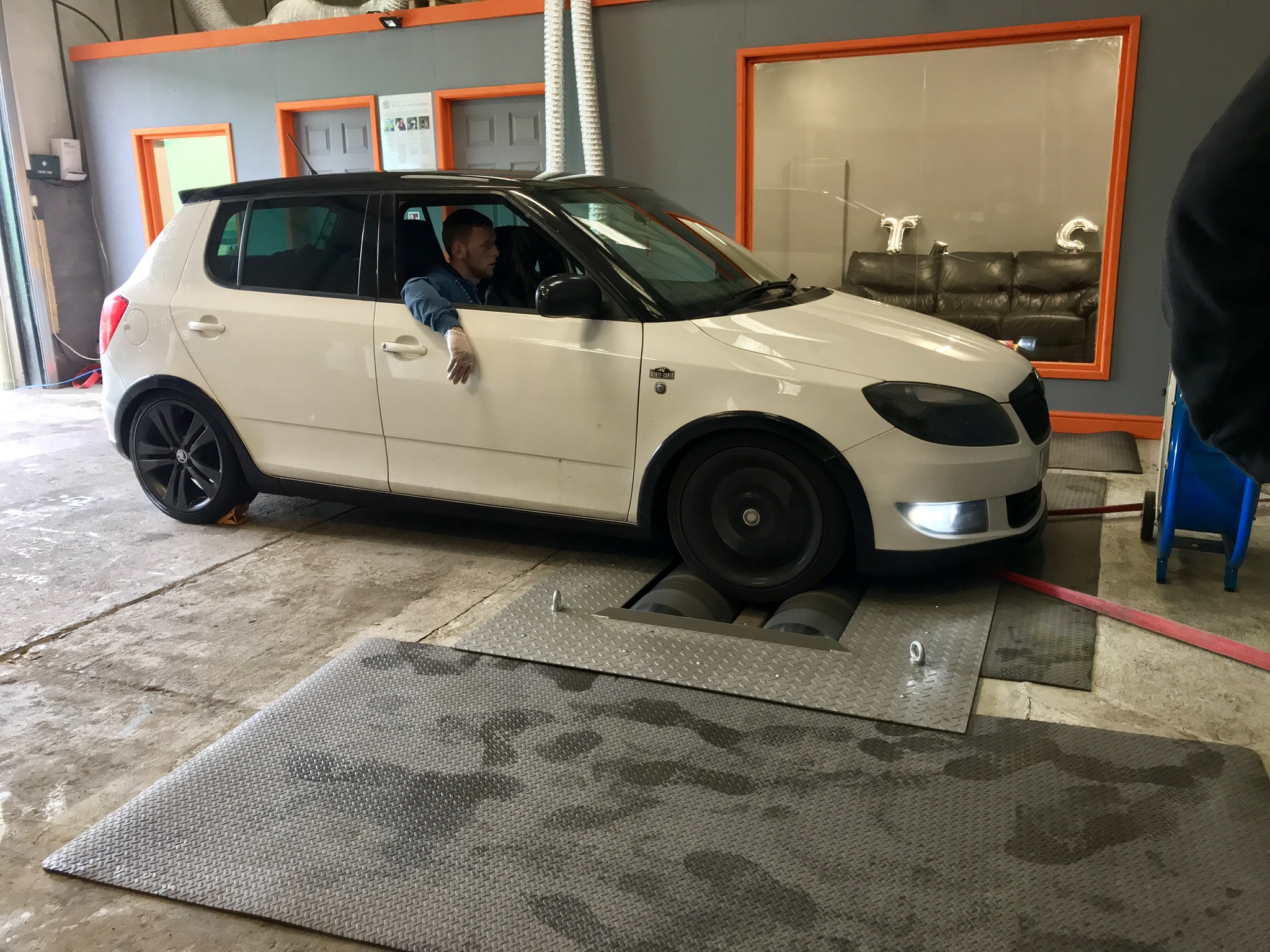

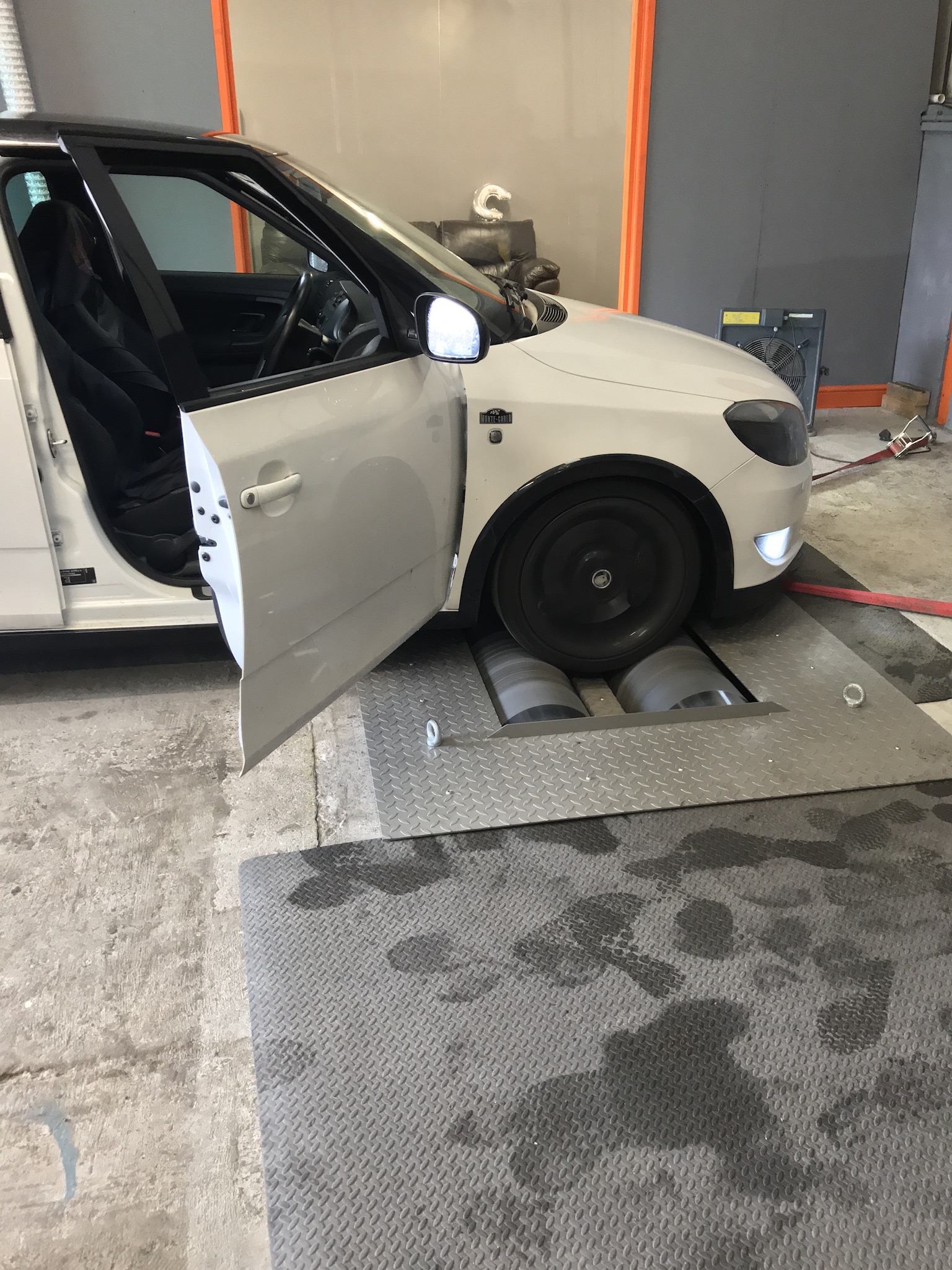

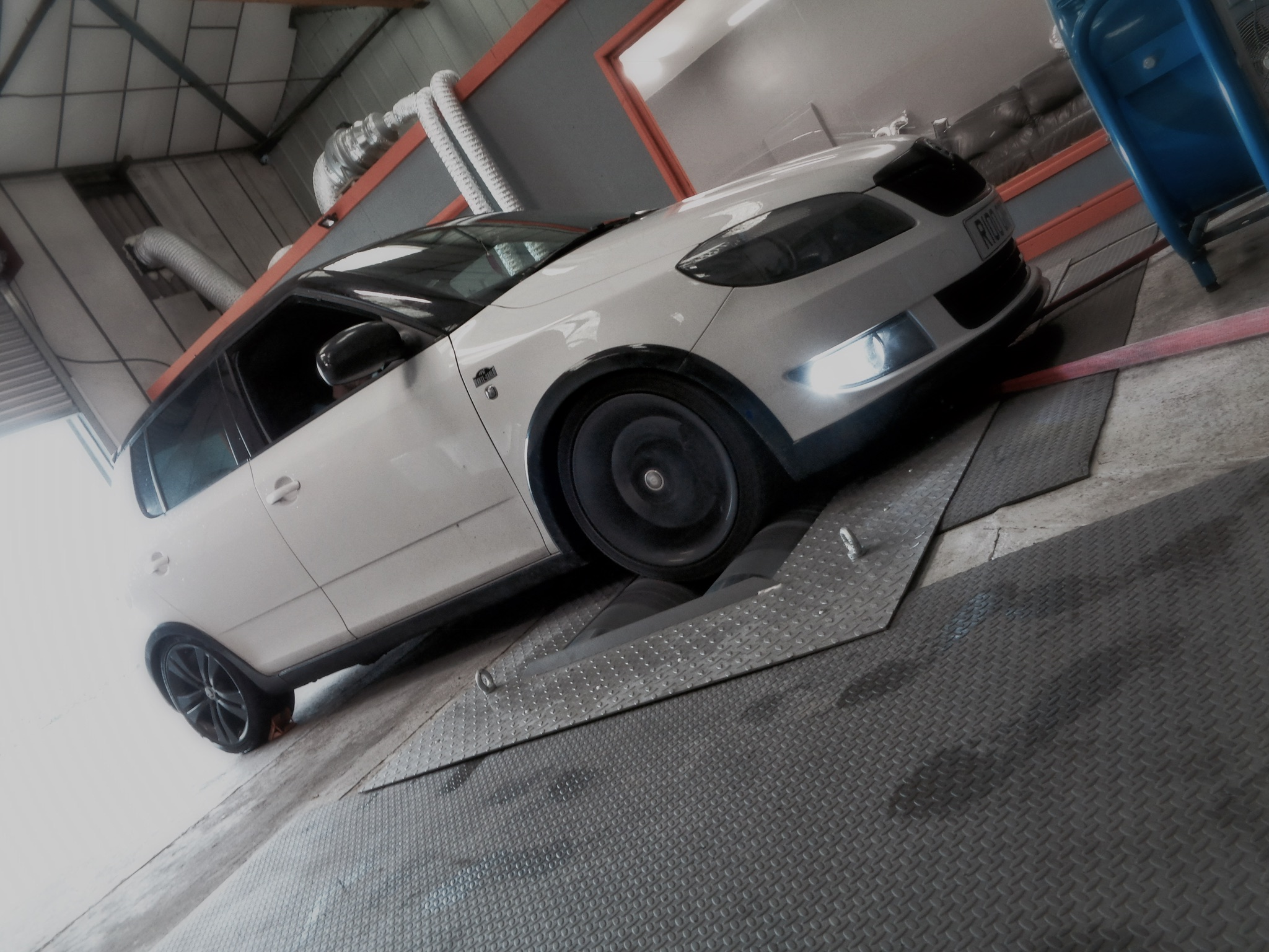

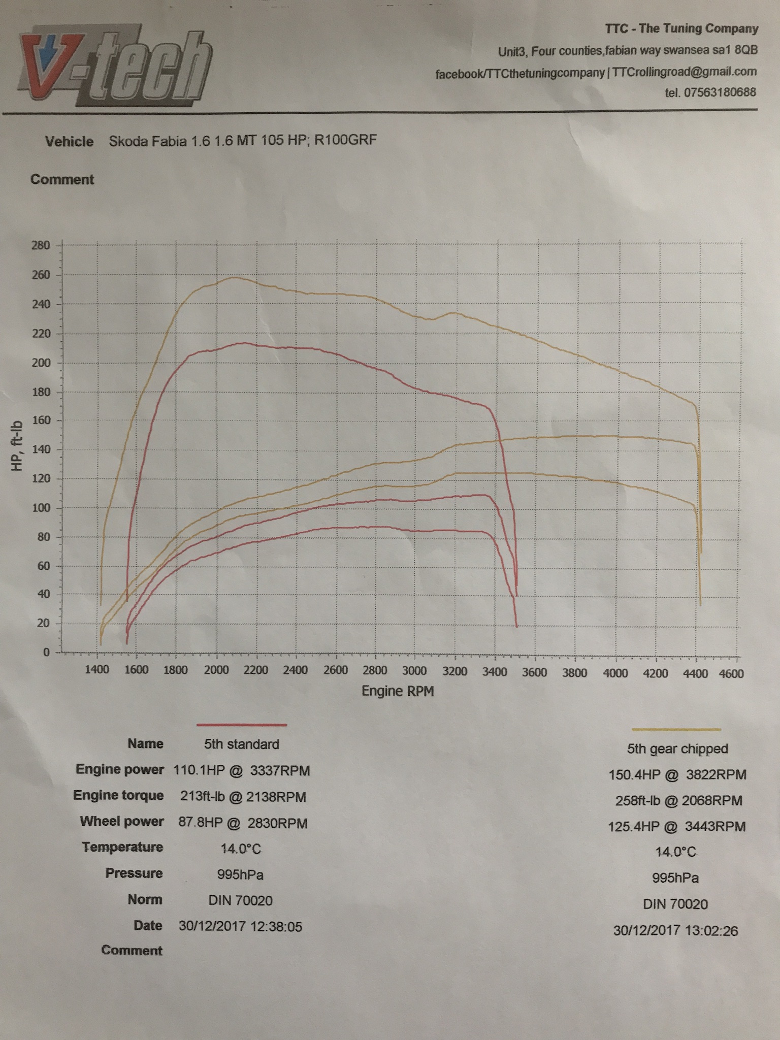

Dyno Day earlier this year.

What's happening at 3200? looks abit strange? clutch slip?

No idea actually, don’t notice it on the road could be dodgy moment on dyno.

Could be also notice that it says 5th gear? if it was a 5th gear pull thats when the speed limiter would kick in so wondering if its something to do with that then it overrides it.

Had the speed limiter removed by Superchips, could possibly be that.
Definetly does more than 118 mph now :)  As I bet yours does well beyond that
