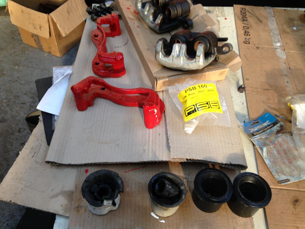

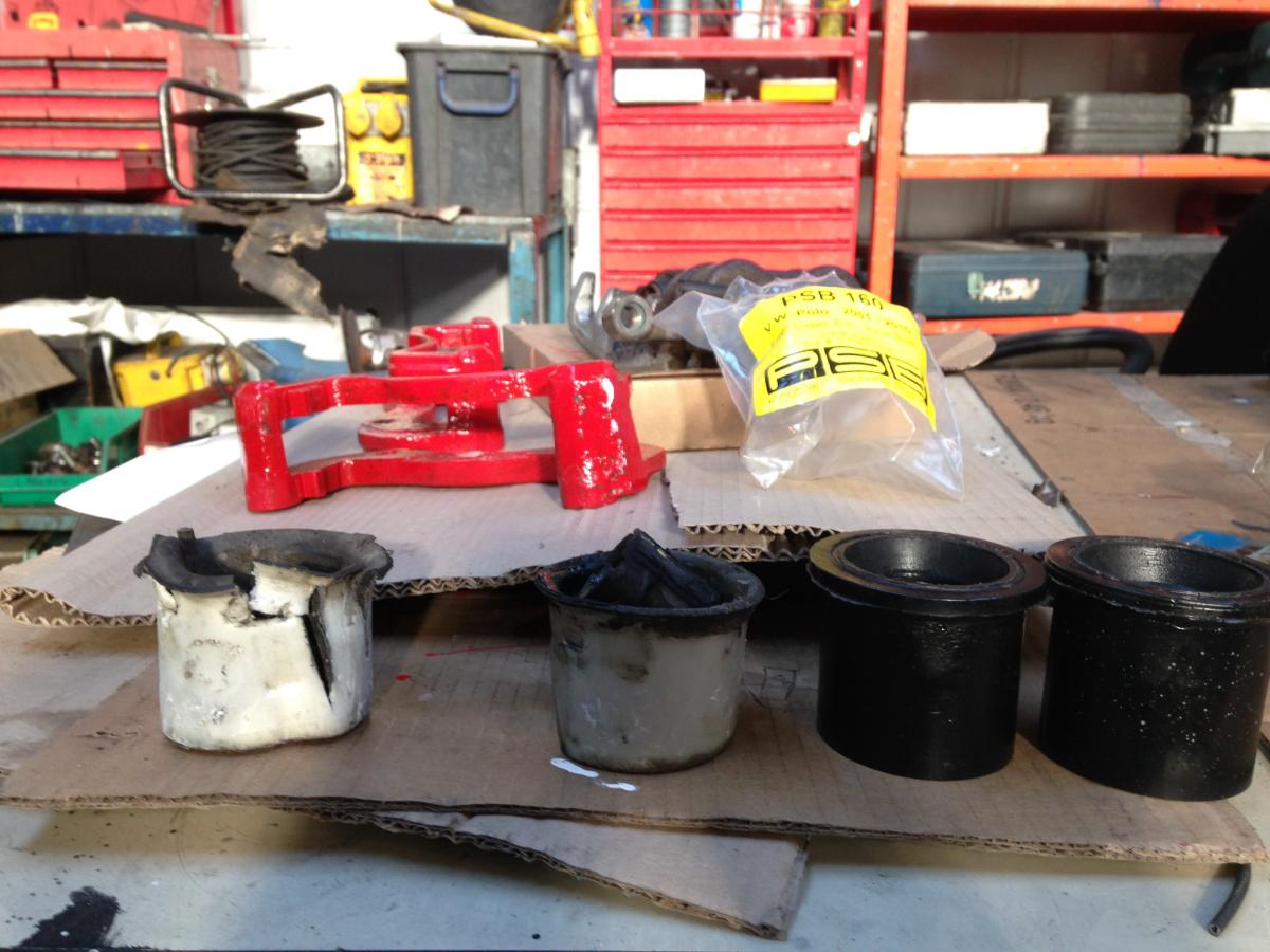

Hee's a couple of pics of them sat next to the oem's. Sorry but the camera on my Iphone is not always the best.

Just check ive got the right part there, is that labled - Front Lower Arm Rear Bush ?
I believe it's Front arm rear bush also known as the console bush.
Can't say if i've noticed a massive difference in harshness or road noise as I have firmer suspension anyway. They are naturally going to be harsher as that is what they are intended to be it also means that they are going to be harder wearing which is not a bad thing. I guess it's down to personal preference.
Poly bush types (2 part ones) are easy to fit, the OEM ones require a tool to fit. I've fitted both, went back to OEM (the new uprated ones) after trying PSB and finding them harsh.
If you're after ease of fitting, and don't mind harder ride go with poly. Otherwise buy or make a tool (I made mine) and fit the standard (uprated) ones.
