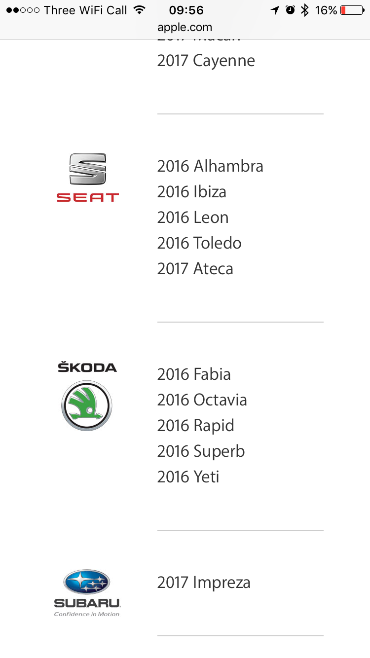

Hmm... any updates? Apple say it works with the yeti

Apple carplay should work on a Yeti fitted with a MIB2 headunit that's had smartlink activated: http://www.skoda.co.uk/about-us/mirrorlink-faqs
This only applies to the cars built after 25 May 2015, if your yeti is older, it won't work.

As has been said, not a Skoda issue. Mirrorlink does not support iOS:
Are iPhones compatible with MirrorLink?
Unfortunately not, iPhones are only compatible with SmartLink. SmartLink includes within it MirrorLink, Apple CarPlay (compatible with iPhones 5, 5c, 5s, 6 and 6 Plus) and Android Auto.
http://www.skoda.co.uk/about-us/mirrorlink-faqs/default/?gclid=Cj0KEQjwzd3GBRDks7SYuNHi3JEBEiQAIm6EIwJO4IV14_eMgahy1ykM-Qx28FRy1rZHzirva1j0anUaAjUk8P8HAQ
Skoda's Smartlink does support Android Auto and Mirrorlink (on some android phones) plus Apple's CarPlay.
