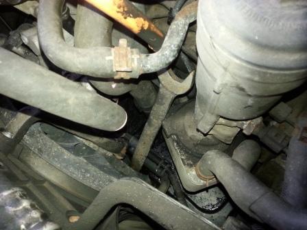

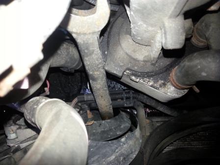

Right guys I had my 2005 VRS into a local garage 2 weeks ago getting new track rod ends and my back discs and pads done. The next day my coolant light came on, I checked the header tank and sure enough the level was way down.I topped it up and continued my drive to work about 30 miles each way. The next morning the coolant light was on again  I thought this was strange so started looking around for a leak, I found a ruddy great big spanner through my fan and stuck in my radiator. I went straight down to the garage and they agreed to fit a new radiator free of charge. I gets the car back 2 days later and the next day the coolant light is on again, I take it back to the garage who keep it for another day and tell me it is fixed. I drive to work the next day and the coolant light comes on on the way home, I take it back to the garage and they have it for another day before calling to say the cylinder head gasket has gone due to the coolant and spanner scenario. They have agreed to fix the car at their cost but I am a bit wary, they have had it since last Wednesday and still no call to say it is fixed. Will it be ok once I get it back? It has a stage 1 map on it, will the power be affected? I love my car and have had it for nearly 4 years. has anybody else had their head gasket done and was the car the same after it?
