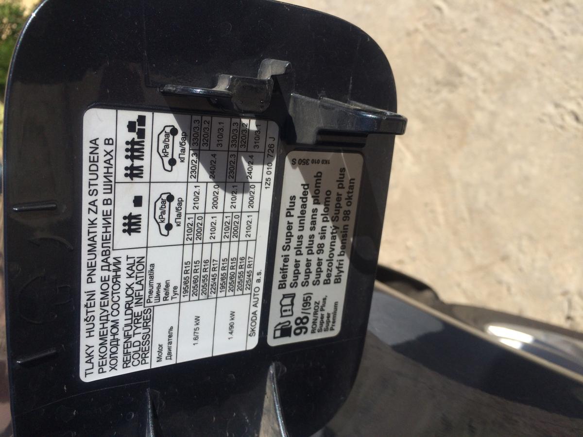

I think its official (pic below) all i want is the more comfortable tire
