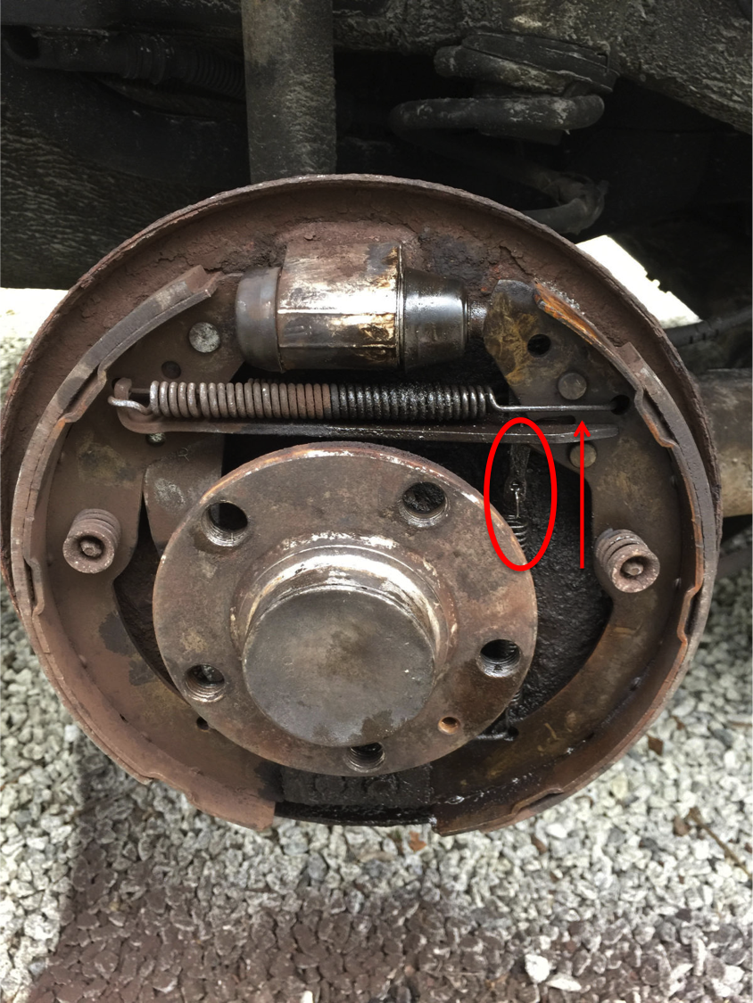

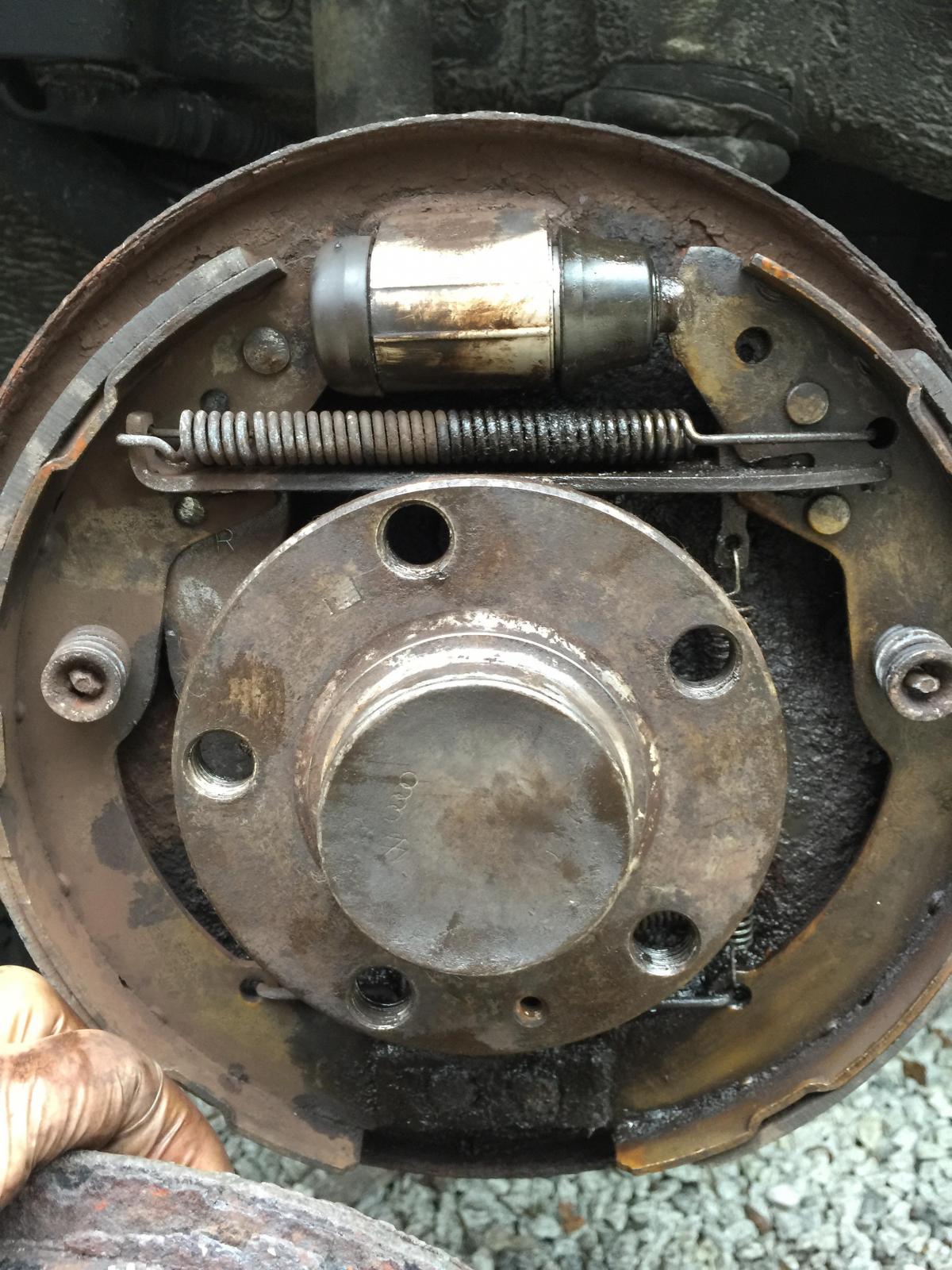

My first post here and I hope I can find some help. So, I did something silly and decided to "troubleshoot" some problems I was having (or thought I was having) with the rear passenger brake. I felt like the brake was "sticking" or not functioning properly, and after driving I could smell burning/brake fluid. This is on a 2002 skoda octavia. My first skoda experience.
So, with little mechanical experience I decided to pop off the tire and take a look at the drum brakes. Took some finessing but I was able to pop off the drum and the brakes initially looked like the first picture. I had my girlfriend sit in the car and pull the emergency brake so I could see whats going on inside the drum brakes... but then she pressed the brake pedal in without the drum on. So the piston popped out and leaked some fluid. I assembled the piston again with the spring that popped out.
I'm just trying to get the drum back, but it seems to be getting stuck on one of the shoes maybe? No amount of work can get the drum to snuggle up to the backing plate. See picture 1 for the initial state when I pulled the drum off, and picture 2 for the current state where I cant get the drum back on....
Anyone have any thoughts on how to get this all back together so I can drive it over to the mechanic and admit my defeat? Also, with the piston popping out like that, should I be worried about significant damages to the system?
Many thanks...
before:
after:
In the bottom pic which is clearer the adjustment mechanism needs to be pushed up. This is the vertical wedge to the right of hub in pic. It has a soft spring attached. As the shoes wear the spring pulls the wedge down thus expanding shoes to meet inside of drum surface. Your girlfriend by pressing the foot brake without drum fitted has expanded the shoes to the maximum limit. Simply lever wedge back up to the top and shoes will be retracted. You may also have a lip on the drums that can make them difficult to refit. But you will never get drums back on with wedge in position shown. Piston popping out will require brakes to be bled as you will now have air in system. But as long as piston was cleaned before re assembly all will be ok once brakes are bled. Also you need to get some brake cleaner and clean all the rusty dust out.Hope this helps.

Ok.. so I push up the vertical metal bar with the spring hooked up to it.. on the right side, and this should squeeze the shoes together. I can try that.

Anyways, still wrestling trying to get the drum back on. I've levered the "wedge" up and the drum gets on to a certain point before its getting stuck.. Pictures show the current state of the shoes and the little bit of space left when I try to get the drum back on... Am I just at a point where I need to line up the holes as best as possible and screw it all back together? Is this rust causing the issue not allowing the drum to seat flush with the backplate? It feels like there is something in the brake assembly in the upper right quadrant pushing on the drum.

It all seems to be hanging in place. It's a bit concerning that the right side of the piston seems to not be sticking in there very securely... but what is the best bet to just get this thing together and down the road to the mechanic, avoiding putting it on a flatbed tow... I don't even want to think about what it costs to tow a car where I am living...
Also, to clarify, this is the wedge that needs to be levered up in the direction of the arrow in the picture? Seems like it moves quite easily up, stretching the spring, but little movement in the shoe.
Yep that's the wedge adjuster. Once pushed up shoes should retract. From your pic the R/H shoe is not retracting. It should push the piston back into the wheel cylinder much more.
I got it all back together. I think the issue is a busted wheel cylinder. I feel the piston on the righthand side of the image is busted. It seems to be too loose, or just sitting in there and the force of the spring could cause it to pop out unless there is some force pushing up against it. My guess is it needs to be replaced, amongst other issues. I hope once I get some fluid to top off the reservoir I can pump the brakes a few times to see if pressure builds up and then get it to a mechanic... the wheel is abnormally difficult to rotate, so there is still some issue with the brake seizing up against the wheel. Not sure why.

1) The right rear wheel cylinder is not aligned on the brake shoe. I can't really seem to easily reposition the brake shoe so it rests on the metal part of the piston. Is this something achieved by removing the brake shoes and reinstalling them? Or just a matter of loosening up some springs and adjusting into place? Alignment looks ok on the other side of the cylinder. Pictures 1 and 2 for reference.
2) I am not familiar enough with brake wear and tear, but what are some opinions on the state of the shoes and brake drums. The drums seem to have some grooves and there seems to be wear on the brake shoes from the irregularities on the drums... Pictures 3 and 4 for reference.

The brake shoe needs to be positioned on the wheel cylinder piston by removing the hold down spring (not the return spring) and carefully positioning the shoe on the cylinder using a pair of pliers.
At the moment, the way the photo shows the brakes at the moment, only one side of the cylinder will work as designed, as the other side is resting off the cylinder and may allow the piston to pop out under braking.
Looking at the photos, unless they are really exaggerating the wear, the shoes and drums appear to be near or even past their service limit due to the heavy grooving.
